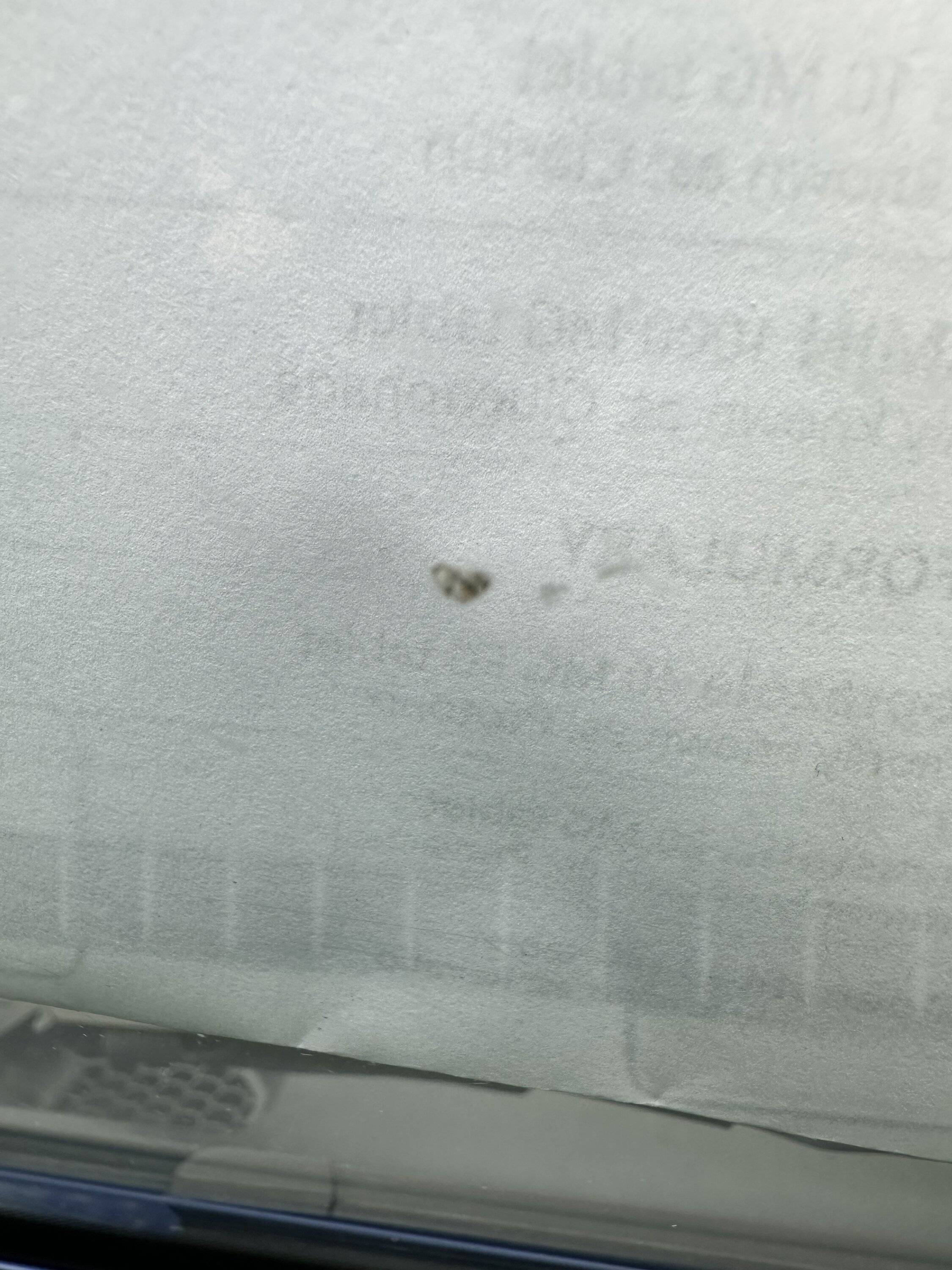

my vote is and slways has been racing optics: I'm on my last layer of 3 & just waiting for things to warm up a bit for putting my new one on. I know for a fact that Iv'e taken several rocks that would have absolutely obliterated my windshield..but only put small dings or nicks in the film (my latest rock, this past weekend, actually hit with such force that it literally pulled the film of fthe windshield for a brief moment..thought for sure my window was toast, but NO!, it's still in one piece. r/o has a forum discount, so the price is pretty good & I'll NEVER run without it on my windshield
not a very good picture, but this was latest attack by a rock:
Jeep Wrangler JL Windshield protection E78CEA5E-2277-499B-A395-46102AADBD42

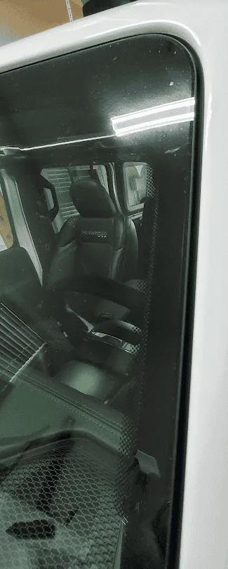

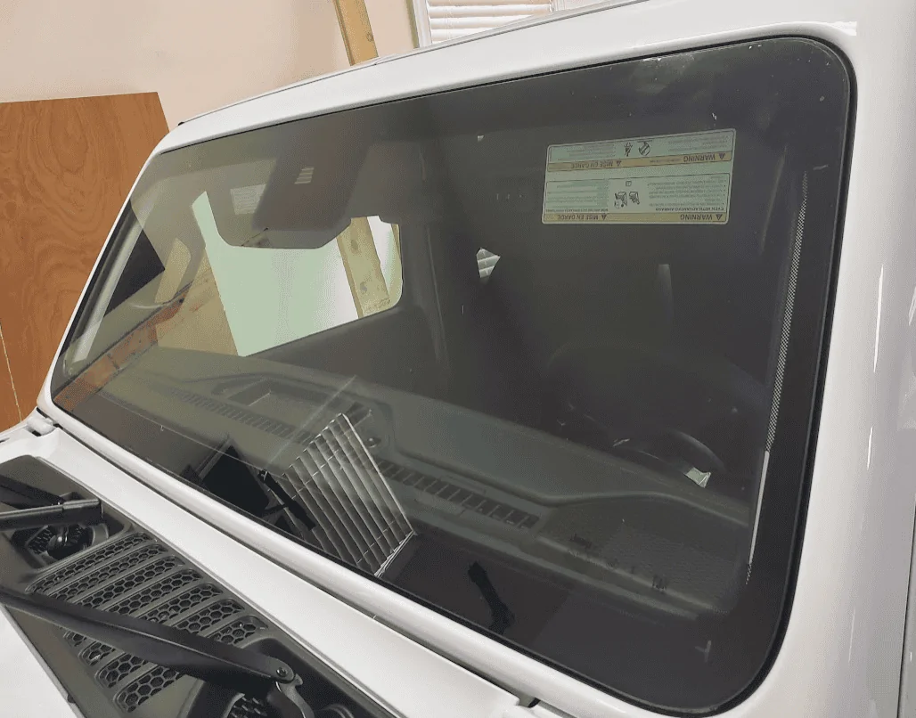

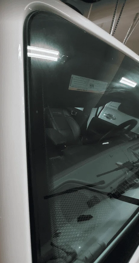

I put mine on today by myself. Not easy, but not super hard either. Hardest part is peeling the backing off and getting it on the window causing any creases or touching anything else that would leave marks. I ended up laying it down on the hood, peeling 1/2 way, spraying with soap solution, peeling the remaining/spraying, getting in the jeep (freedom panels off) and putting it on the windshield. Fitment was very good, few millimeters here and there between the edge of glass and film. Use lots of solution to get it sliding easy for fitment. Dust is the enemy. I have ~4-5 little dust spots that make small visible bumps, but its not too bad. I didn't push as hard on the squeegee as they show in the video as I had to hold the film in place. Perhaps that would have made a difference, pushed the dust out.
Getting the film on squeegeeing in place is pretty easy since the jeep window has no curves. I didn't have any edge issues or need the heat gun.
Hopefully this ends up cheaper than a new window.
UPDATE: Found a few little areas that needed some more squeegee. Fixed them up a little, but moral is squeegee a lot to get all the little bubbles. I'd do it in more light, but I suppose that is a catch 22. Perhaps do it in the garage away from as much dust as possible and after its on pretty good back out into the sun and squeegee some more where you can see really good. The squeegee that comes with the kit is pretty good. I'd get the kit the first time you do this.
Jeep Wrangler JL Windshield protection on
Jeep Wrangler JL Windshield protection two
Jeep Wrangler JL Windshield protection thr
