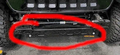

I never looked at a Rubicon with steel bumpers that closely, and I'm not sure how the parts underneath differ, if they differ at all. My Willys came stock with a plastic bumper, a plastic splash guard, and a very thin piece of metal that had been embossed with indentations to impart additional strength. That small, thin metal was the only protection the Jeep had from the factory. Here is a picture.

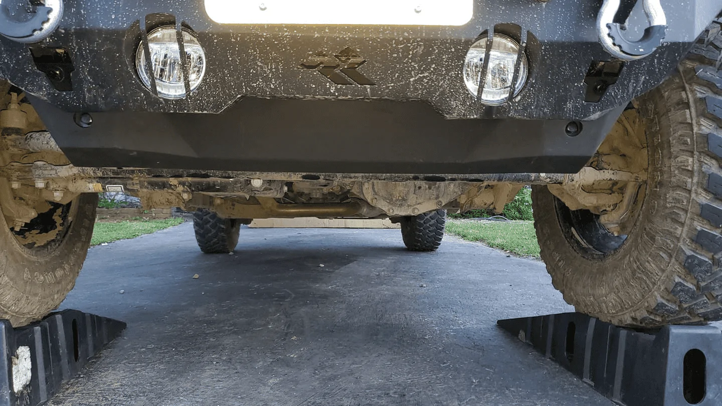

Pretty much the sky is the limit on aftermarket bumper options. Everything should work. Most bumpers I looked at offer a skid plate as an option. The skid plate is usually specific to a particular manufacturer, and typically covers a range of their bumper offerings.
I ended up going the Rugged Ridge HD route, and I added the skid plate. I replaced the original stamped metal thing with a pretty good hunk of steel down there. Installation was a PITA.

I would add that if I hadn't made the bumper choice I did when I was just starting out in Jeep world, I would probably be running on 37s right now. My Rugged Ridge HD full width front bumper is known to cause issues with 37s. If you look at it, you can see why. It blends really nicely into the factory fender flares, but it has pointy, backward-pointing bits right where the big tires would want to go. I'm basically limited to 35s unless I take a Sawzall to this bumper.
I mean 35s are good. Lighter. Less likely to destroy stock axles and hubs and whatnot. But it cheeses me that I can't go to 37s because of that damn full width bumper.
My point is that if you don't think this disease is going to afflict you, you're probably wrong. One day, you will want to put 48s on your Jeep like a real man, and you should probably plan accordingly as you build. :CWL:
