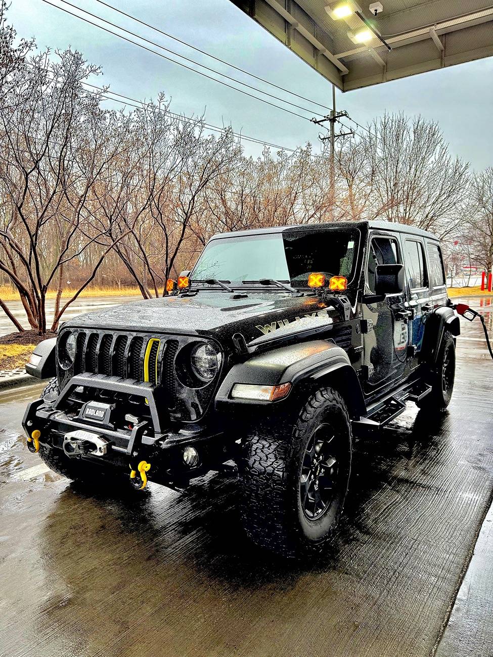

This what i have for winch and bumper set up, and i will eventually do a 2.5 AEV lift on it before the end of the year!

I have 285/75 Ko2s on stock rims with 1.75" spacers (stock bumpers, no winch), 2020 Willys Ecodisel.
Per https://tiresize.com/wheel-offset-calculator/ yours are going to be 0.45" further away from frame/suspension, everything else the same.
I had rear tire rubbing *without* swaybar disconnected... changing fender flares soon.
