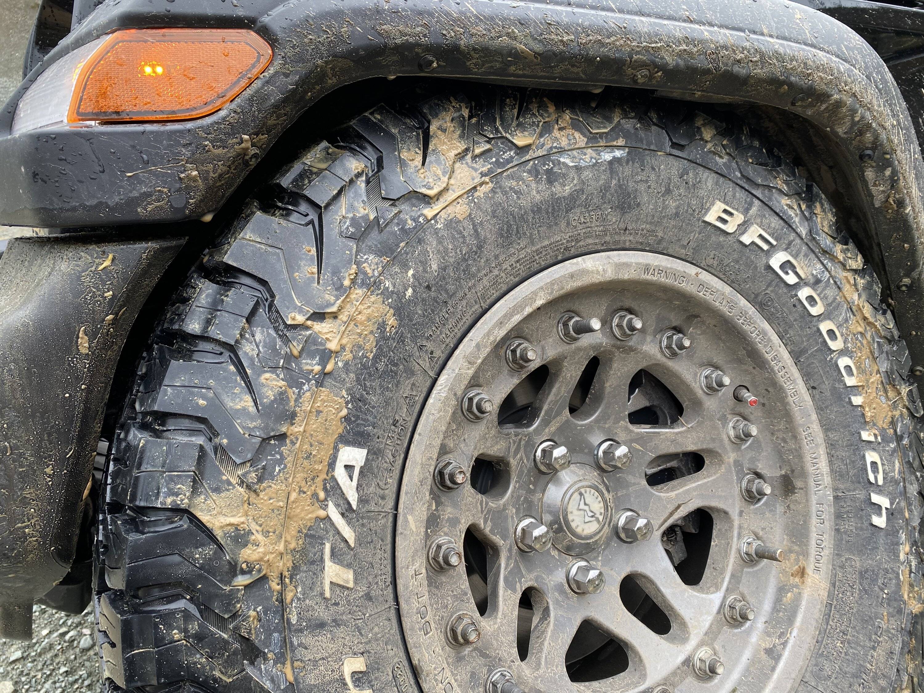

However, the further out you push the tires the more your fenders, bumper, etc becomes a concern. Example:
Jeep Wrangler JL Will my tires rub? EEAD1916-FE8E-4B76-83EE-FA7C8CE52E66
Less backspacing or wider axles and I’ll contact my low-clearance sport fender.
As for 4.5”, I believe that guarantees metalcloak won’t rub on any axle. You can get away with less if you have Rubicon width axles. @Roky is the person I’d defer to for Rock Krawler setups. A quick look seems they quote 3.5 and 4.5. 3.5” BS would be 37” tires on narrow axles. I think this is unique to RK due to the control arms being bent for ground clearance instead of tire clearance.
Edit: 4.5” and less should not rub.
