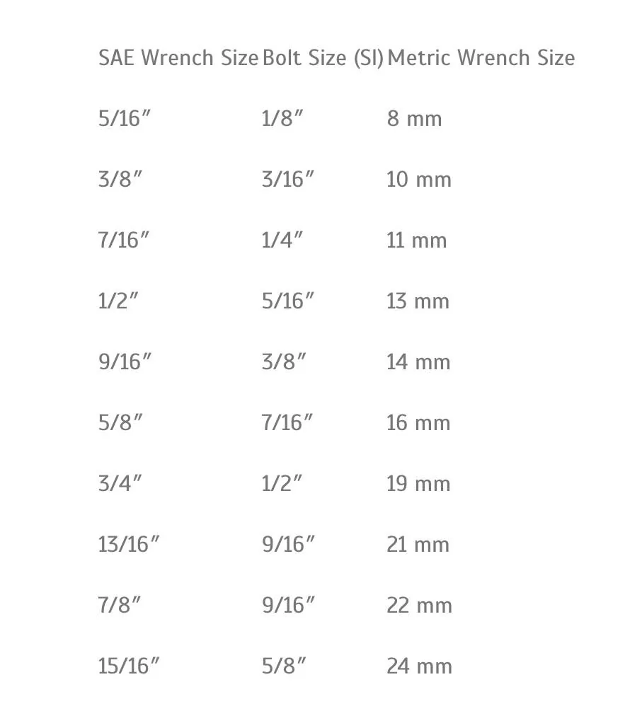

Aside from a select few sizes (10mm) you can use metric sockets on sae bolts. I carry metric impact sockets and a standard wrench roll with a few pieces added. A 1/2" bolt for instance would be a 3/4" sae socket. 18mm is too small, 19mm works like a charm even when torqued to spec. You don't need 2 compete sets by any means.
