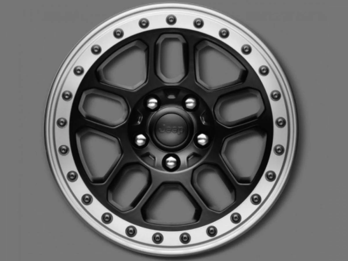

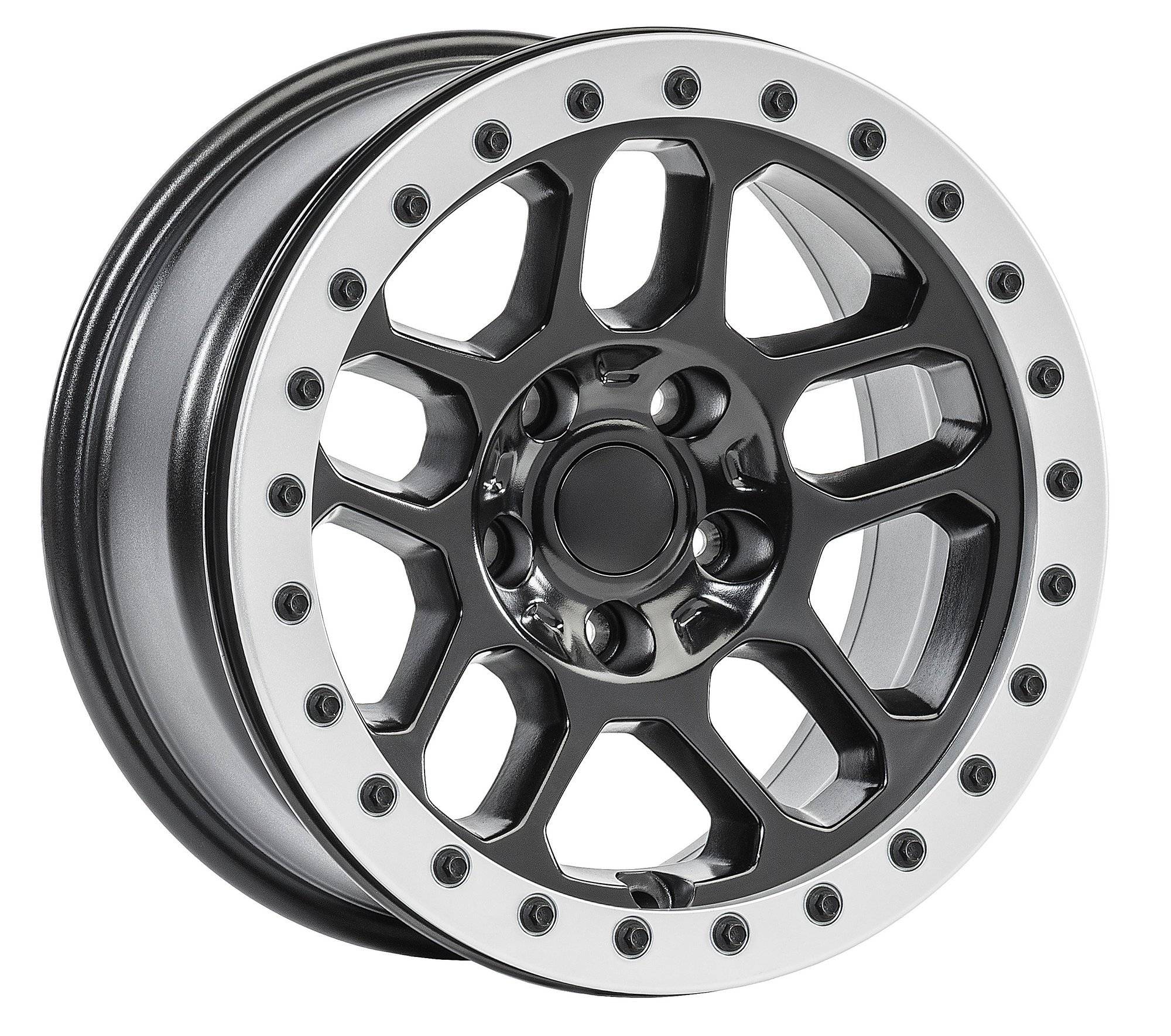

I"m sure this is a dumb question, but here goes. When using the bead locks, does this make the wheel wider than the OEM 8" bead lock capable wheel. I've not seen bead locks up close not sure how they work. Any 37" tire work on these wheels? I've got a Rubicon Extreme Recon on order, want to order the bead locks soon to be ready.
It makes the wheel 8.5” in true beadlock configuration. Check with your tire manufacturer, some like a 9” and some are okay with an 8.5”

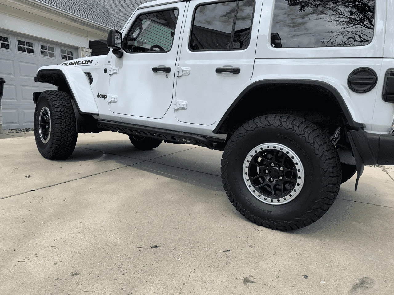

I got them with the true Beadlock for almost three years now. They are good on the road (good balancing required) and super sturdy and reliable off-road. Plus, I love the OEM look..
Awesome look! I'm looking to get one set of these Mopar wheels. Can you please tell me what offset do your wheels have? Do you use backspacers? And are they off the fenders? Thanks!
