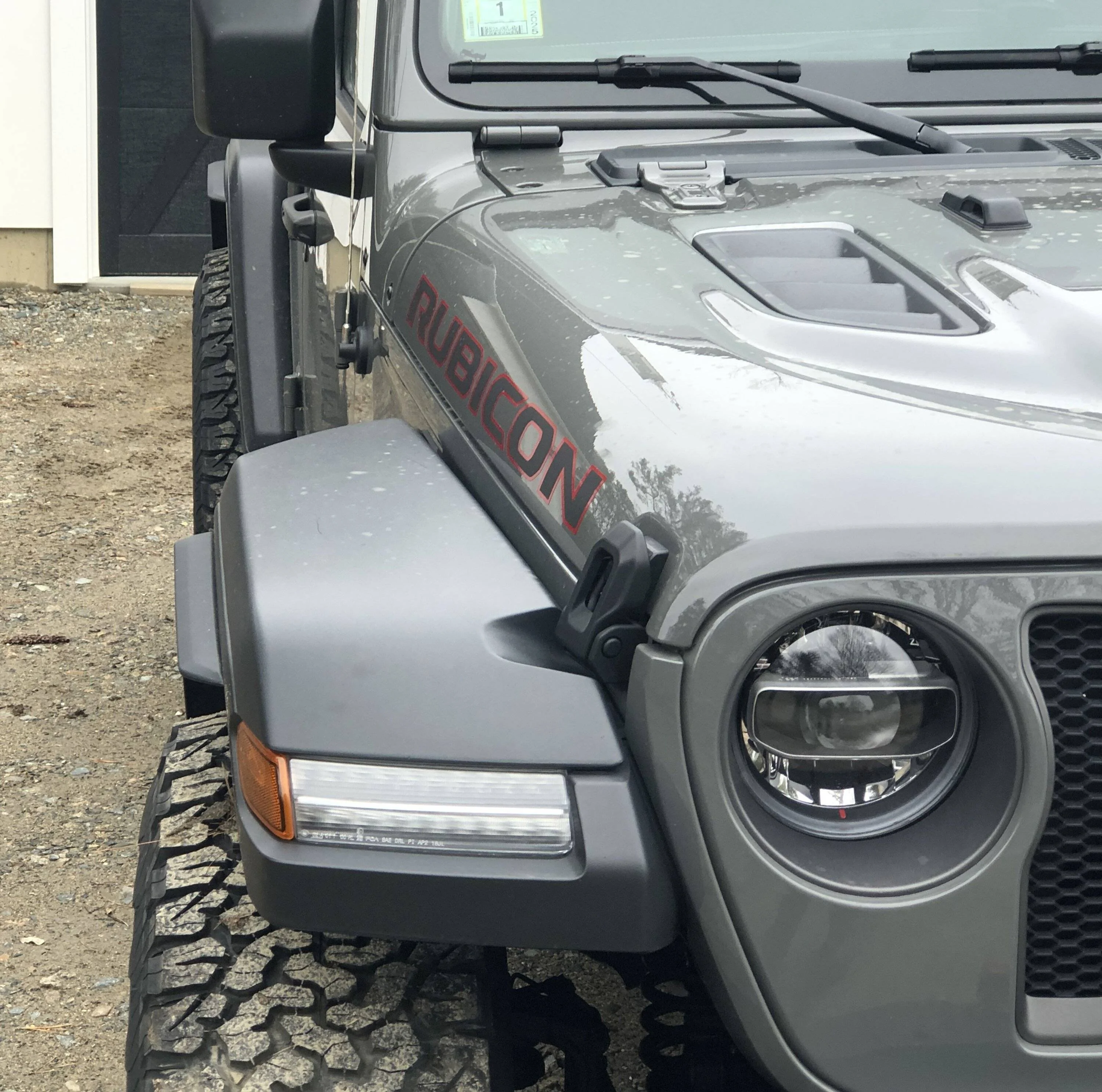

This is a Rubicon with Method 703s in 17x9 -12 Offset (4.8 backspace)
Jeep Wrangler JL Wheels IMG_1787
