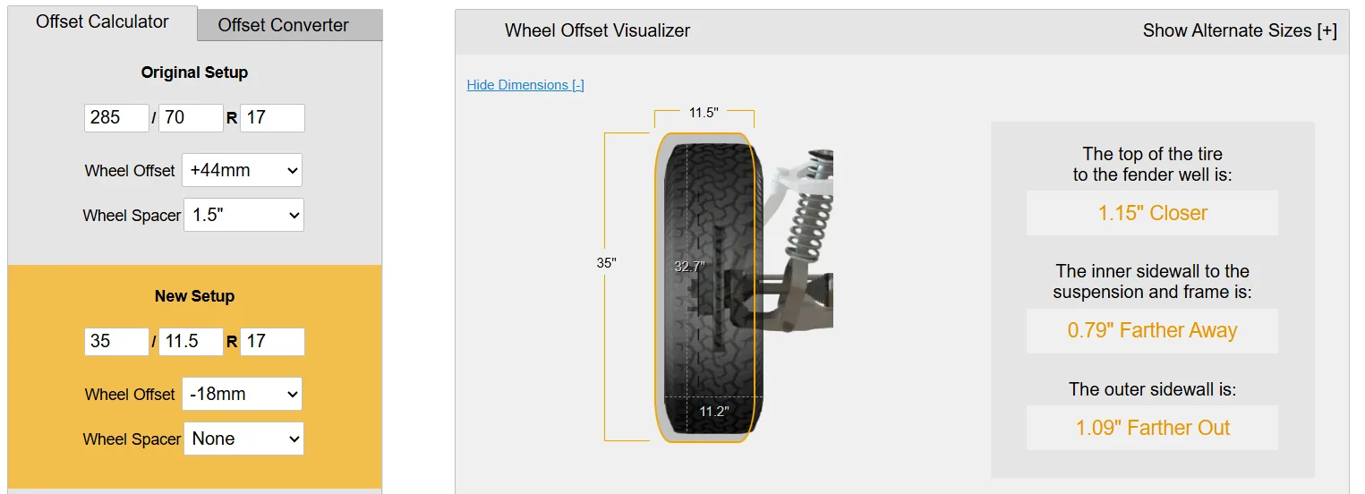

A little help here, I have analysis to paralysis! Looking at new tires and wheels. I currently have stock wheels with (1.5" wheel spacers) and tires (285/70r 17) on my 2023 2dr. JL Rubicon. Stock wheels are 7.5w and have +44.5 offset. I want a 35x11.5 tire and I am looking at a wheel with a -18mm offset. I know the tire will be taller but will the offset be about the same without the wheel spacers? I like the way it is now, just want a taller tire on new wheels.

1.5" = 38 mm
So your current offset equivalent is +6.5mm, the -18mm offset wheels will push the assembly out just under an inch.

you would poke out about an inch more with the new set up
