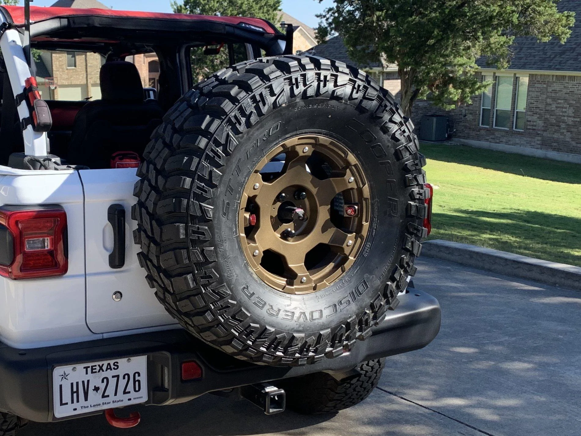

I had the same dilemma and decided on the 13.5 width. Ironically the 13.5 were a little cheaper than the 12.5 too. I have not installed my lift so haven’t mounted wheels yet but did test fit spare on my new Evo carrier. Here’s a pic on the 8.5” wide Teraflex wheel to give you an idea of the look.

If they have the wheels you like, or another that's similar in a 9 or 9.5 width that would be best, but if not, the 8.5 won't create any problems, but I'd be more apt to chalk test w/ that setup.

They’ll look “untucked” but not crazy. I think it gives the Jeep a little more aggressive and planted stance. As far as rubbing it’s hard to say. With factory control arms it’s possible you could have some rubbing at full lock but nothing that would cause damage. At the rear you will probably want to remove the lower plastic liner and use a heat gun to reshape the bulge at the back too.
