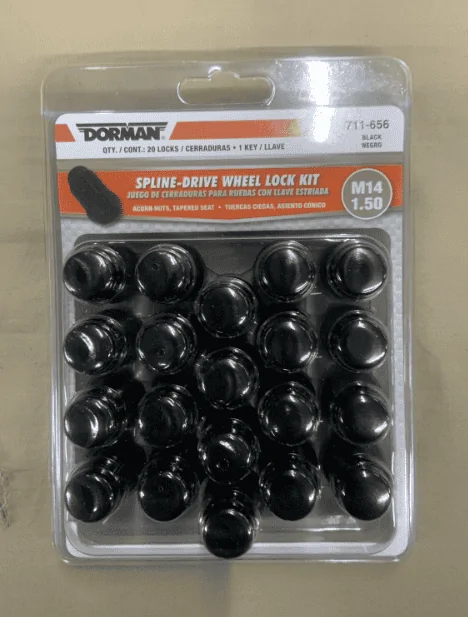

As a temporary measure I would pick up a set of lug nuts from your local parts store. That will at least give you time to source the matching ones. I don’t know if it technically matters but I would swap out all of the lug nuts on that wheel while you are waiting for the matching ones to arrive and not mix them.
I said hell with it and just got these. I'm not paying anywhere from $10 - $18 for a single OEM Jeep hex nut when I can get a set of 20 locking nuts with the spline tool for $40.
Those should work so long as they’re a 60° taper.
