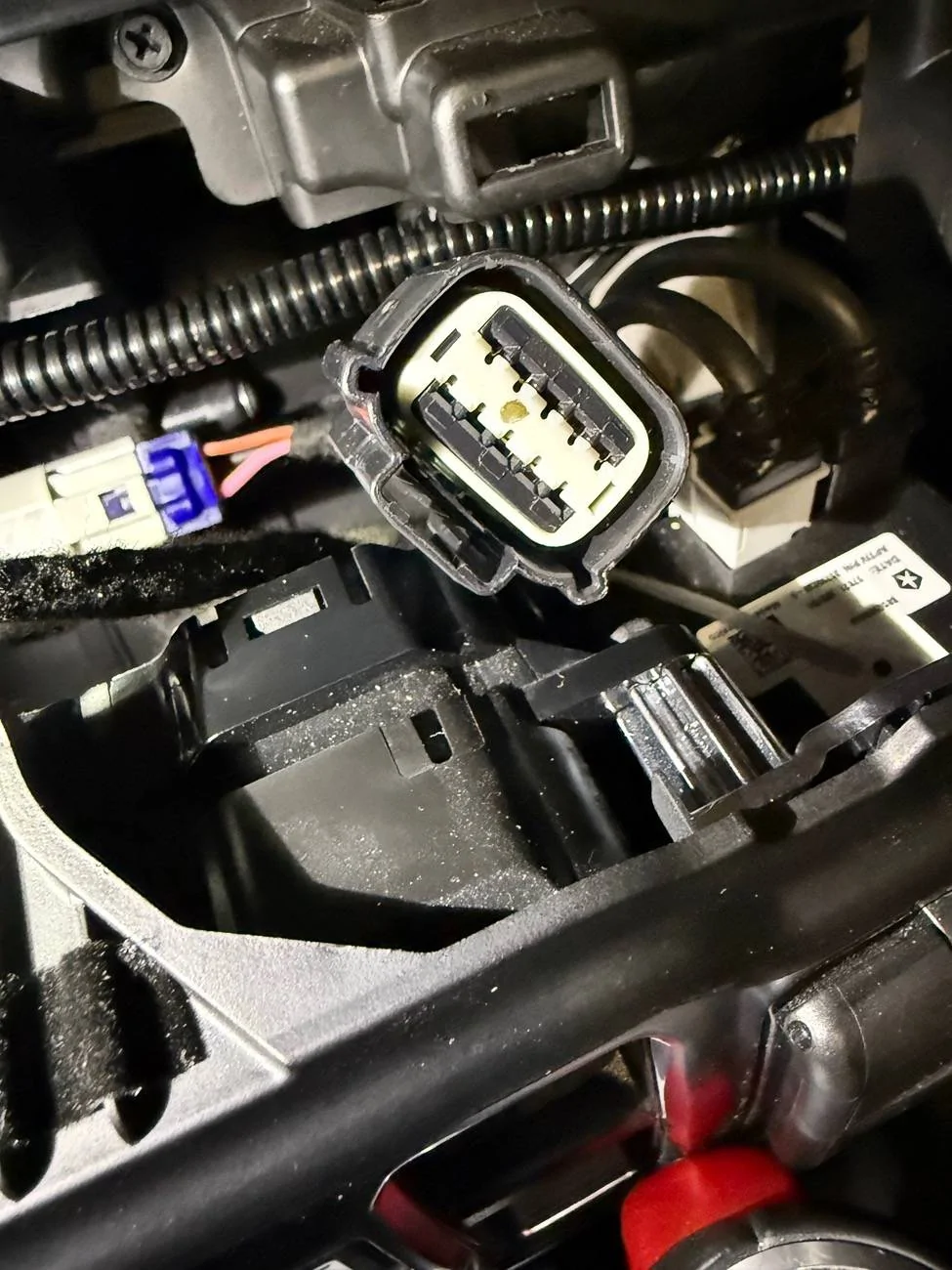

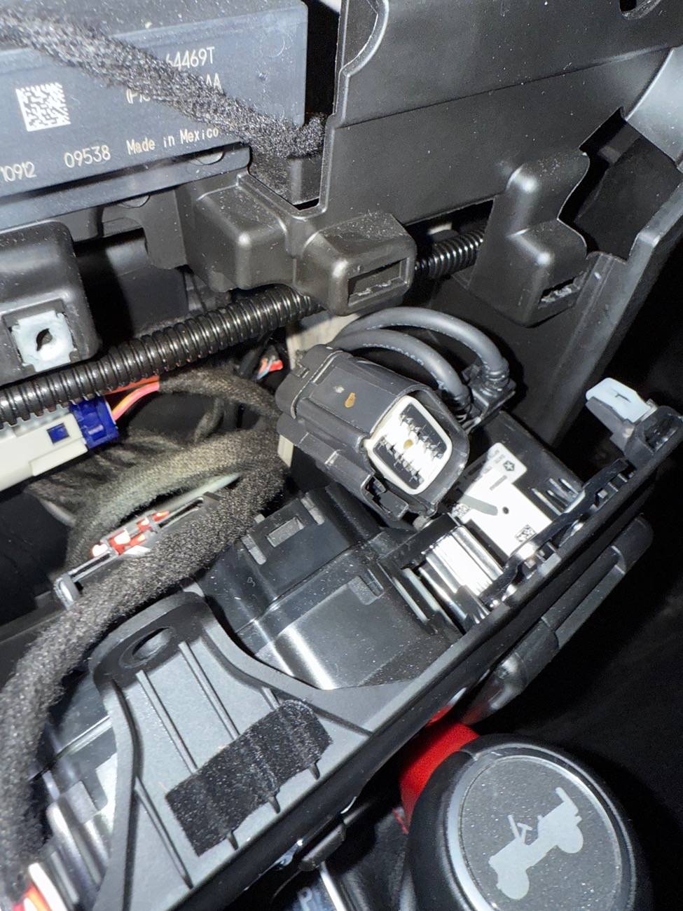

What is this behind my window switches?
It’s not plugged into anything…

Most car companies use only one wiring harness. All cars come with the same harness which covers all of the options offered by the company. Just think about the cost to make a harness for each model. To answer you question, this is a 10-place Molex ( I think)connector female plug. What is it for? Probably some option your vehicle does not have. Hope I haven't bored you or sounded like a "know it all".

Thanks for that info!
I just had the factory aux switches installed and i don’t think the switches are working. The lights aren’t lighting up when I click them.
I have the TazorJL and have programmed the Jeep for the aux switches and I can see the aux switch in the settings now.
the dealer said it’s in my settings but it’s not showing up on the jeeps computer so I will have to take back and have them flash the computer.
I thought maybe something wasn’t plugged in which they’re not working.
Tazor said they will work by programming it but maybe not…?

The connector looks identical to the plugin they just installed for the aux switches.

What color are the wires? Should be easy enough to check wiring diagrams for the match.

Yes, the aux switches show up in the settings and you can click into the 4 switches and change settings but the switch itself isn’t working.
I read where in the past, this would happen and a Tazor update fixed this. Wonder if something in the software broke again.

I would make sure that the orange wire in the kick panel is connected. I installed one for my best friend and didn't get the connector snapped together completely and it was identical to the situation you're in. I pulled the kick panel apart and snapped it together and every switch started working.

Yup, the issue was the dealer didn’t install wiring correctly.
They fixed the wiring flashed the computer and my aux switches lit up when pushed and power going to my lights hooked up to aux switch.
I was getting in the car to leave and seen they left the OBD2 device on the Jeep so I let them know. They pulled it out and I left the dealership.
as I’m driving home, notice I have a check engine light on and my radio setup looks way different than before. I went into settings and missing a lot of the settings that were there before and missing the aux switches also. My lights hooked up to the aux switch isn’t working.

Update:
Guess it needed some ignition cycles as all settings are back, check engine light is off, and aux settings are back in settings and working.
