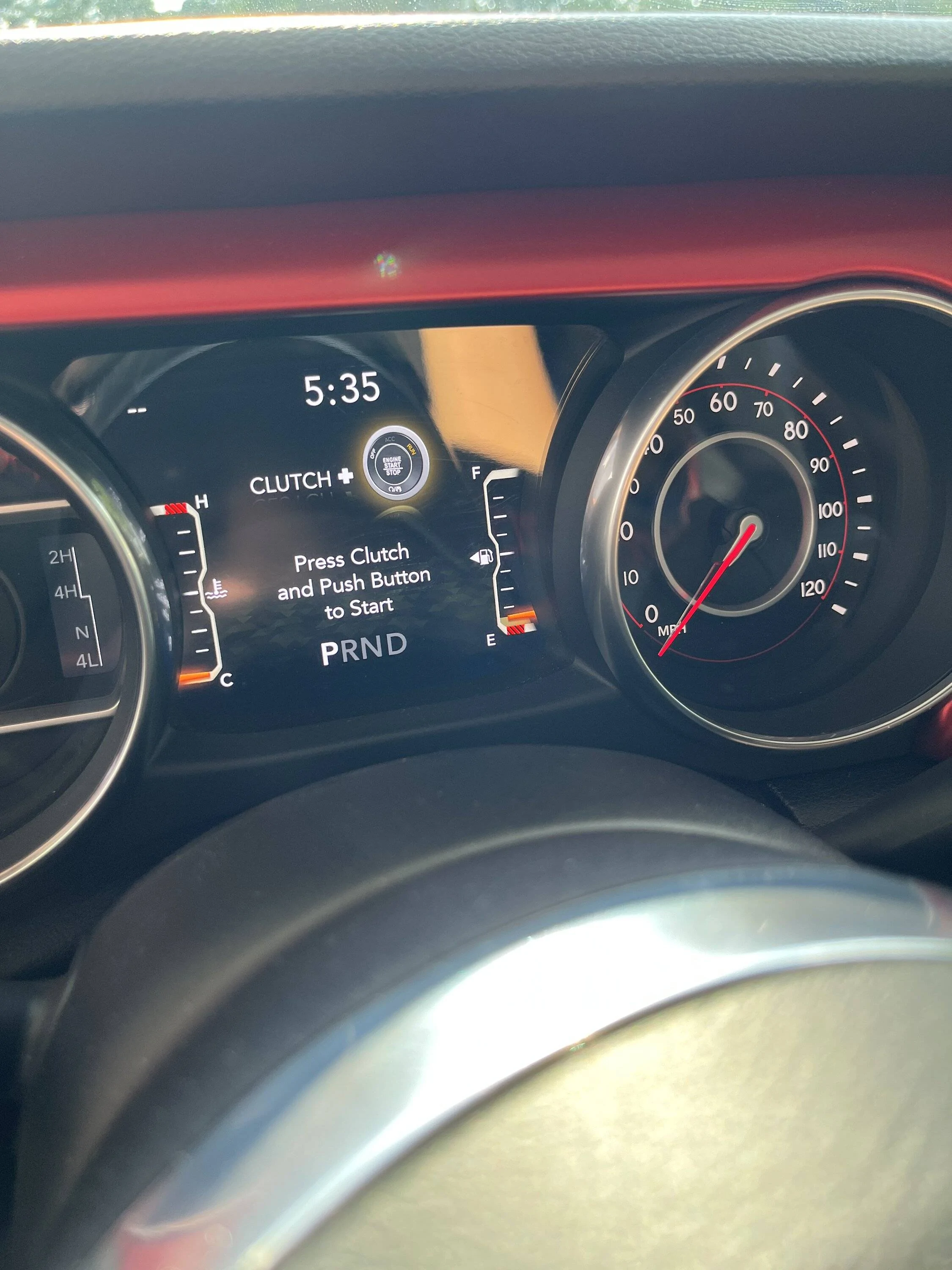

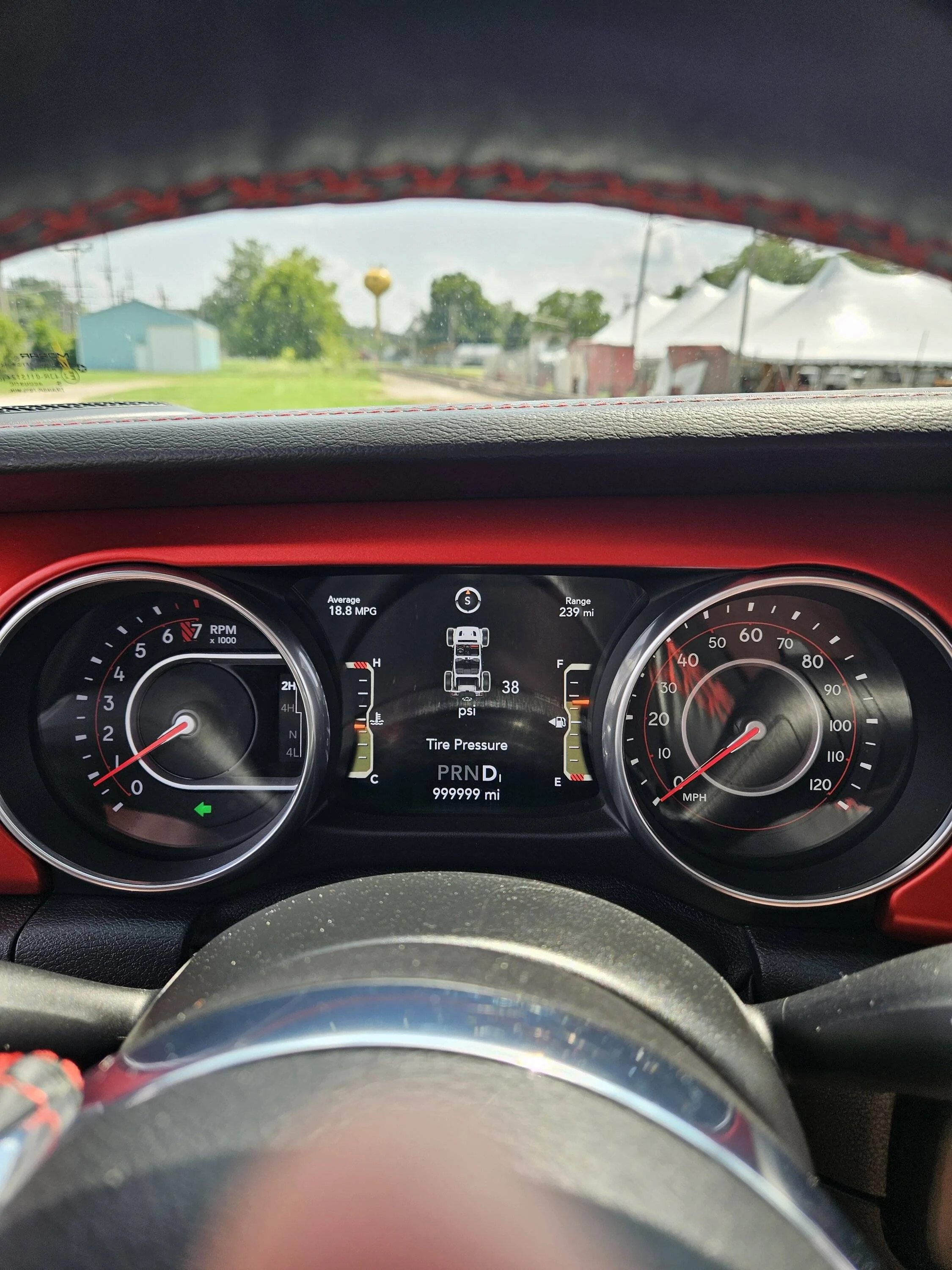

So this happened to me today. I think this battery's is on its last leg. I have a tazer so start/stop has been off for a while now plus battery's is original 2018. Yikes I know.

Haha! It's called owning a 2018. My 2018 would do the same thing along with some days the odometer disappearing and other days the dash telling me to press the clutch (when the Jeep was an automatic).

Yep mine did that a couple times.

999,999 miles is something I think nearly every one of us has seen. It is ubiquitous. Nothing to worry about- like the lines coming and going on your backup cam.
Wait, so the backup camera lines coming and going is common? Happened to me the second time yesterday (haven't had my Jeep very long). I wondered what I was doing to accidentally turn them off.

You might try and reflash the cluster. Had the exact same issue along with things not showing up correctly as well as clutch to start when I have an auto trans on my '18 jlus. Had to get it reflashed and that fixed it.

I've seen one cluster recover after doing this, warranty always had us replace them. Also what we'd always do after warranty was replace as well.

Your batteries aren't just on their last leg, They're on borrowed time!
Thank them for their exceptionally long service and put them out to pasture.
If you don't have eTorque, replace both Main & Aux.
