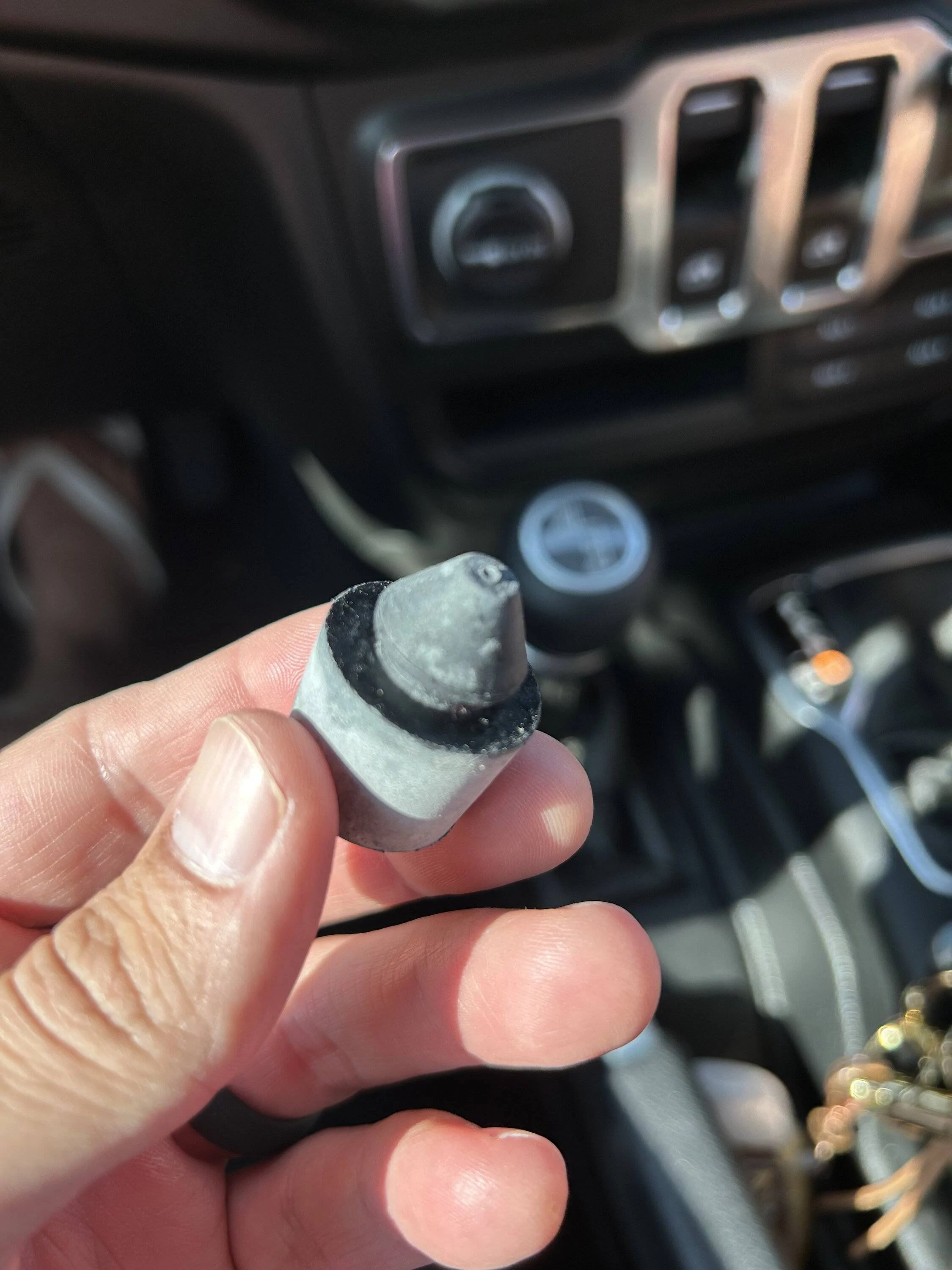

Had to move the front passenger seat up to get something in the back and noticed this laying in the floor. Any idea what it is?

Is that the rubber stopper/rest for the spare tire? Edit; no, don't think it's the same thing.

Yeah I don’t think it’s that. I looked up what you were describing and it looks different.

Yeah, I'm really not sure what it could be, but it does look like it would serve a similar function as a bumpstop for something.

Yeah, I just emailed my service department to ask them. Odd thing is that I don’t hear anything rattling or making any noise. Also can’t ding anything online that looks remotely similar to it. I’m just wanting to make sure it’s nothing super important.

I don't have my jeep at work to check, but is that a seat slider bumper so you don't slam metal into metal?
I didn’t think of that! Ill check it once I leave work. Thanks for that idea

Do you have a hard top? If so, check that both rubber bumpers are installed. They should both rest on the roll bar at the front of the top. You’ll have to remove the freedom tops to verify. I had this happen when I removed my top the last time.

I second what @senterb mentioned thats what it looks like to me too.
you guys are awesome!! Thank you. Just went out and lifted my top up from the front and got it back in! That thing was tough to get back in there but hey, I didn’t have to take the top all the way off so that’s a plus. This community is awesome!
