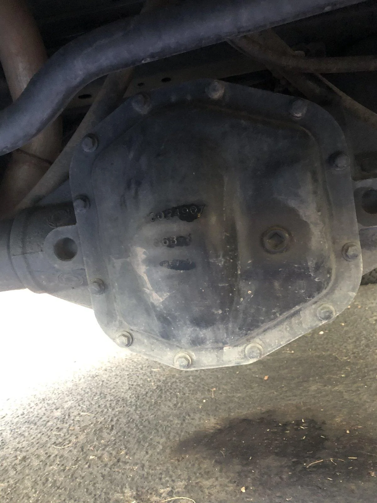

I have a Sport/MT and stock 3.45 gears with anti spin differential.
Is there a way to tell from the numbers on the covers?
The rear cover numbers are:
10024907
068-8
REV-D
The front:
10047747
067-8
I have included a picture of the back only, was not able to take a good picture of the front.
Thank you for your help.
