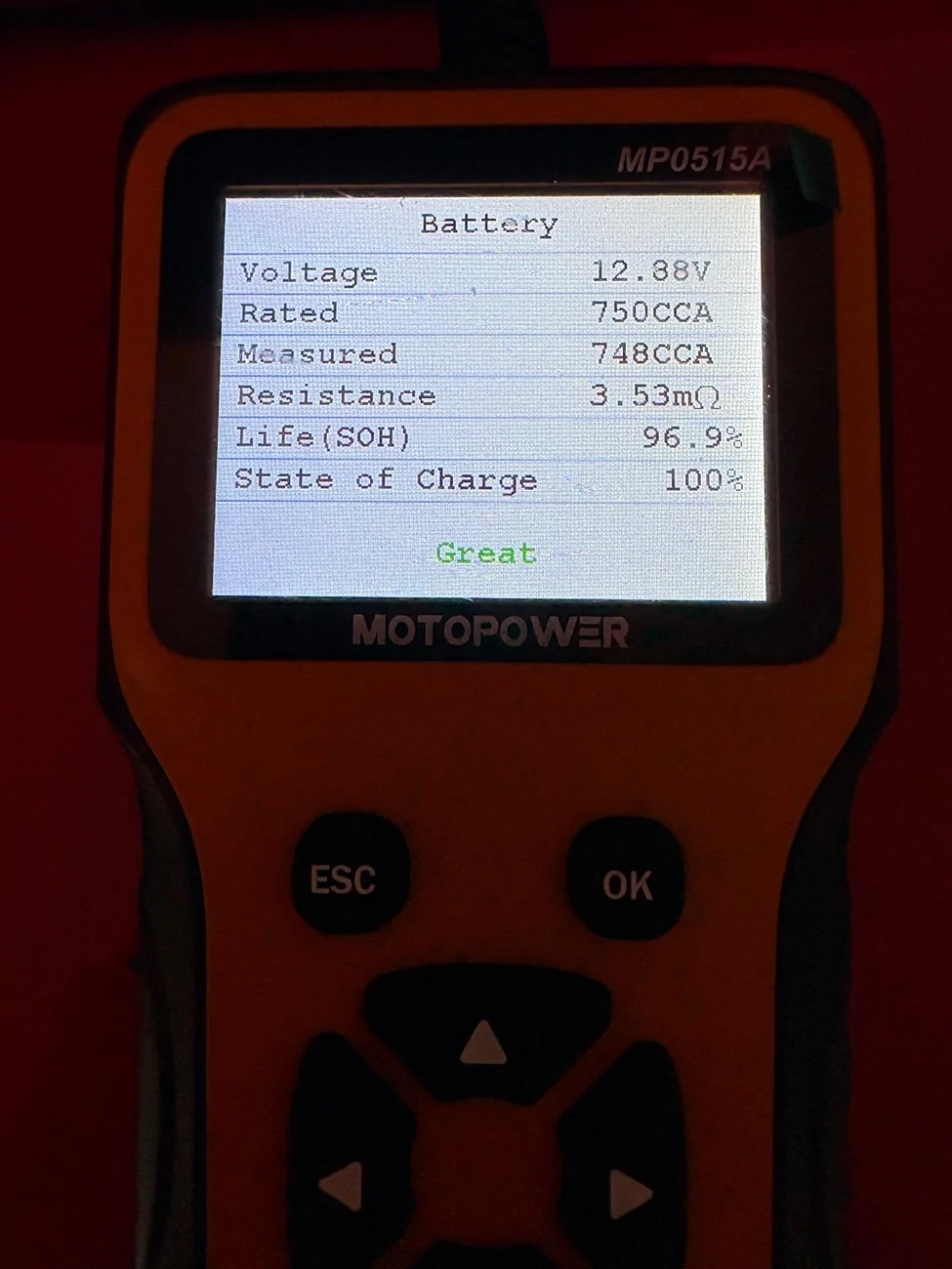

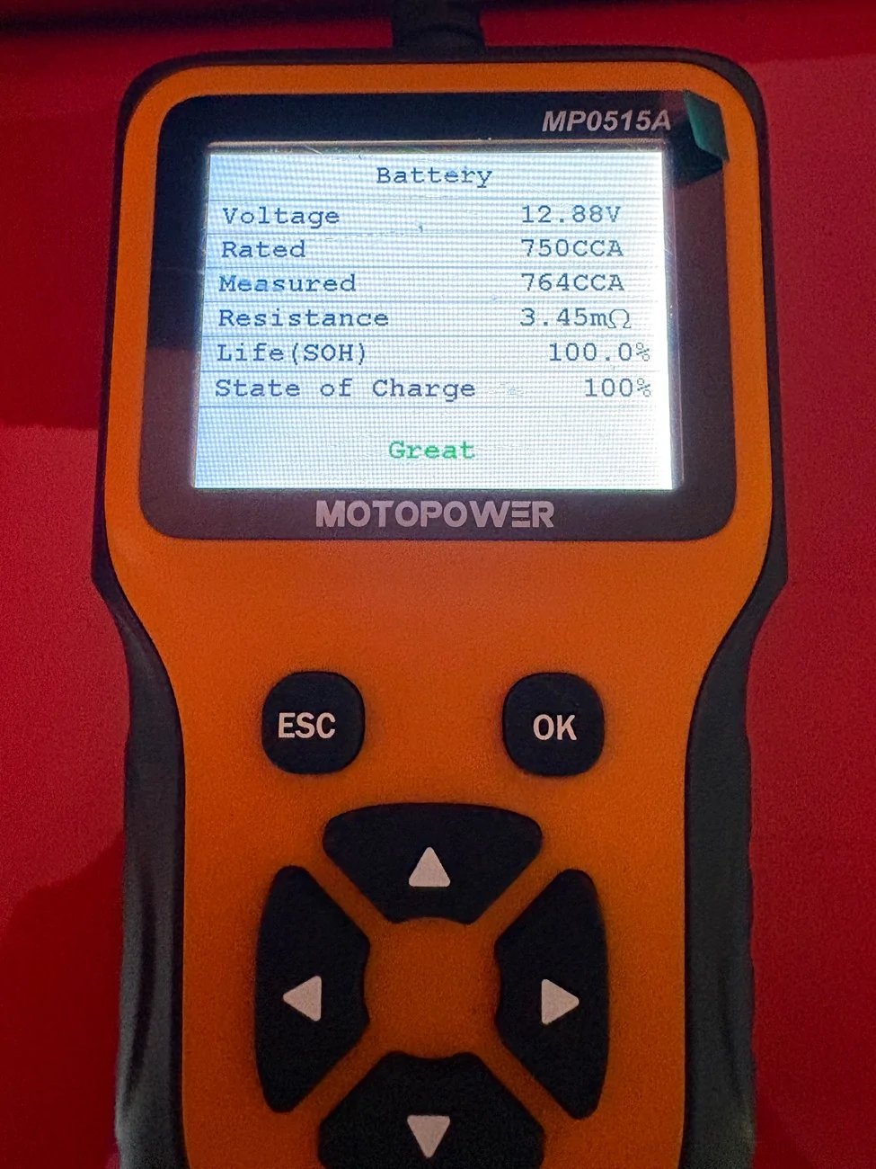

Right after coming home I have manually disconnected the relay that connects the two FT-750 Full River batteries and wait 30 mins to check after surface charge has dropped off and battery tests have been good at 30 minis and 12 hrs later with voltages in the 12.8 range, CCA 675-700( rated 750) res less than 4 and SOH 80%
I drove the jeep yesterday for maybe 2 hrs and this morning for maybe an hour, here are some recent tests after it’s been parked for several hours, first pic is primary and second pic is aux and both are new and installed 11-24 ( 18 months)

I think you're charging properly. On the FullRiver website, there's a link to a pdf with the state of charge voltages. I think 12.9v was 100%

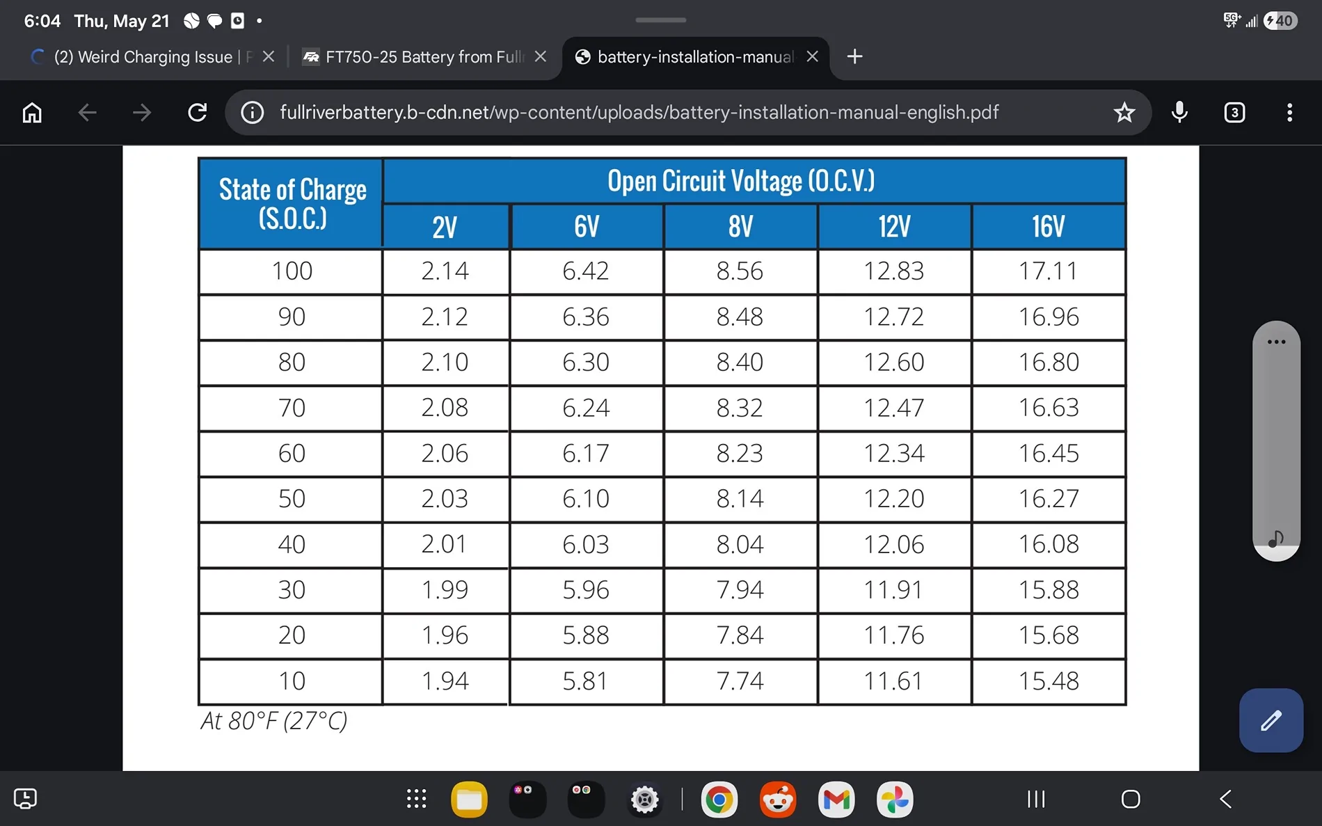

Here's the FullThrottle table for state of charge.

Different battery types will have different state of charge voltages. Toss in battery age/condition, charging systems etc, and there could be some variability.
