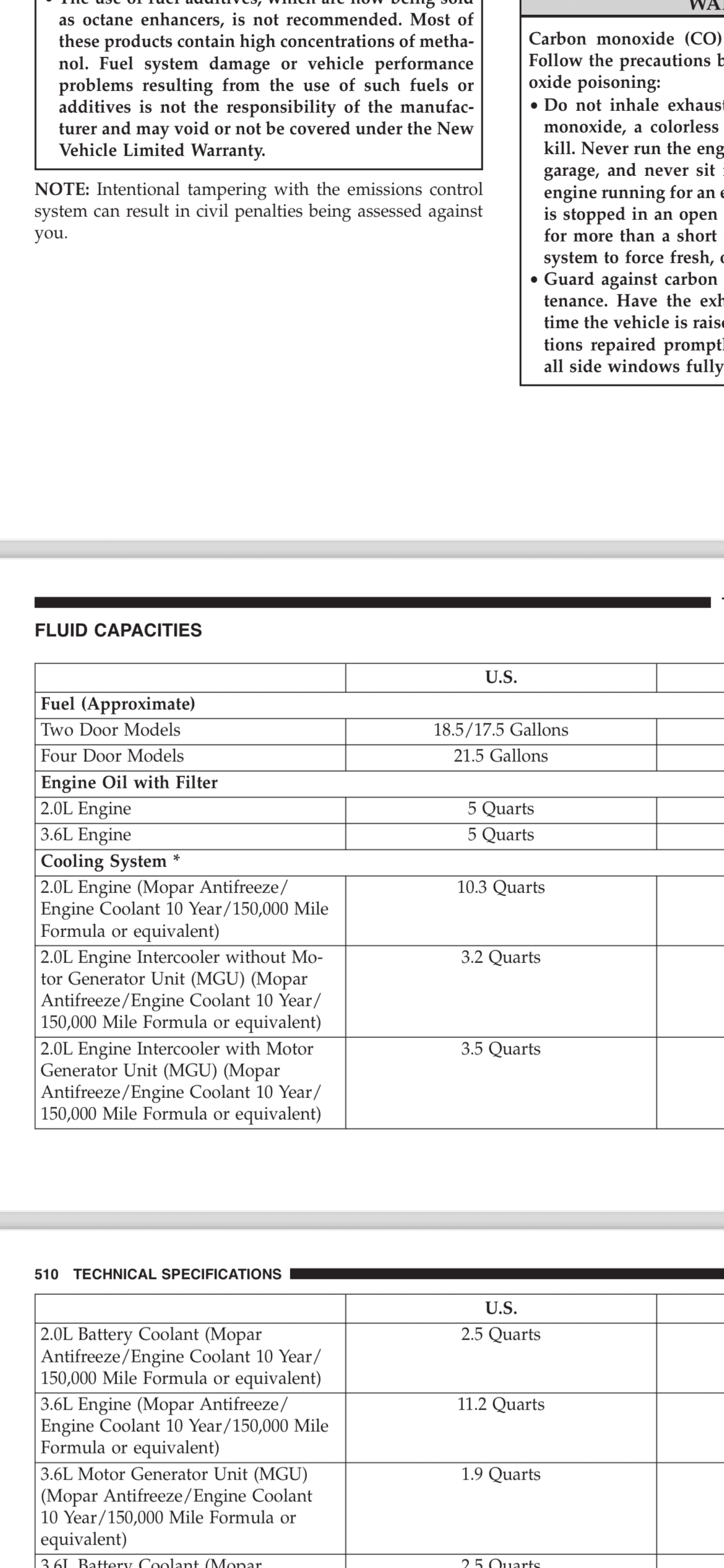

What I think it has accomplished more than anything is owners believing their engines are overfilled partly because:
1. FCA reduced the oil capacity from 6QTs to 5QTs when the 2017 redesign happened (3.6L).
2. Nearly everyone is used to checking the level when the engine is cold and all of the oil is in the pan.

I had a dealership oil change today, the paperwork said they put in 6qt, I questioned it and they said the correct amount is 5.8qt, that’s what they fill to.
Everything I find on-line says 5qt max, what’s the right answer here?

My Jeep wave oil change says 5 QT, so does the manual. When I do ,my oil change, i pour 5 QT and sleep well at night.
Most stealership techs are morons, not all, most
The right answer is change the oil yourself, remind your service advisor prior to handing him the keys, or find a new dealer. Some people here have put a label on the oil filler cap noting 5 quarts. I buy in a 5 quart jug and spend 20 minutes doing it myself. I know that’s not for everyone.
