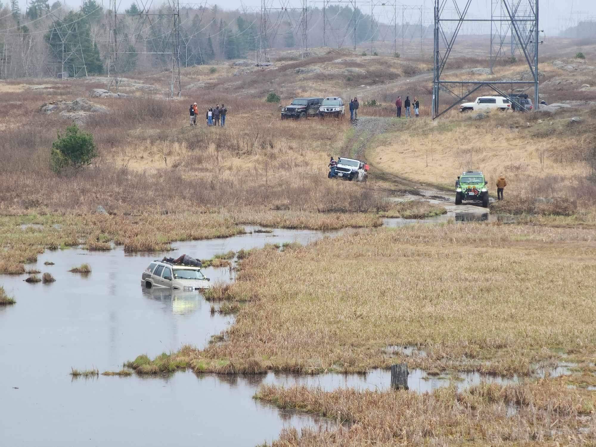

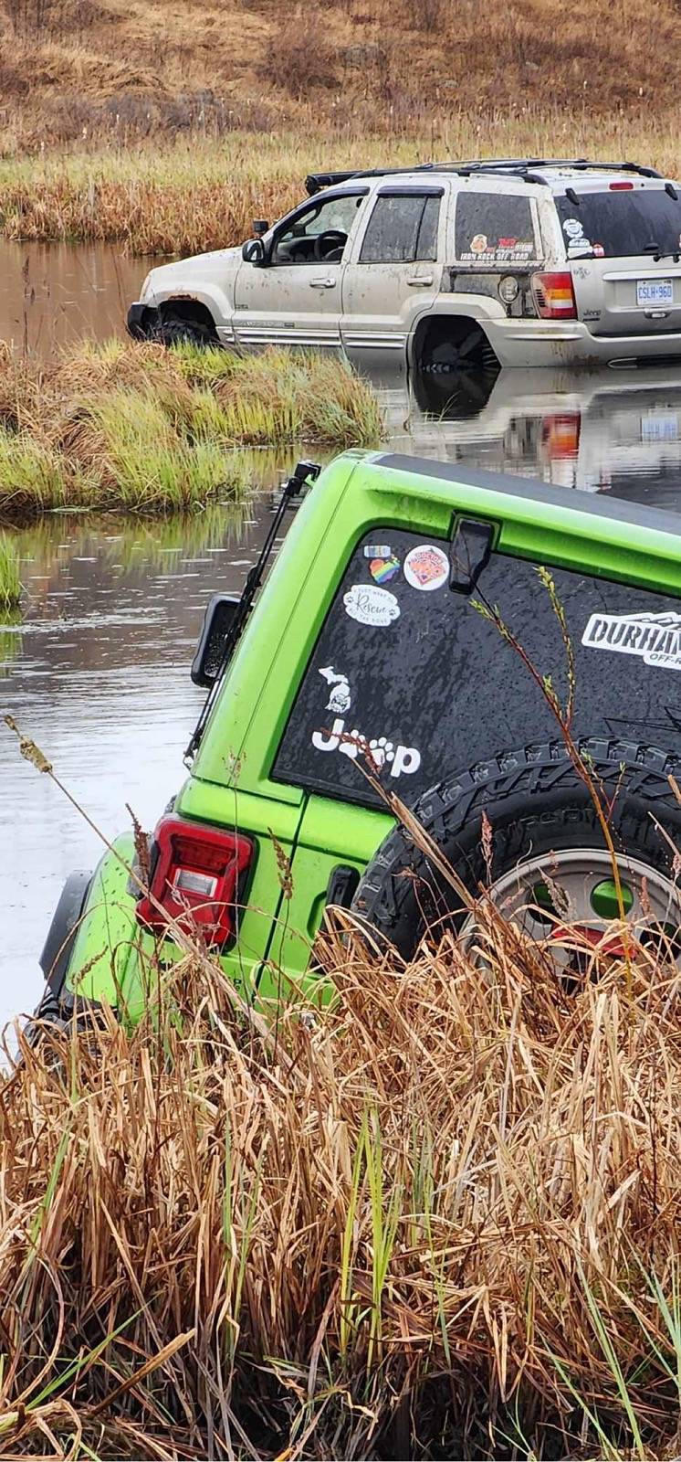

So, this particular trail is called Lingham Hydroline. It's in Ontario, and is, for all intents and purposes a 2 rated trail. Mostly a gravel road. Except for one water crossing that can get very deep. Under the water is a washed-out portion of the trail. If you go to far left/right, you slide off the trail and into really deep water.
I've crossed this water crossing 5 times prior to this and rescued 3.5 other vehicles out of it. SO when a WJ went in and off the side ahead of me, I didn't think much about it. Another club member climbed onto my bumper and hood, we attached my kinetic rope to the bumper.
We got the WJ hooked up and after 5-6 tugs, got him back up onto the trail. Unfortunately he had swamped his motor. Getting ready to pull him back the rest of the way, I misjudged where my front tire was and slid off the other side of the trail. Attempts to get myself up and out were just spinning my tires and the back slid off.
Shortly there after, passenger tub filled up and BCM shorted.

If I was to do this rescue all over again, I’d use my winch. If I then slid off somehow, I’d have used the WJ to anchor me and winch myself back up.

Update: BCM replaced, no power from ignition. No Accessory, run, or ignition. Off to the dealership to diagnose.
