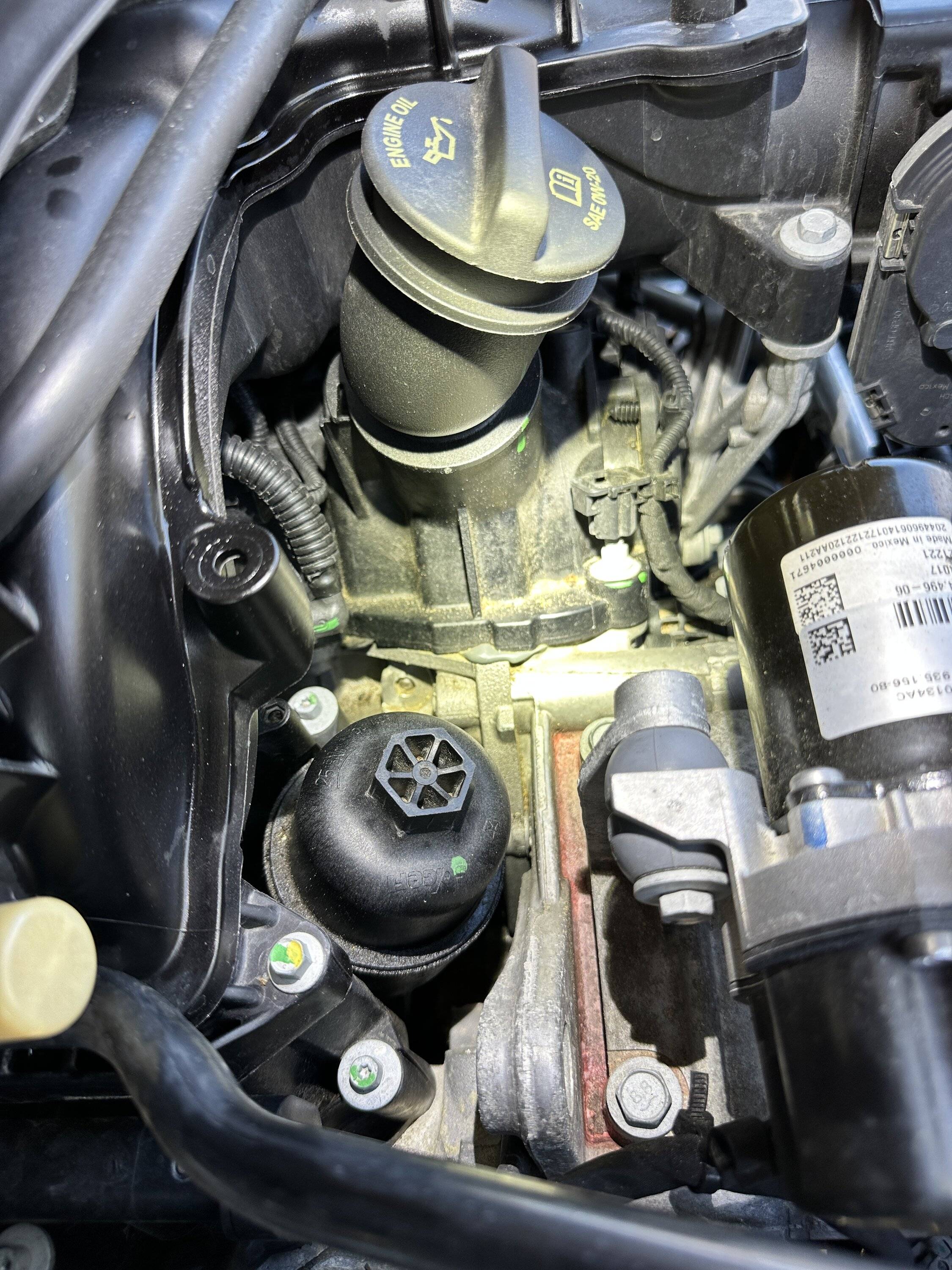

Smelling coolant randomly and saw this. Coolant on top of the front diff. Can’t see where its coming from though.

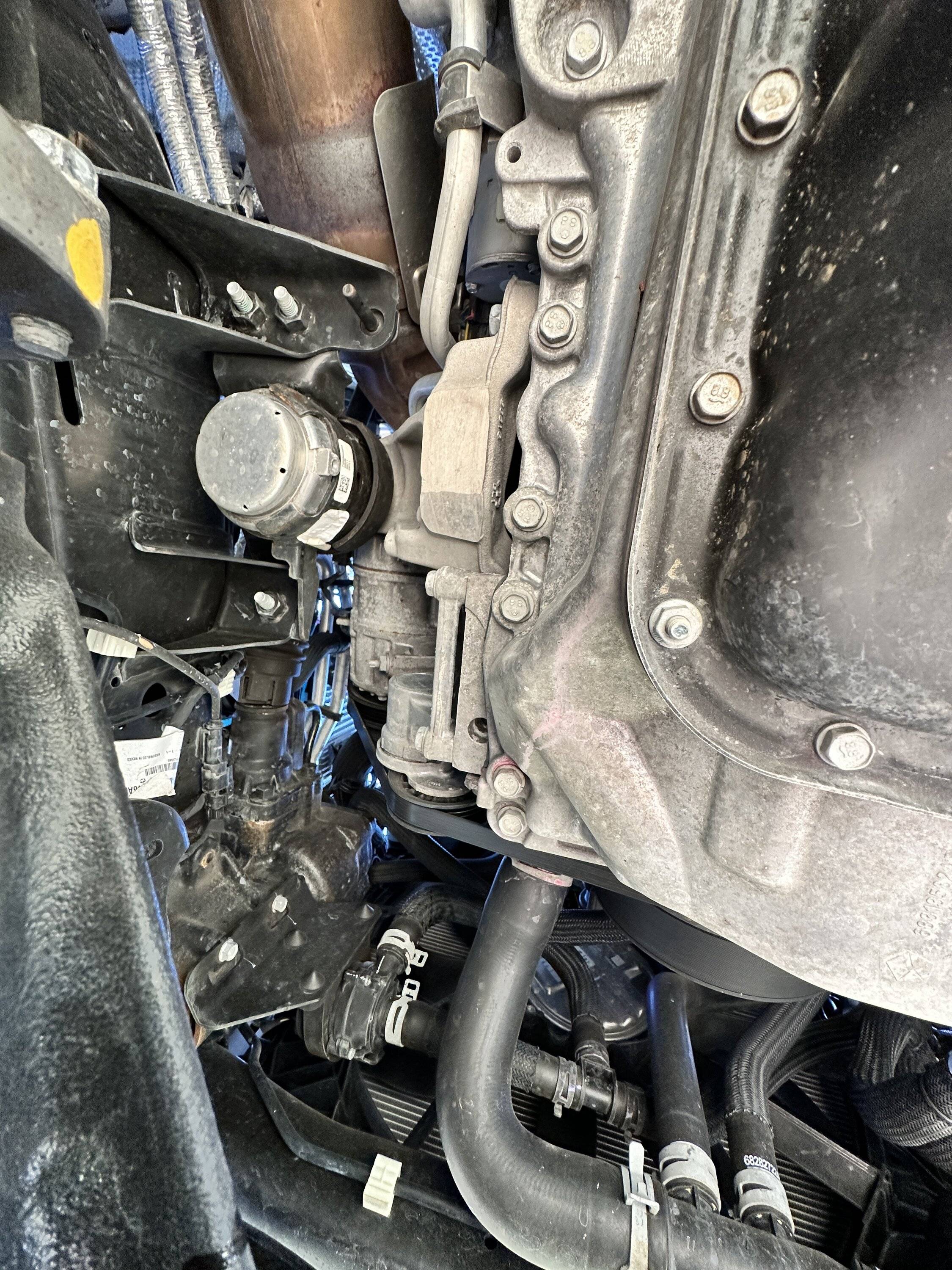

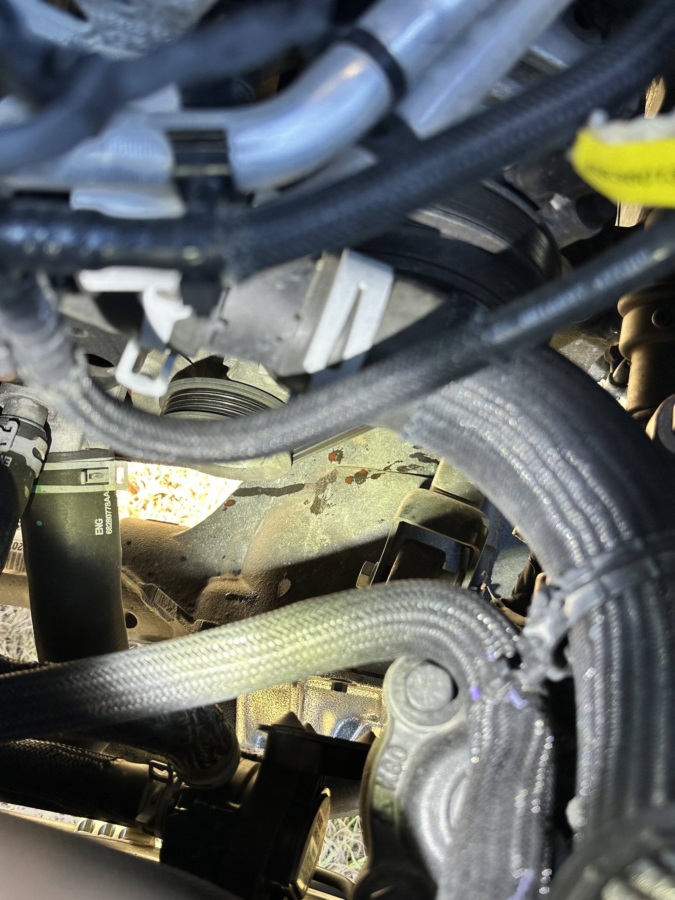

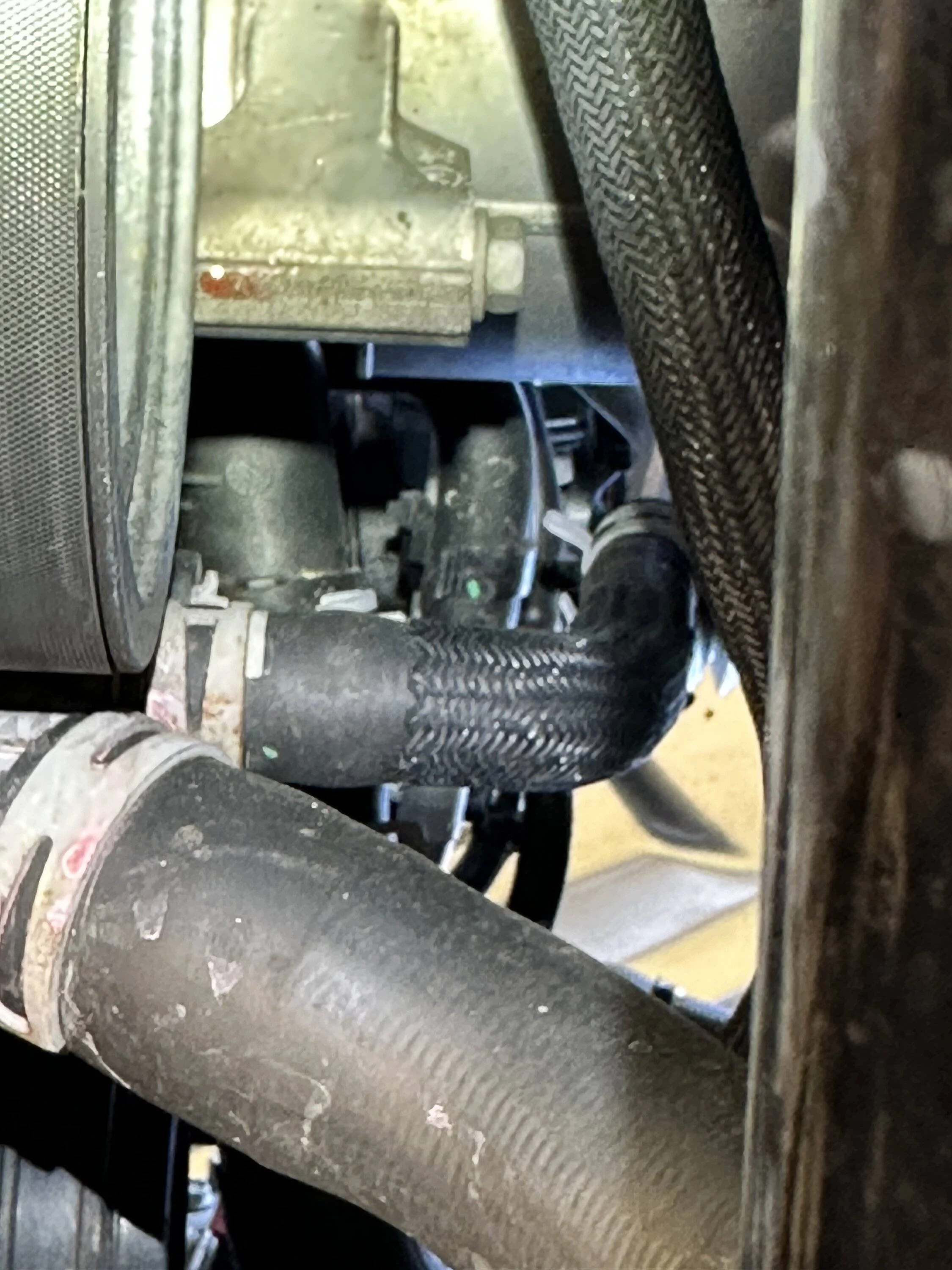

I can’t tell…. There’s crusty coolant all over, from the top of the oil cooler down.

I have a 2.0L so not much help on location, but find out where your water pump is and check the bolts. I know on at least the 2.0L it is a known issue. We got back from a wheeling trip in South Dakota and inspecting my undercarriage for damage, I smelled coolant and found some on the top of the front diff as well. Luckily a buddy had the same issue and had told me about the bolts coming loose. I located mine and snugged them up and it stopped. Dealerships know it's an issue and typically remove them and use blue loc-tite from what I hear.

Thank you for your response! I have an appointment to drop it off tomorrow.

Water pump done and they also changed the timing chain cover. 5 days wasn't a bad turn around.

I'm not sure why the Timing chain cover was changed. I cant get a straight answer.

Are you sure it wasn’t the water crossover pipe on the timing cover? There’s no reason to R&R timing cover based on the symptoms unless they blew the threads out of the timing cover with an impact when installing the water pump.
