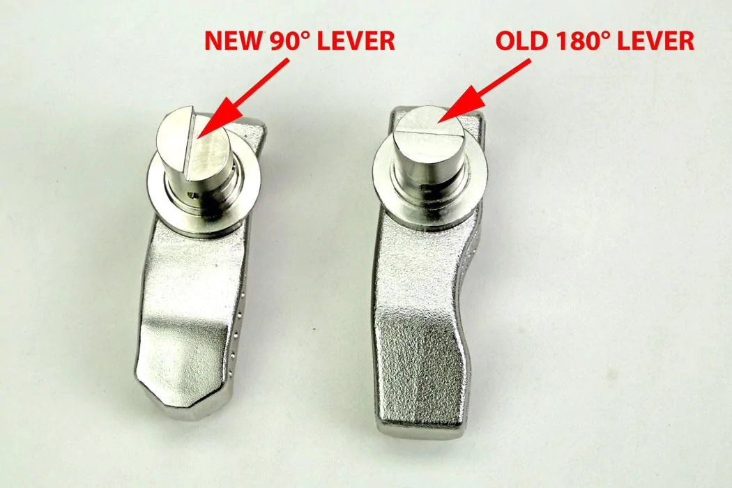

Just installed my 90 degree lever. The biggest pain in the ass was trying to close it all back up. You basically have to shimmy the crap out of it in every possible direction until it finally closes flat, and then without letting go of it, start getting your screws in place to hold it. I had to shake it pretty violently while rotating and twisting to get whatever the hang up was to seat. Then I let go, and it backed out 1/16" and I had to do it all over again.
Wear disposable gloves, and change them frequently.

In talking with Warn, this is not a problem when using the Warn mounting plate. It is a problem when using the Mopar mounting plate. Not sure about JCR’s or Rusty’s plates.
JCR's plate comes with a .030 shim plate to put between the winch plate and the winch.
that in theory will let the lever miss the edge of the bumper. dunno if it works, i didn't
need it, so i didn't use it.
understand, getting that winch in between the bumper horns requires trimming the edges of the horns,
and is like packing a marhmallow in a piggy bank. 1/16" on both sides, and you are touching the grill.

No trimming needed with the Warn JL Rubicon mounting plate, ours went together perfectly.

The trimming is not a factor of which plate you choose, but where your jeep falls in the tolerance range. My frame forks, for instance, were so tight together that my bumper didn't even want to go back on. I had to trim about 3/16" from each side, then angle the forks. If I didn't, the zeon would not fit between the forks no matter what mount was used.

Got my kit and swapped my lever already. Aside from a moment of panic as the gears didn't line up even after being so careful, it went fairly well.
The moment I was able to get everything to click back in place, I had the biggest sigh of relief. lol
