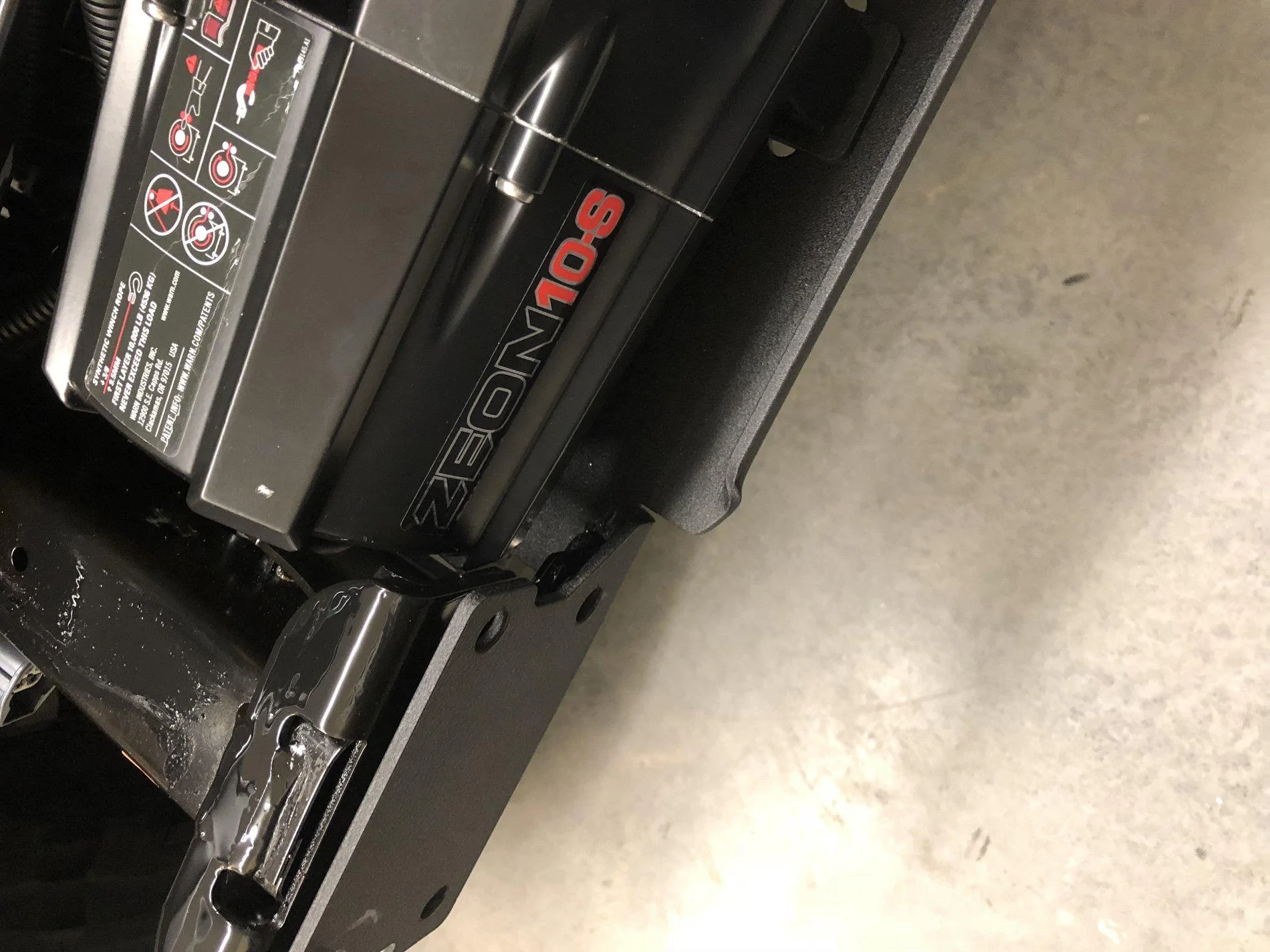

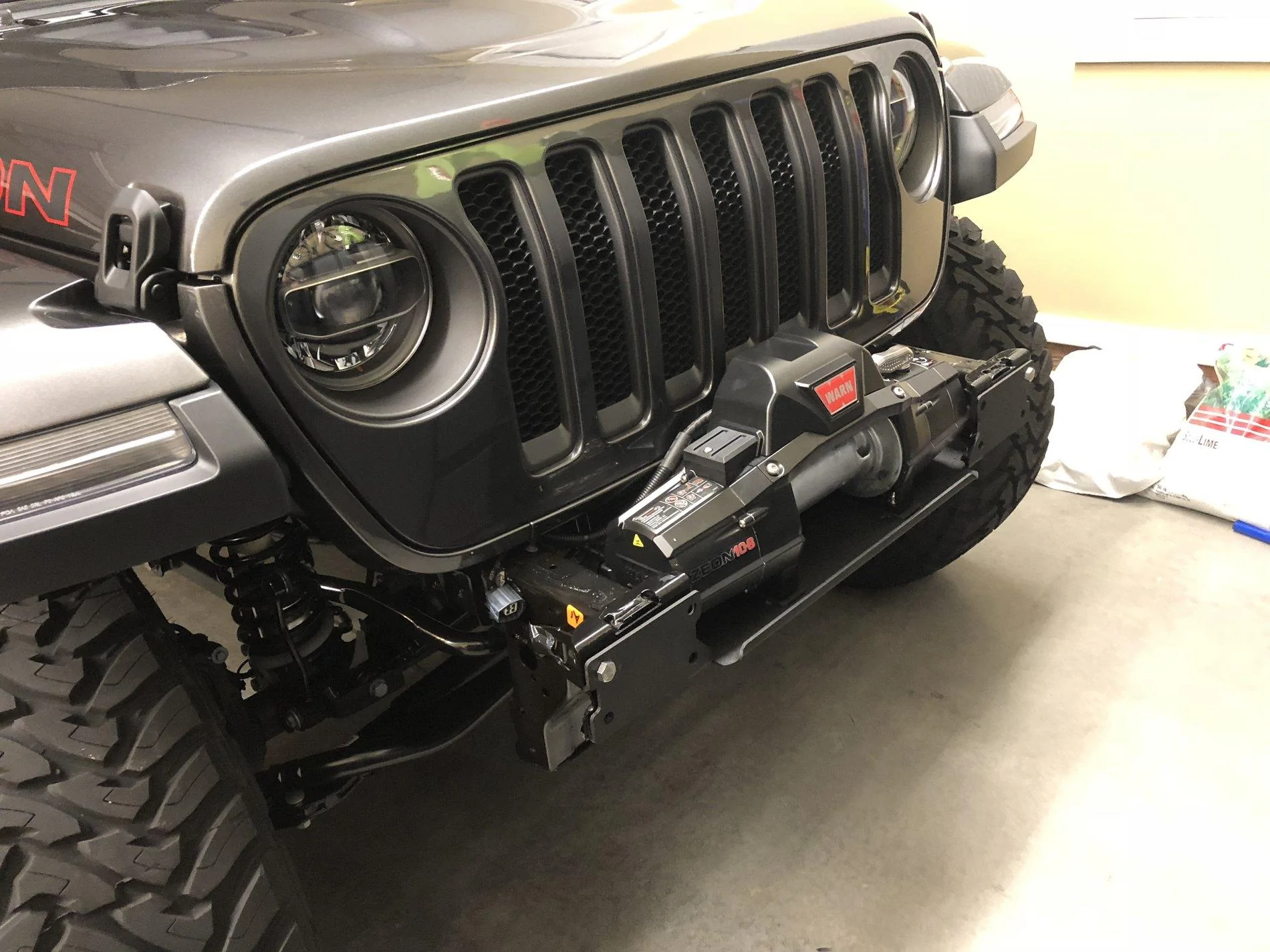

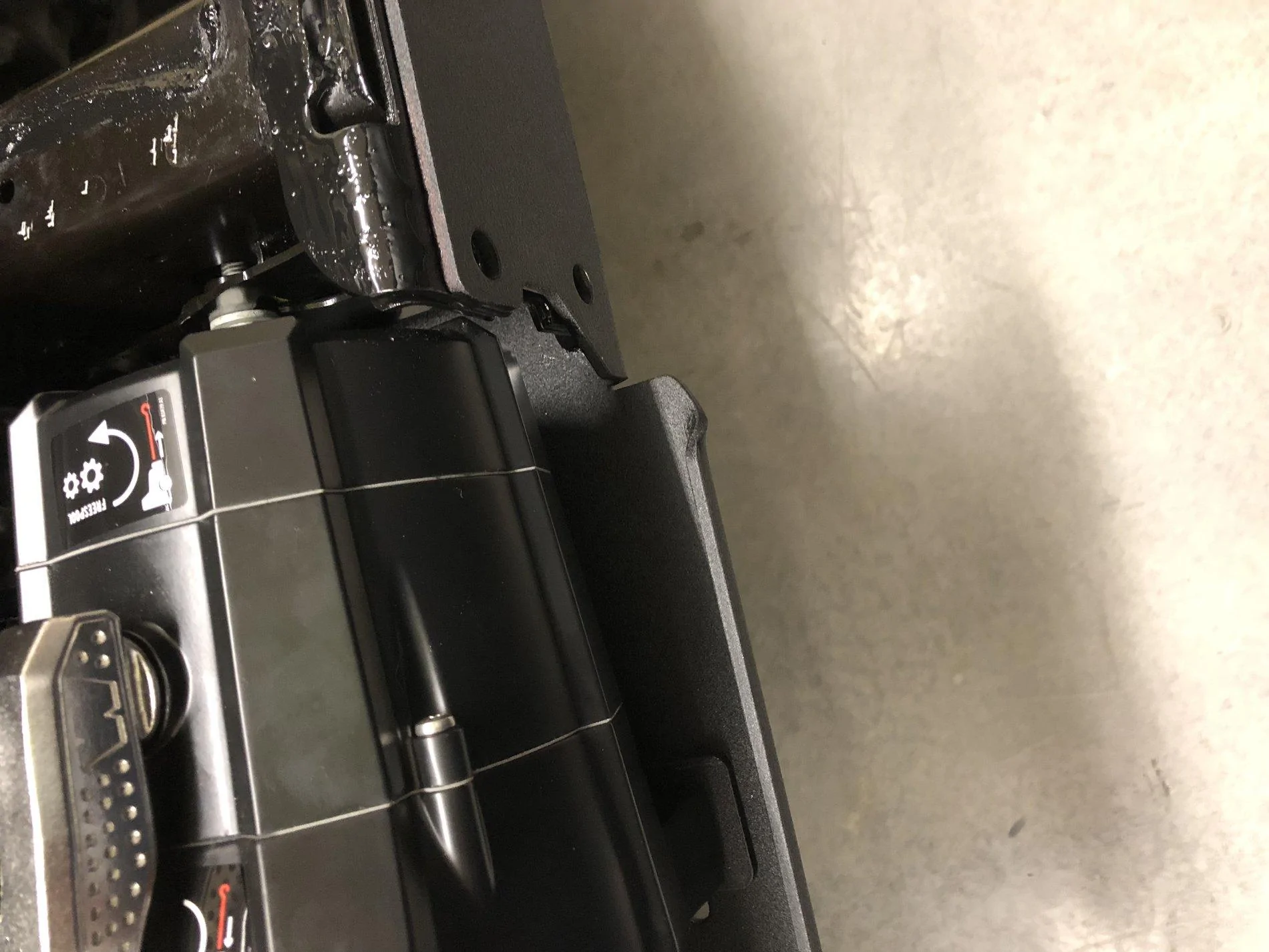

I got started anyway but the Zeon is tight. I haven’t mated the bumper back up yet because I still have a few loose ends to tie up first. Just wondering if I’m missing anything? I’m using the JCR winch plate and they provide spacers to lift the Zeon specifically up to where the free spool lever will clear the bumper. Holes lined up so there’s no front to back adjustment. Side to side i just barely was able to get it seated where is was BARELY not touching the frame mount. I did have to cut the factory frame mount to get it this close.

Finished mine today and the spool lever barely clears to full unlock. I was able to get 7 of the 8 nuts back on the factory bumper mounts, but there was 1 where the winch simply was too close to the bolt. It left maybe enough clearance to get a regular but, but the factory ones have that washer like flare on the back that simply was too large to get started. I’ll try to get a slimmer but at Lowe’s and see if that works.
Overall I would say that the winch looks great and will function 100%, BUT it’s likely a call as to whether you prefer an easy install by going w something smaller OR a PITA install to get the big boy.

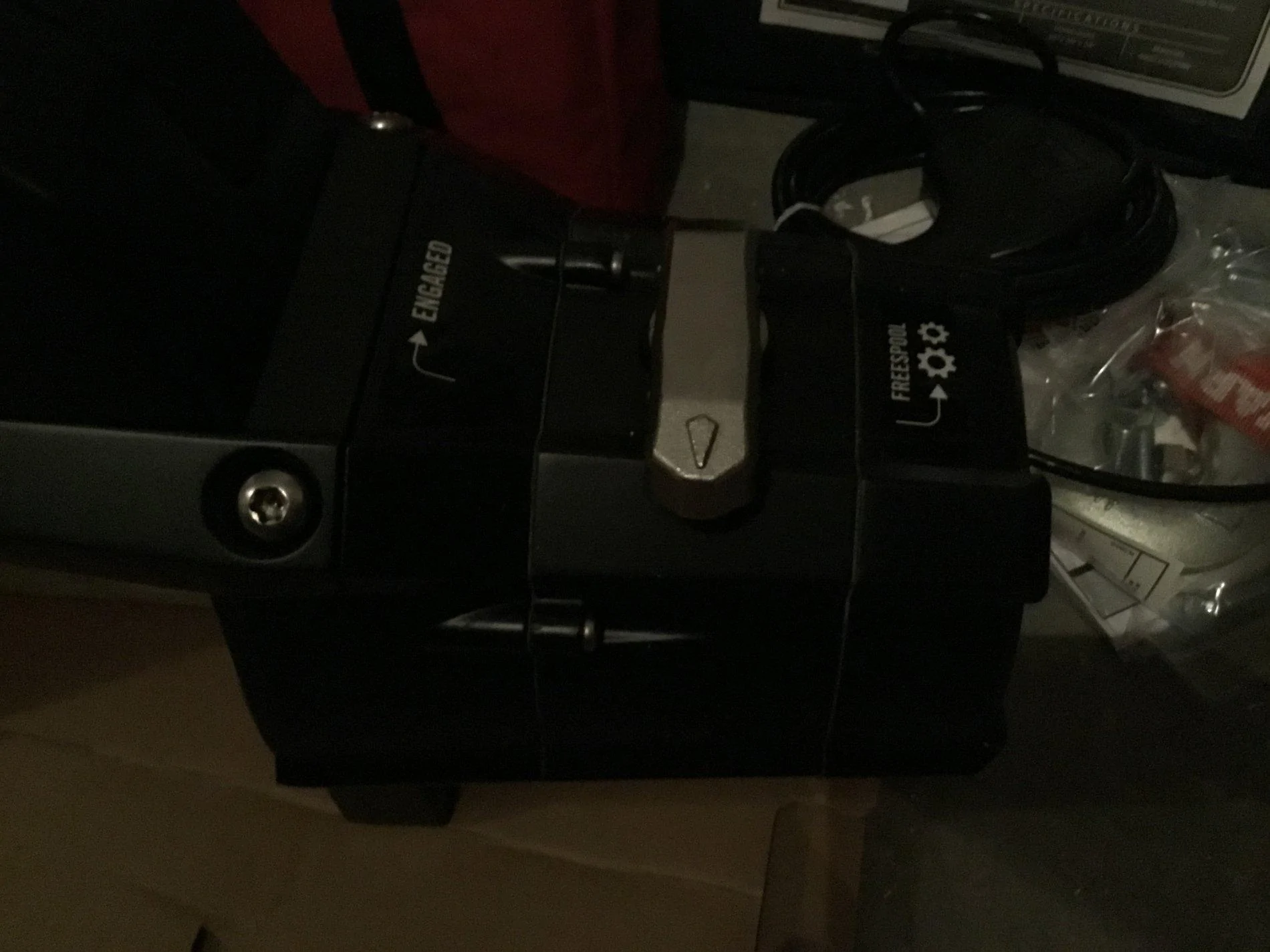

This is my Zeon 10S with the new lever installed (freespooled). It also has the new stickers applied.
