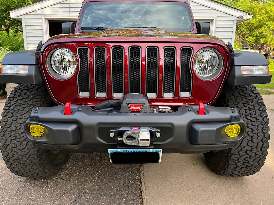

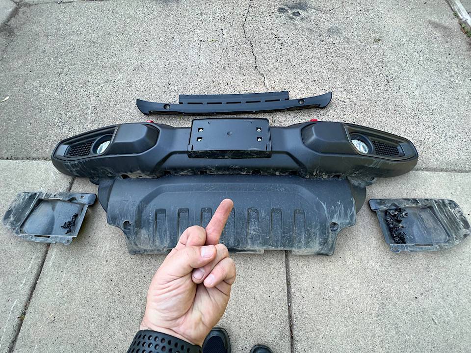

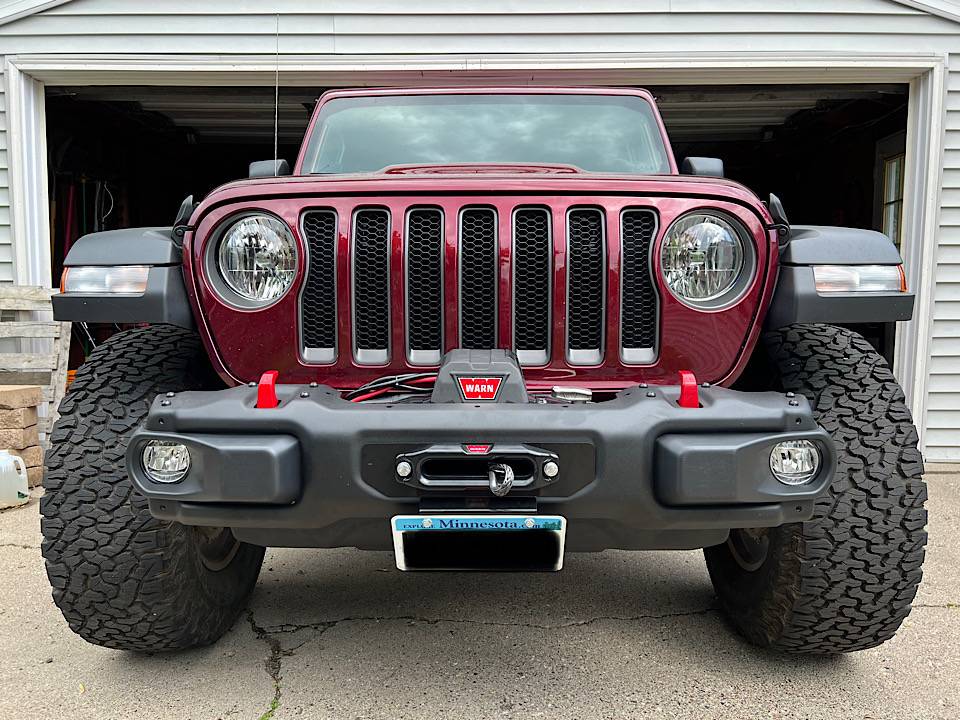

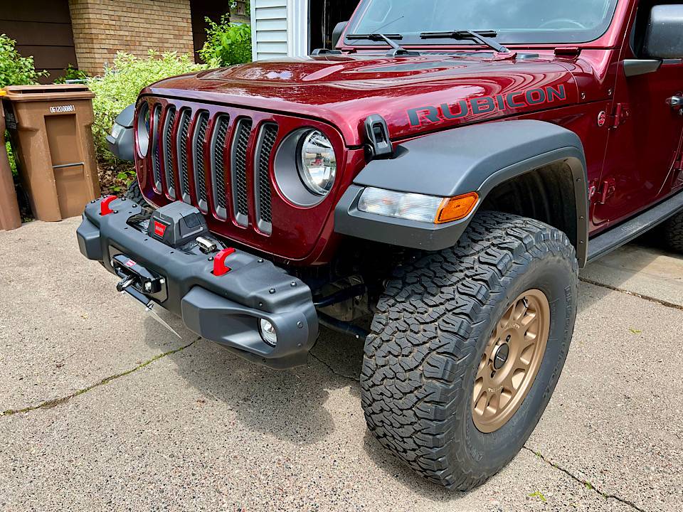

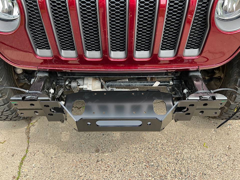

Finally got this bumper and winch combo installed…

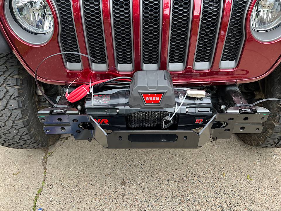

Mopar OEM Steel stubby and Warn VR EVO 10s. Got the OE steel skid plate and went with the Warn winch plate.
Things didn’t align the greatest with the skid plate surprisingly. Had to do some grinding on the back holes.
Happy with the result though. Still ended up adding 165 lbs to the front end. Coming from the stock plastic Rubicon bumper.

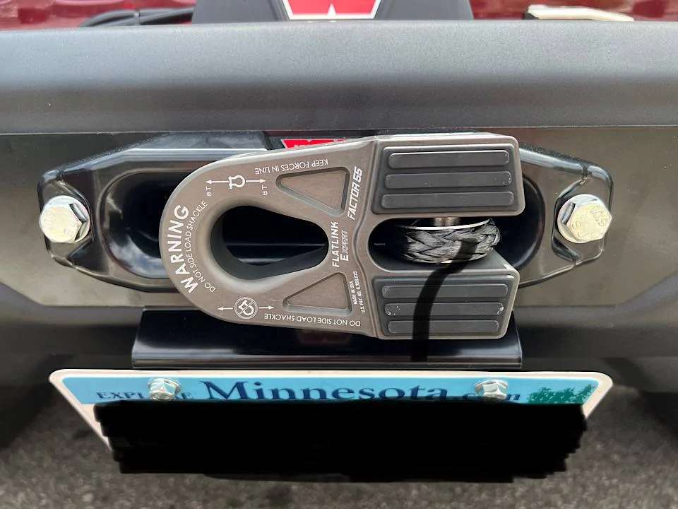

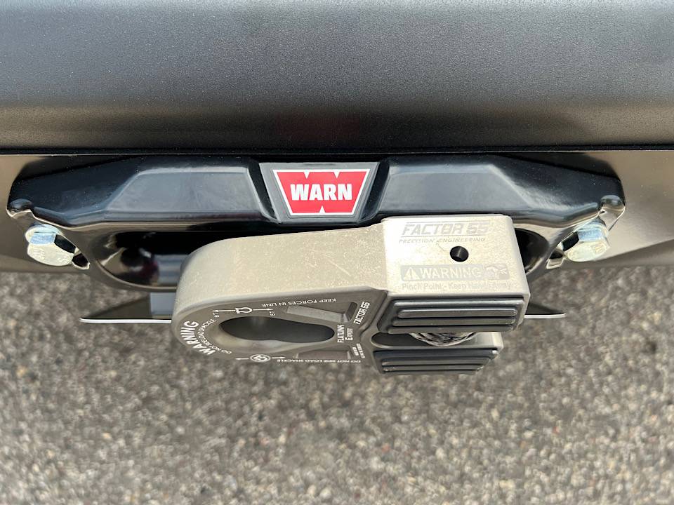

Quadratec had some of the Factor 55 flat links on sale so got the grey E (Expert) one.

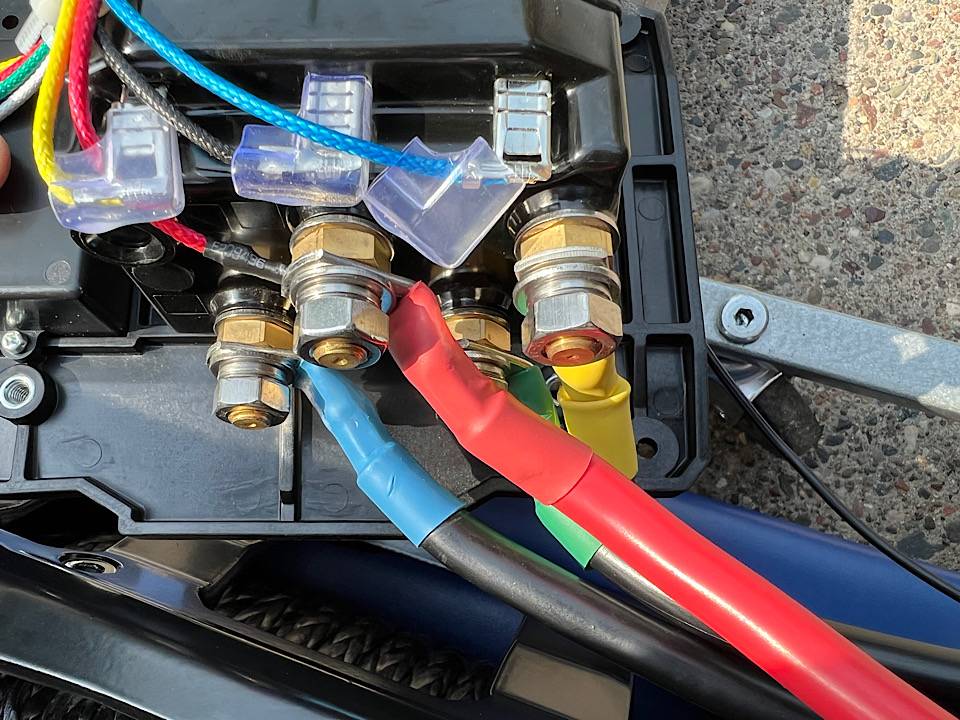

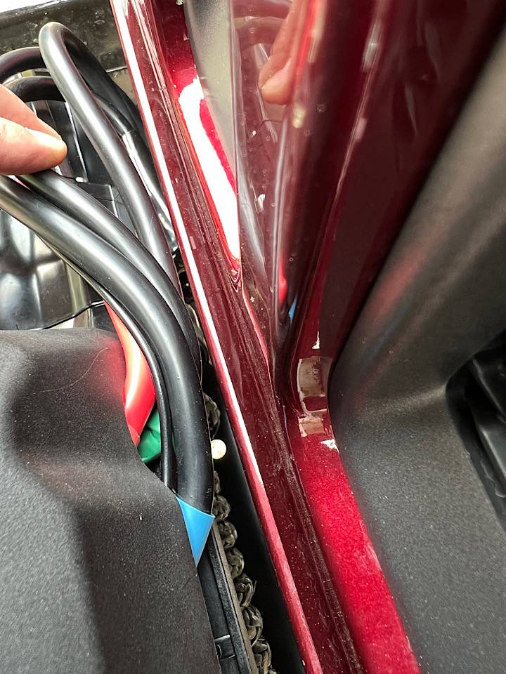

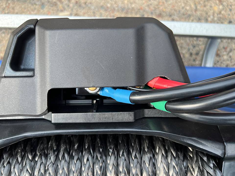

Did a bit of minor reworking on the winch control module wires. They were pressing into the grille so I dremeled the cover a bit and rec locked them.

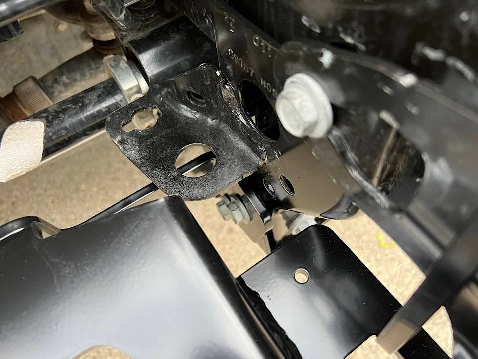

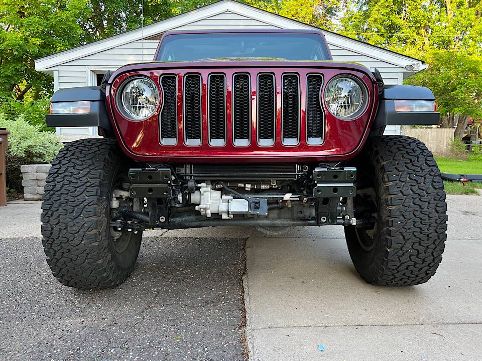

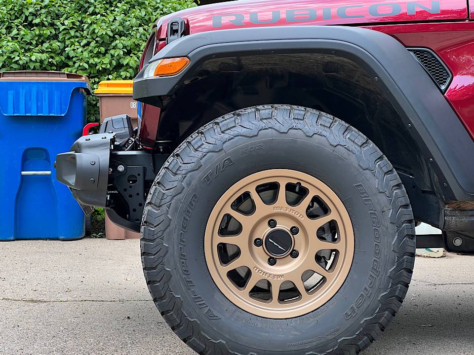

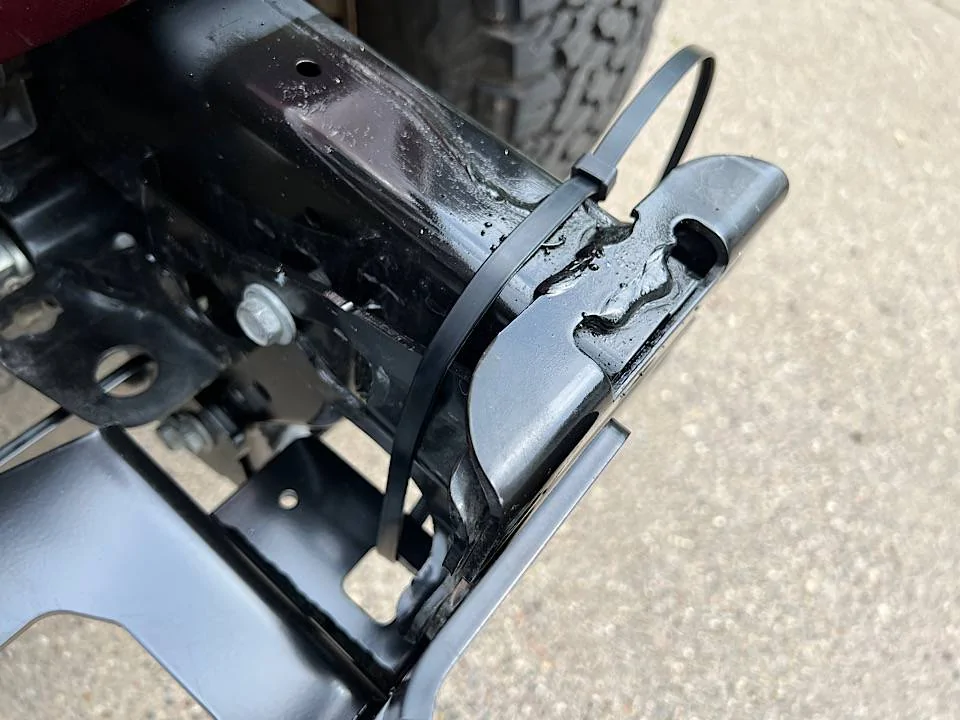

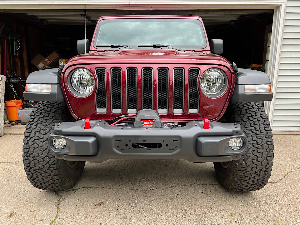

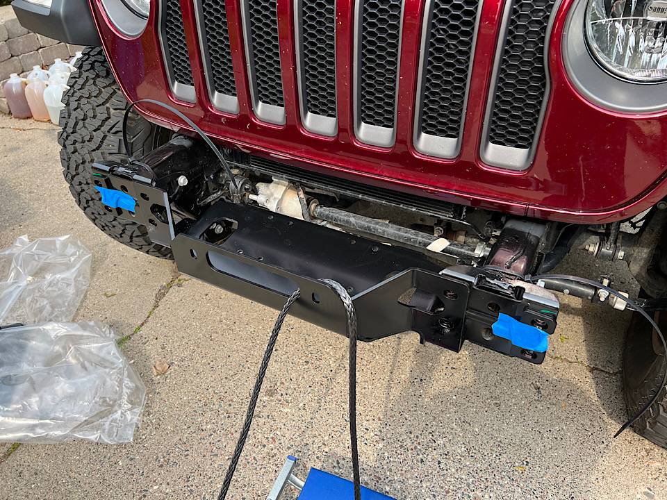

Some in process pics…

Looks great!
How did you manage the extra holes around the fairlead? I ask because this is the EXACT same mod I am working towards and that front, center has me a bit puzzled about how to deal with it.
Thanks!

This winch comes with a plate that sandwiches between the fairlead and bumper and blocks that off (and it has the tab to mount front plate to).
Ok, I see the plate you mentioned in your first photo. I must have missed that detail wile looking at the winch.
Thanks for the response!
