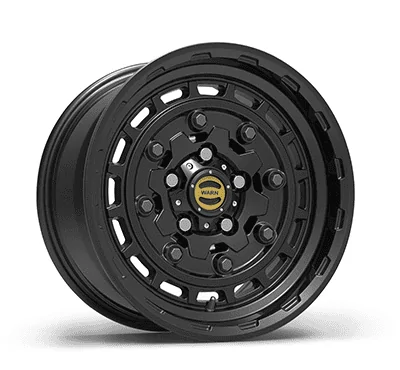

Could get a set of Warn wheels, at least they look like they have locking hubs :)
Jeep Wrangler JL warn locking hubs. 1605499815563
