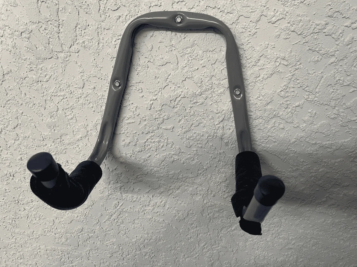

I use these: Ladder hangers , from ace Hardware. sturdy and I am able to anchor it into the block wall, I use them for all 4 doors.

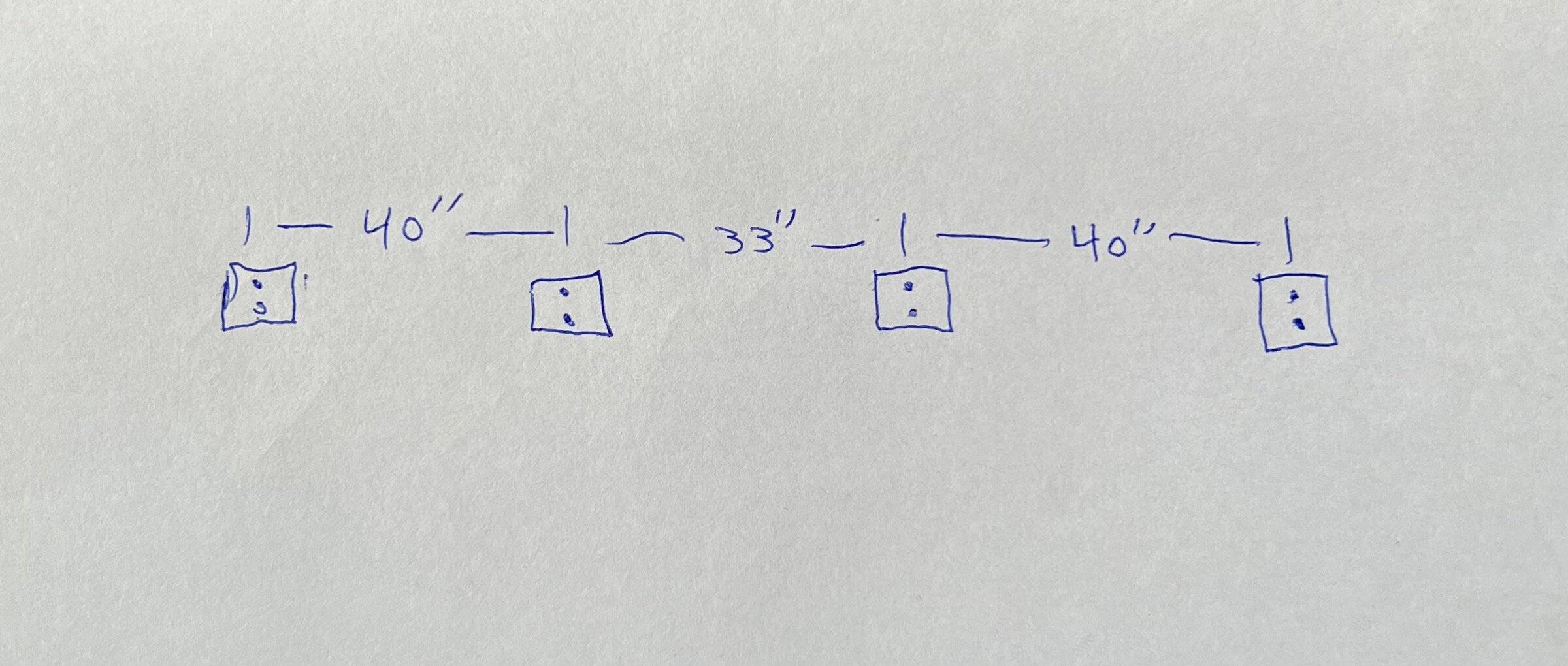

Hey bud. I got lucky and had many choices since that is outside load barring wall and windows so many studs to work with. Between front and rear doors the hangers are 40” apart (center bolt to center bolt), the space between rear doors is 33” c-to-c. Here is quick sketch lol

It is 6’ to the bottom of the ARC brackets. It is really preference on how high you want to mount along as they don’t touch floor. IMO, higher the better but they can be heavy.

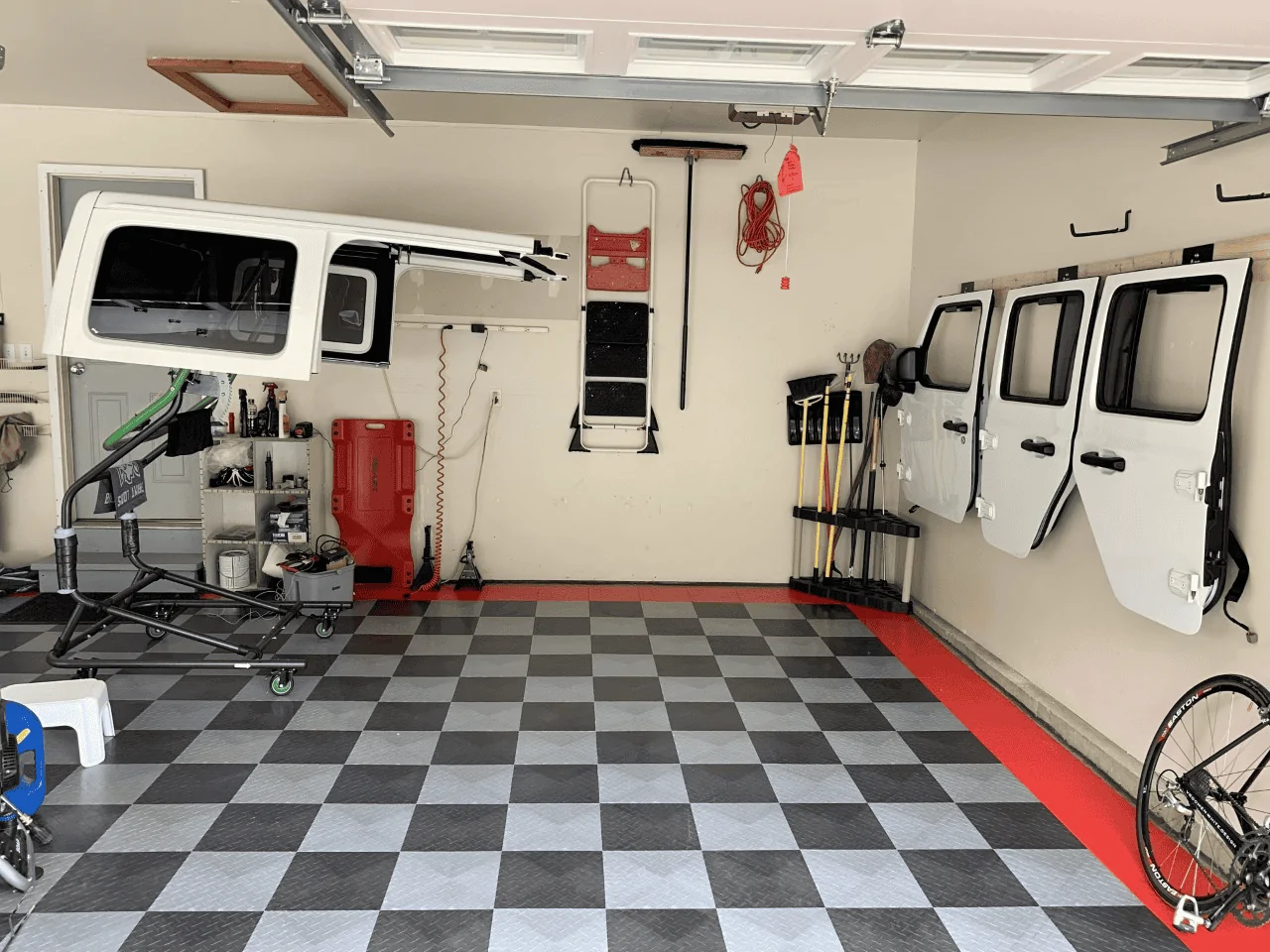

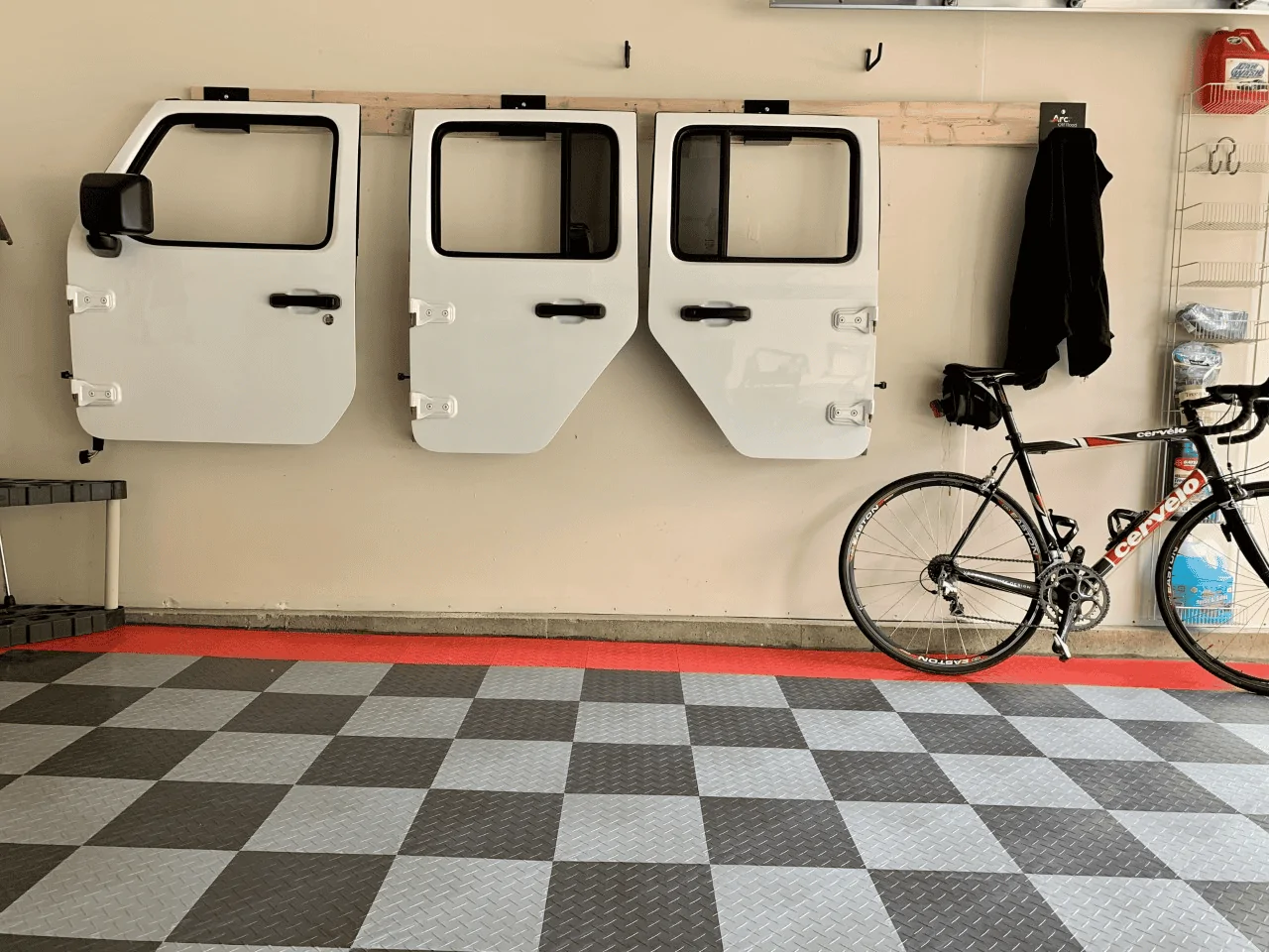

installed the ARC brackets this morning using the DIY tips provided on this thread. Thanks to hoag4147 and the others for the inspiration/ideas...

Look good ??. A tip on On using TLP. If it is an older version the bars on top are not open enough to miss the wider brace on JLs top (JKs were narrower). I cut mine because it didn’t set right in the rear. Also, if you can, leave back window open. It helps the top sit more level.

Dude... you're missing a door. Did your Jeep only come with 3?

how much space did you need between the brackets? looks good!
