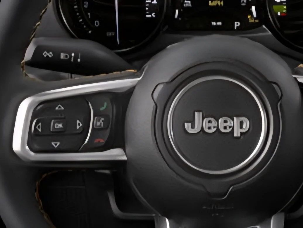

Press the button on the steering wheel to talk to it.
um, there's lots of buttons on the steering wheel, doubt any will let google maps voice come thru when i do directions
There's one on the left side of the steering wheel that looks like someone speaking. Push it.

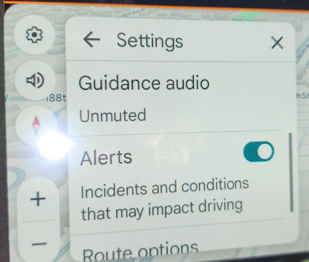

I've run into a couple situations that caused this problem for me. First was turning the Android Auto volume all the way down without realizing it. Restoring it required waiting for an announcement, noticing an announcement was supposed to be happening, and adjusting the volume during the announcement. I learned to force that by having AA read a string of messages to me.
The other thing that I ran into was guidance audio was turned off in the maps app on the head unit. That one's easier to find and fix. Open the maps app to full screen on the head unit, tap the settings/gear icon, and ensure the Guidance audio setting is set to Unmuted.

You have to press and hold the button for a short time in order to use Google commands.
press and hold which button?
i haven't come across this screen yet, will need to search where it is/how to get to it

See that speaker icon on the left there? Make sure there isn't a line through it. It may also be red? I'm not remembering specifically which it uses to indicate "muted." Otherwise, I agree with @ducttape. The AA guidance volume is probably turned down.
I should probably have clarified that the setting I mention is in the Android Auto Maps app, as opposed to the radio's native Navigation app.
