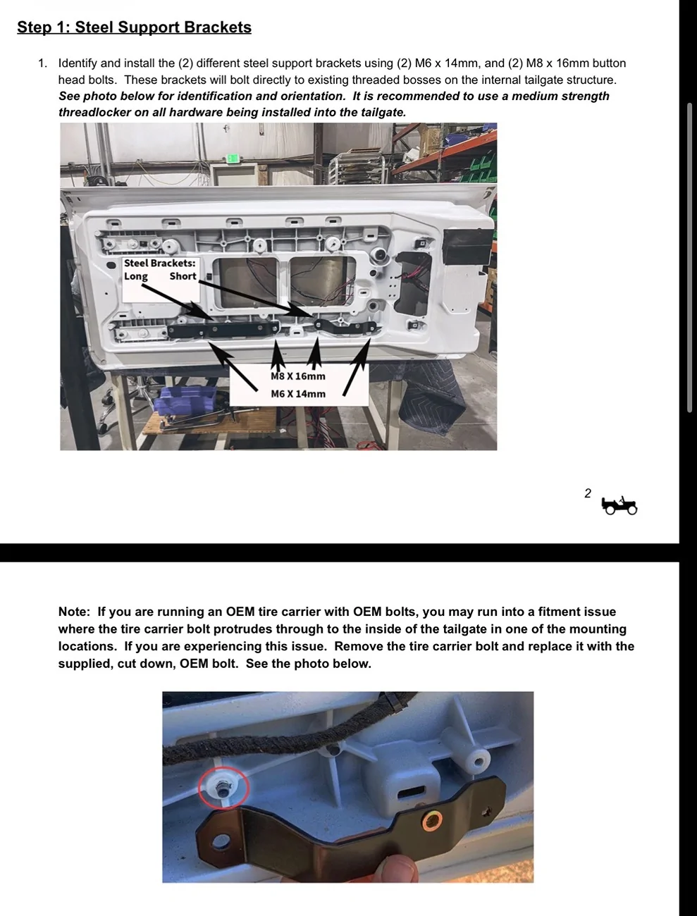

Has anyone just used an m8x16mm nut on the protruding tire carrier bolt for the VersaTable install?
The instructions tell me to take off the stock tire carrier bolt that protrudes thru the tailgate and to install the supplied shortened bolt…
was wondering if I could just leave that alone and use a nut on that already installed bolt with some blue loctite and call it a day.
seems like an easier option than messing with the tire carrier, especially since I have the oem 35’s.

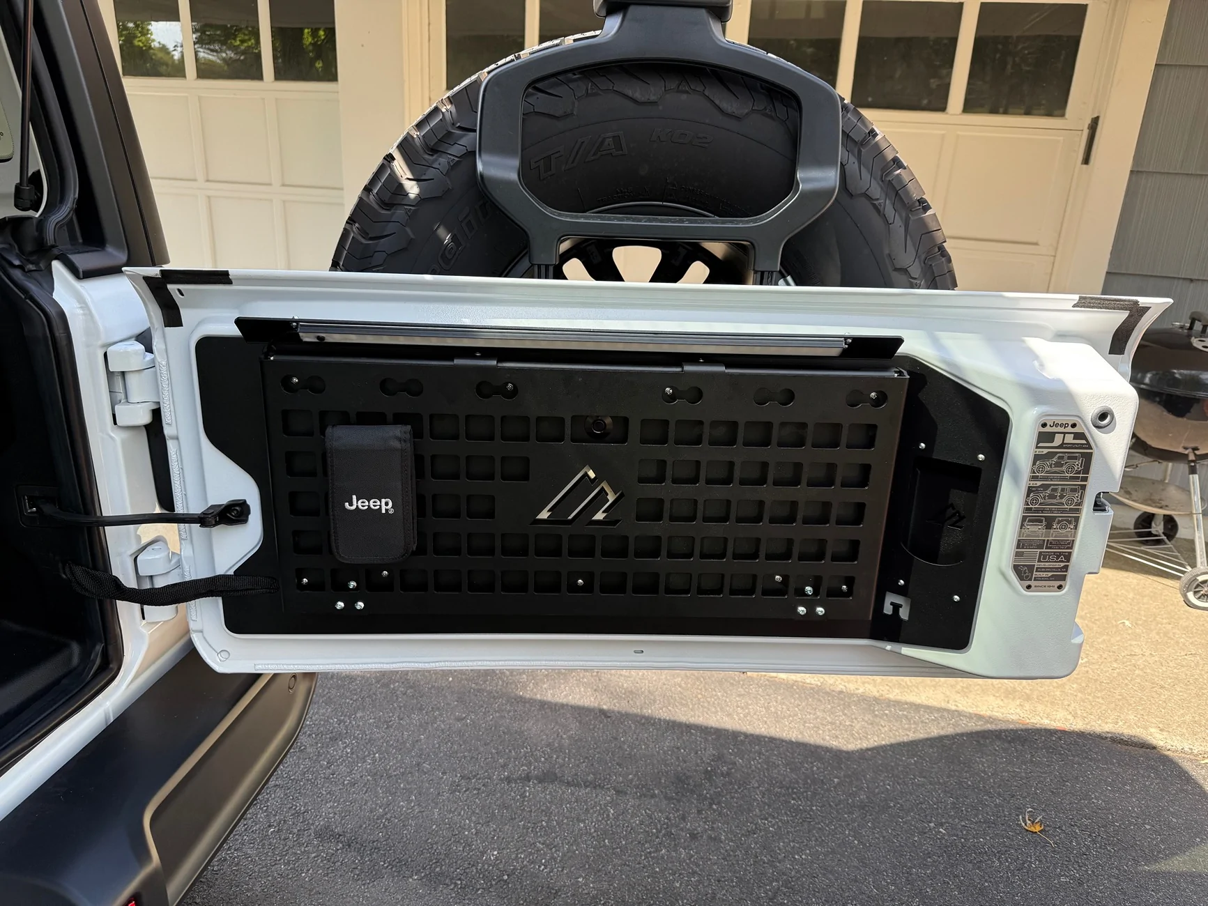

That’s exactly how I installed mine. Picked up the nut at my local Ace Hardware store. I love my Versa Table!

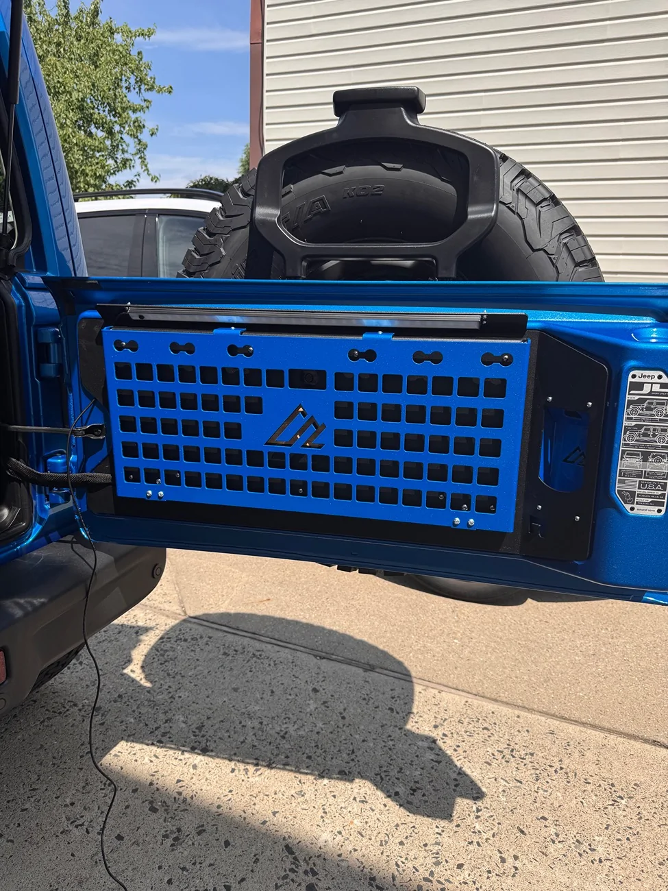

Awesome! Thanks so much for the reply!
Installing tomorrow on my day off! I got it powder coated HydroBlue

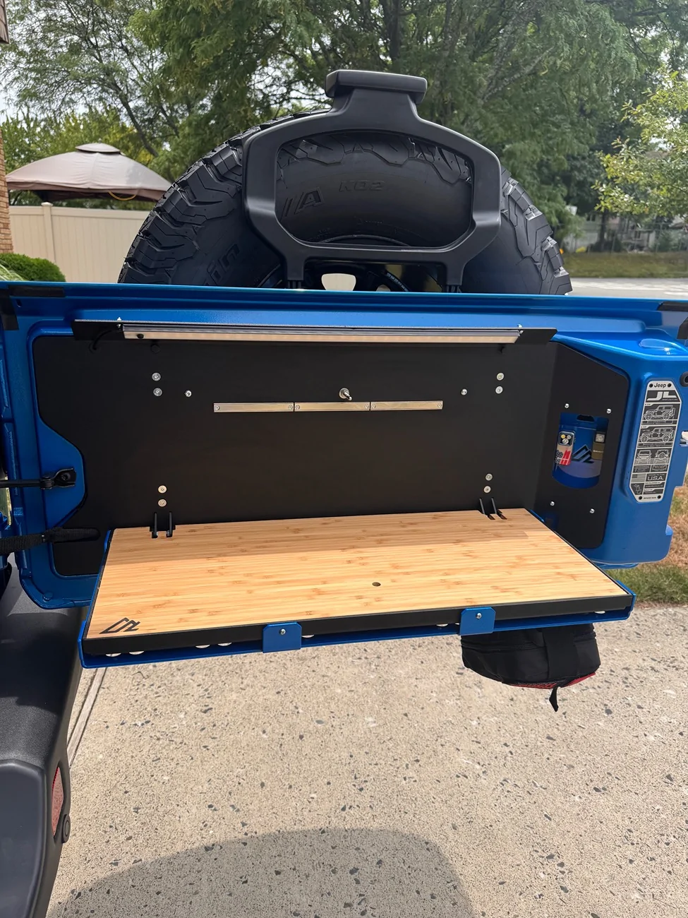

All done! Very easy…
used one of those lifetime tables and put it under the tailgate to use as leverage to get it on since I was installing solo.
very easy!

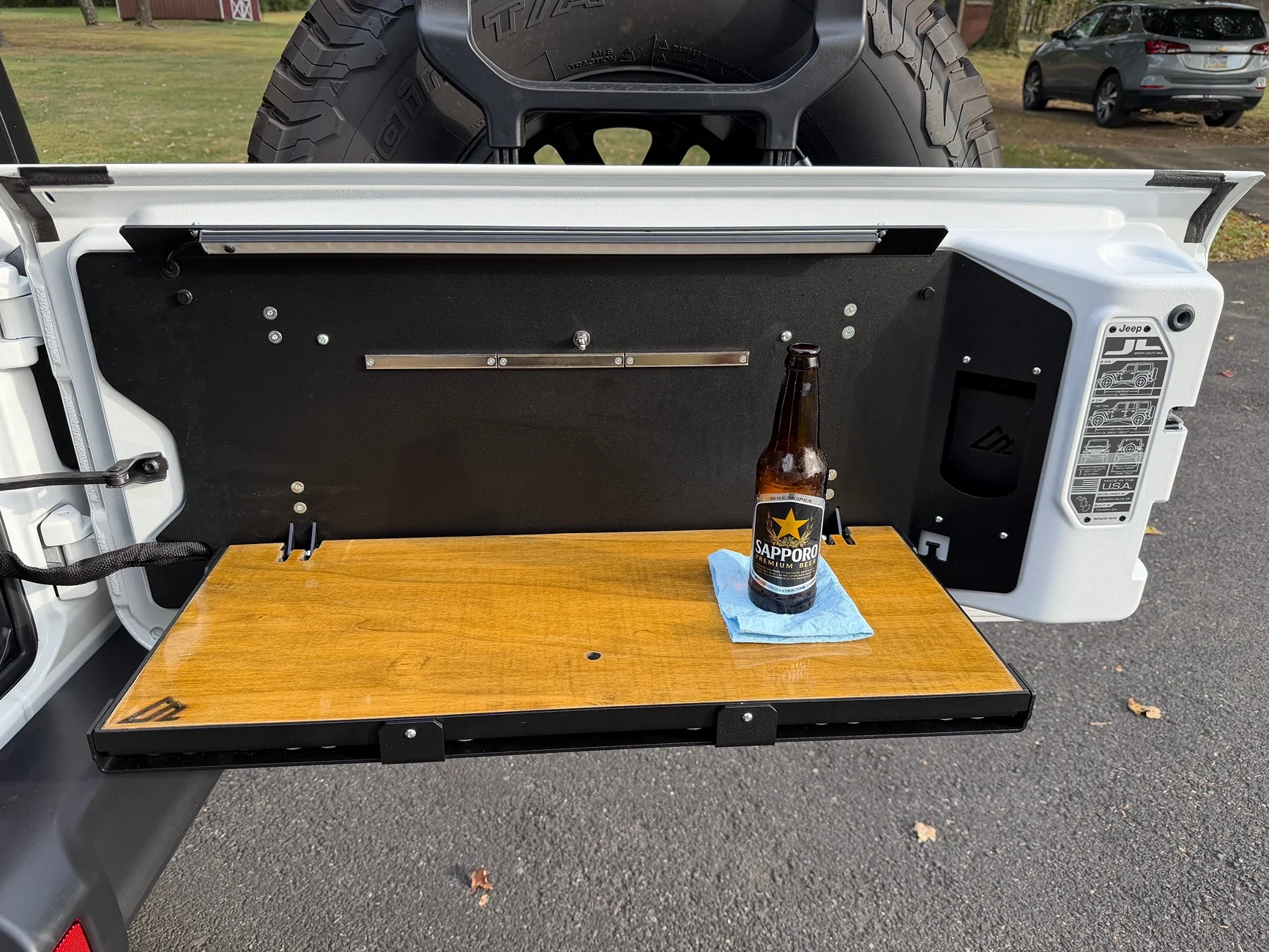

Table looks awesome especially with the matching powder coating 👊🏼
I see you went with the bamboo, if I was to do it over I would’ve done the same.
lol so funny you say that, when I saw your Poplar I said to myself maybe I should have gone that route lol!
the bamboo and hydro blue match well tho
I used a nut from Home Depot for 21 cents and installed the table that way. Worked just fine. Was not about to take off the spare tire and pull the bolt and do that rigmarole for nothing lol
