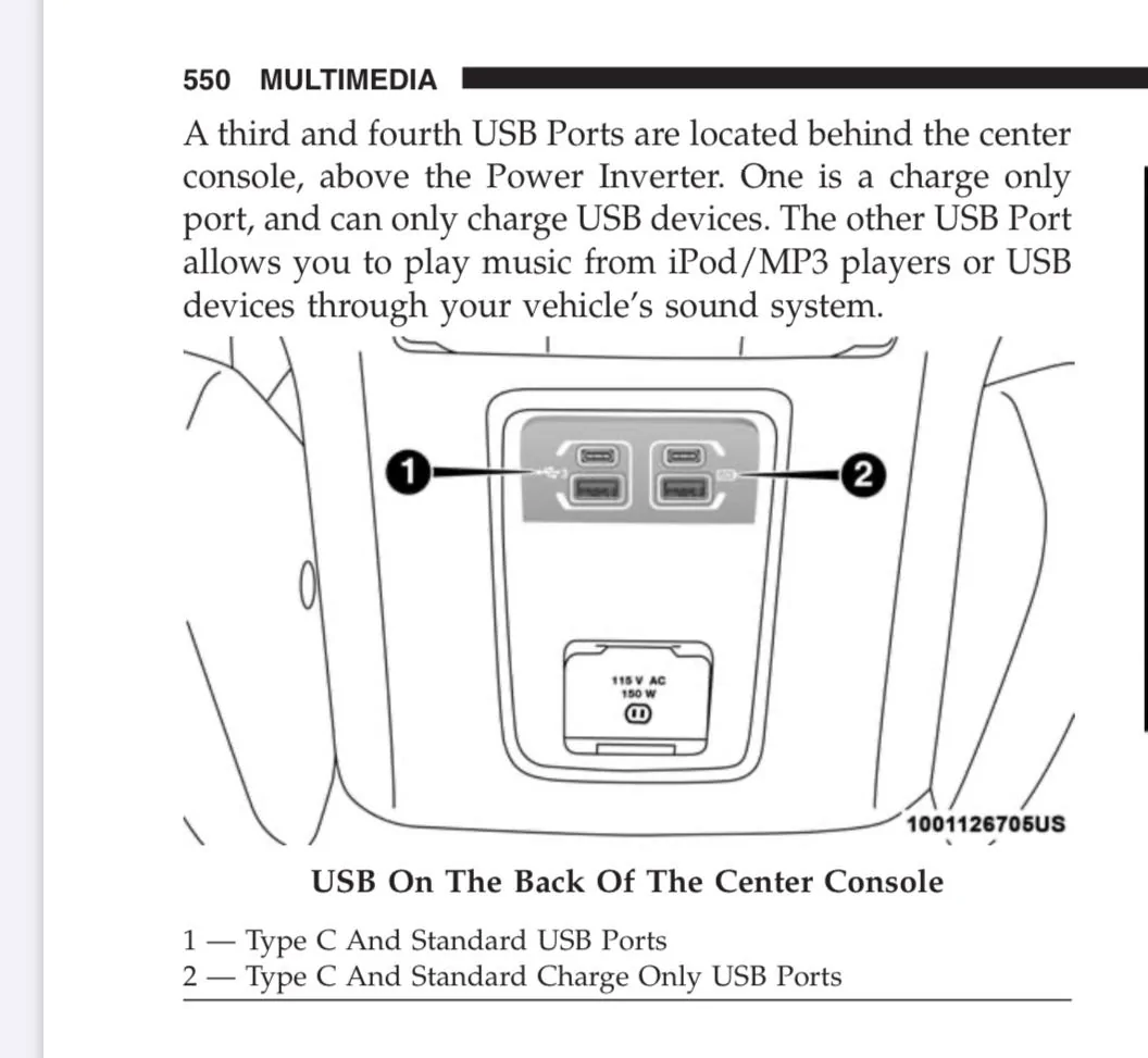

Can anyone confirm that Carplay should work from the rear seat USB3 port? My 1 and 2 work (2 is sometimes shady), but nothing but charge from USB3. Thanks!

Yeah I was aware of that. The one without the label is supposed to be charge only so I figured Carplay should work from USB3, but not on my Jeep.

So after about 6 trips to the dealer my USB2 is back to working with Carplay. So USB1 and USB2 activate Carplay USB3 works as an ipod but does not activate Carplay. Anyone know if this is normal?

I believe that this is correct, I actually just found a manual to confirm!
Jeep Wrangler JL USB3 Function - Carplay Q DA65C3A2-92ED-49AB-B354-1A1A40FA9F97

Thanks.
That USB2 behavior you describe was the same issue I had. Dealer says they replaced the wiring harness and rear media hub and now it seems to be ok. Previous attempts were two sperate software updates and replacing the USB2 port itself. Neither of those two worked.
