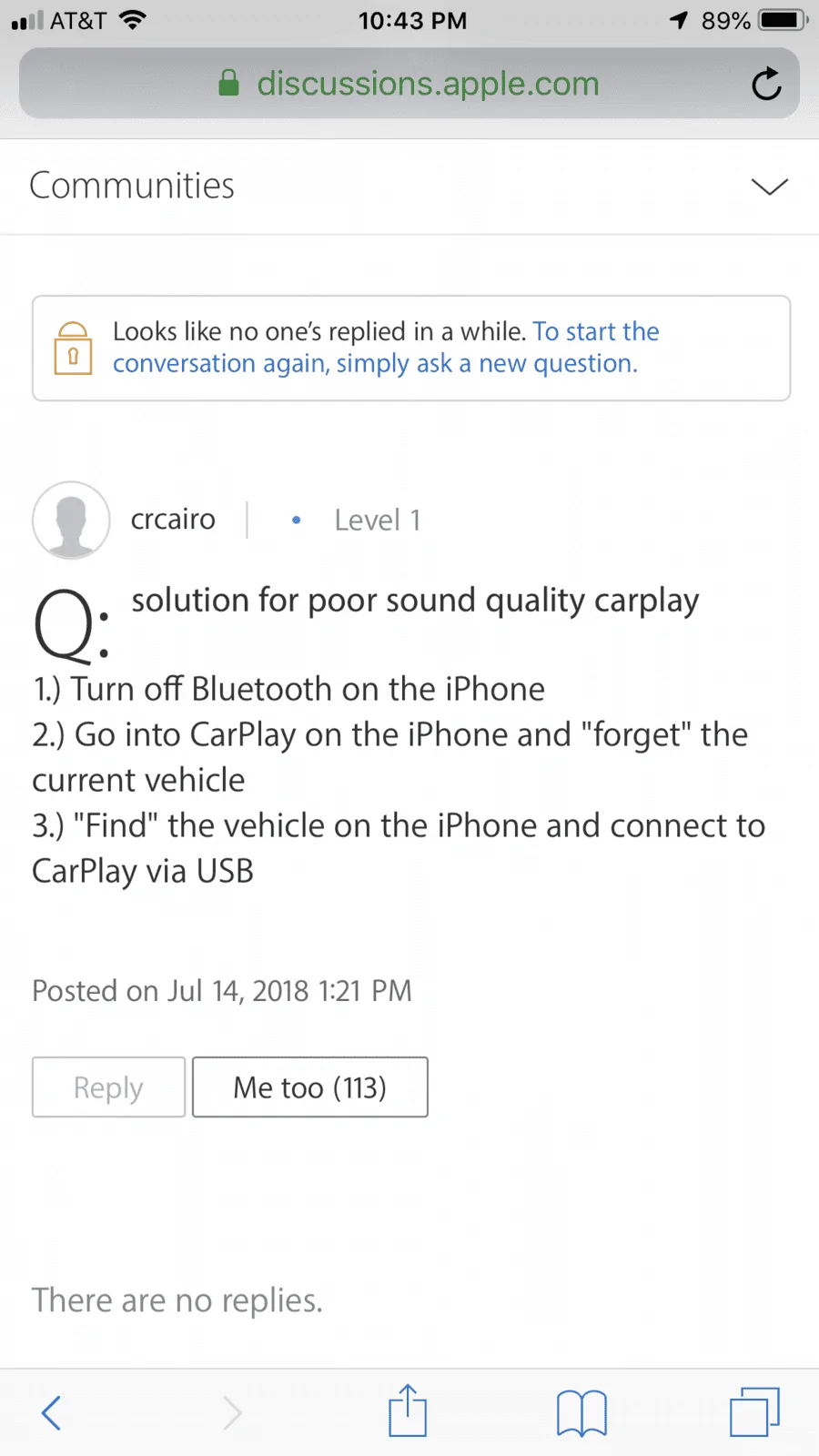

This improved sound quality 1000%. Not sure how or why but it worked for me.
I'm confused with step #3. Find the vehicle on the iPhone. In order to detect Carplay, Basically, I just have unpair and Pair Carplay?

DJGrooveD...amazing!! Just did this and although the phone connected instantly even though I opted to forget it, The sound came out like you said 1000Xs better ...could it be the bluetooth interferes?
