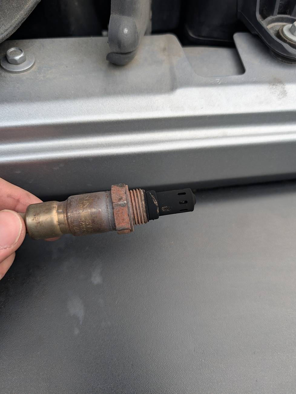

Finally brought this saga to an uneventful close.
Decided to try on a cold engine and used my new 18" 3/8 cheater bar with the offset O2 sensor socket.
Removed the engine cover to get some room, climbed up on the bumper to get close, and then just leaned hard on the bar. It made a *tink* as it broke loose and then it was loose enough to spin off with my fingers so no thread galling or damage.
Old sensor was black with soot which google-fu tells me is a rich running condition.
Jeep Wrangler JL Upstream O2 sensor replacement PXL_20250612_220419036
Be careful with the connector at the end. Use a small screwdriver to gently lift the red tab on the sensor end while you use your thumb to pull the red tab out a click from the engine side. When you go to press the now-unlocked release tab and pull the connector apart you're still going to need a screwdriver underneath the tab that your thumb pressure is supposed to be releasing because it's old and brittle. If you do it right it'll come right apart.
The new one was precoated with anti-seize so threaded it in by hand and finished up with 30ft-lbs per the average Google result for O2 sensor torque specs. Plugged in to the engine connector and put the plastic cover back on.
Started up like normal and went for a ride around the block with no new issues. It hasn't thrown that original code since January so will probably have to see if that was actually the fix next winter.
