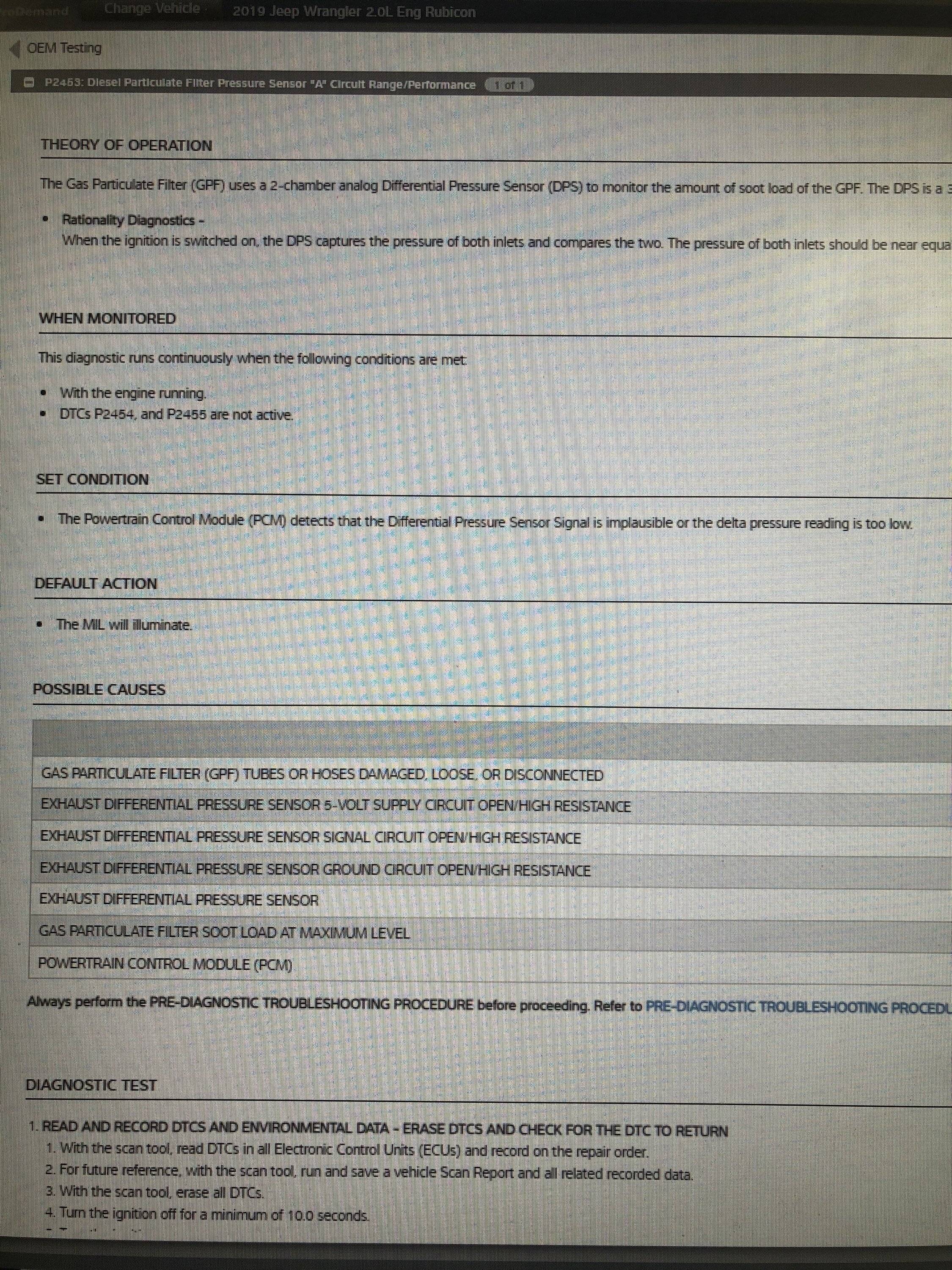

with one other one diag box ( french one) Capteur de pression du filtre Ă  particules"A"plage/ performances du circuit
= Particulate Filter Pressure Sensor "A" Circuit Range/Performance

They didn’t rename the PID for some reason. It’s applicable to the 2.0.
Hi @mwilk012
Thanks a lot for your answer, it will help me so much.
I will try to fix the pb with the possible cause test..
I bought a new sensor, I'll see if that does anything..
I dont understand how and why my Jeep garage dont tell me that and wwhy the do nothing...
Thank a lot
(if you have other tips thnaks in advance )

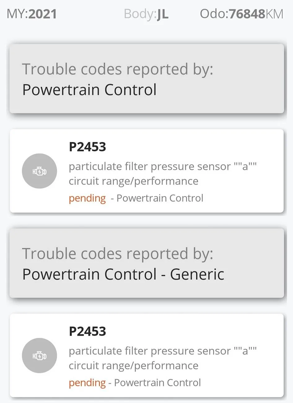

Greetings from Poland! Thanks for sharing your experience and the way you solved the issue. I'm experiencing the same error popping up in my JLUR and I'm thinking about ordering this part as well.
You mentioned the video. Are there any chances you've recorded one ?
I'm having hard times finding some drawings with location of that sensor and the idea how to access it. May i ask you for some assistance with the picture where it is marked and you advice how to approach exchange of that sensor ?
I would highly appreciate!
And one more thing. I see you qre using JScan. In mine i have only "pending" and no "active" error as you did. Any ideas with that ?
