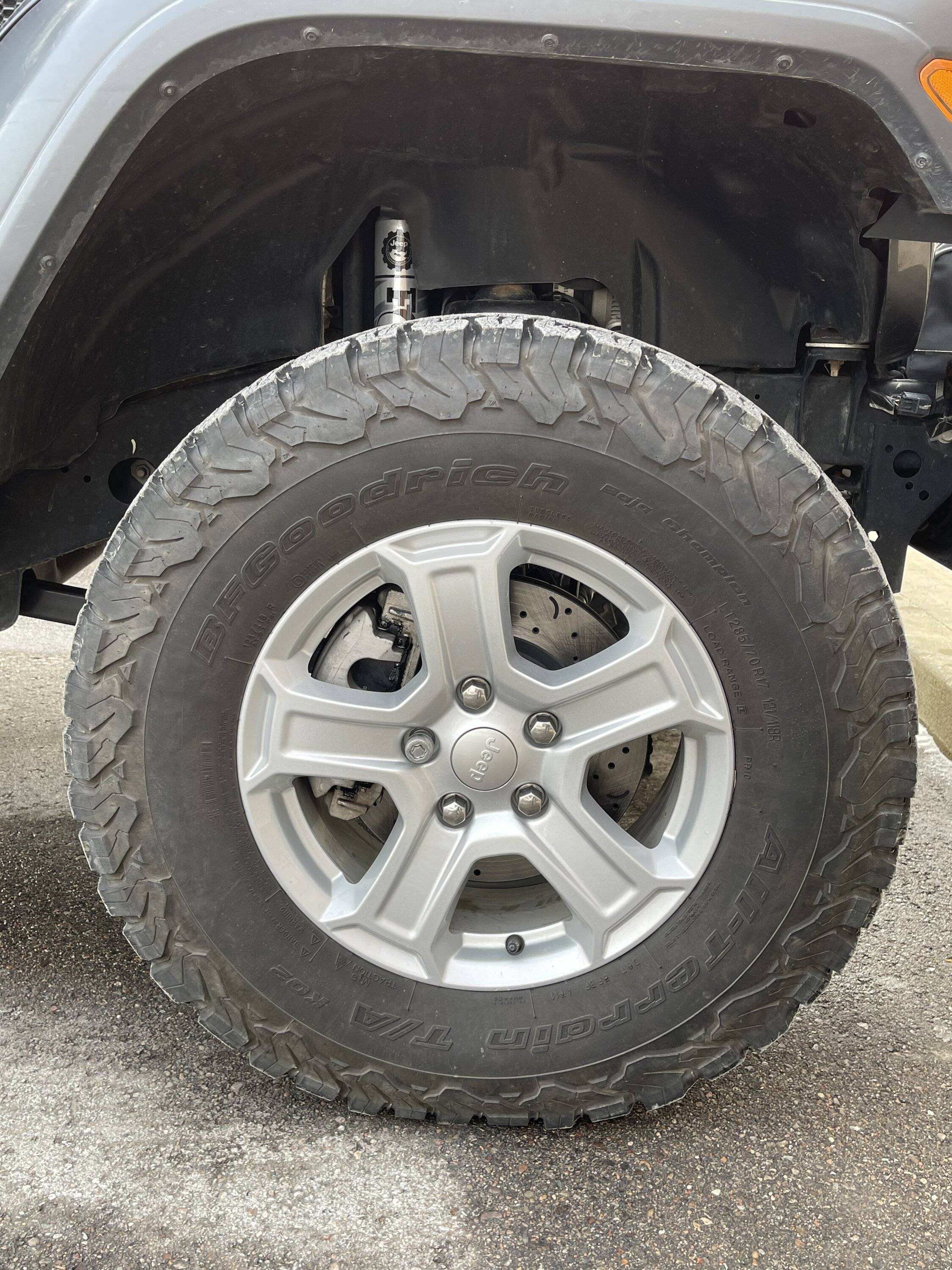

I haven’t gotten them back from the shop, hopefully Saturday. One thing I didn’t realize is how noticeable they are from the rear, even inside the wheel well. I powder coated mine gold like the front tow hooks but they really look nice in the back and add to the aesthetic. Hopefully I have additional great stopping power too, will keep you posted

Never realized how much of the brakes you could see from the rear. Visually much more appealing. Will post pics this weekend

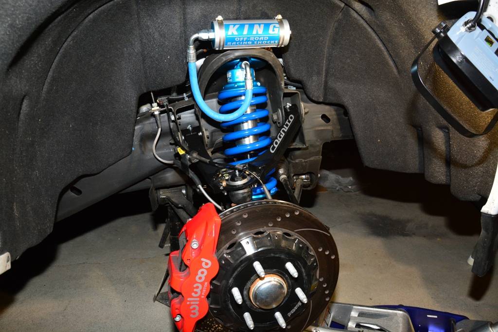

2" pistons x4 is over 12 sq/in of piston area (or 6 sq/in as it is commonly quoted for one side of the caliper only) on the fronts
1.375 pistons x4 is almost 6 sq/in of piston (3 sq/in as commonly quoted) area on the rears
Both of those are huge and on that alone has the competition beat.
Combined with the 14" rotors and these brakes should stop extremely well.
BTW, the front caliper piston area on the Teraflex Delta is 16% larger than my Wilwood 6 piston set on my GMC 4x4 Crewcab, which specs out at 5.4 sq/in, and that truck is maybe 1000lbs or more heavier the way I have it configured.

Looks like a nice setup there, have you been happy w/ the braking performance?
