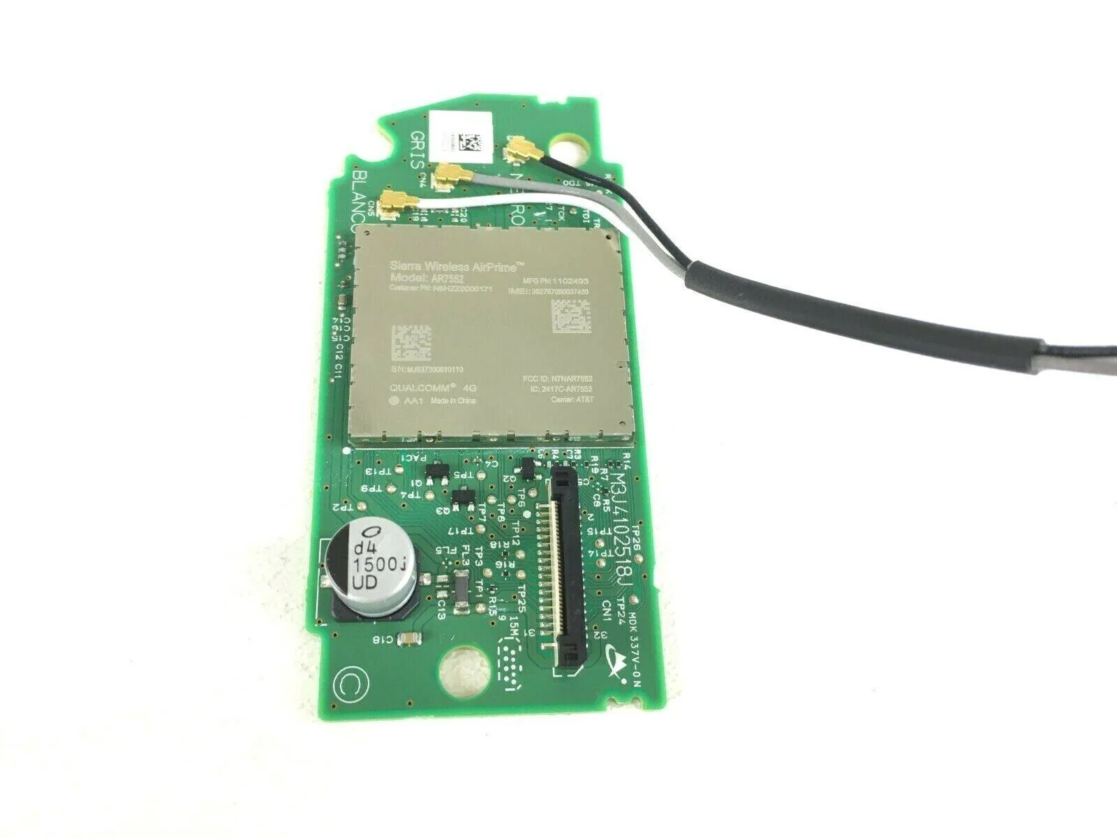

The UConnect 8.4 radios don't use a SIM card. They use a carrier-branded aircard specific to AT&T and I'm unaware of an aftermarket or carrier alternative.
Jeep Wrangler JL Updating SIM card on the UConnect Unit? s-l1600
Wonder if it would be possible to just use a 3rd-party AT&T MVNO like Red Pocket (their GSMA option). Think they sometimes allow locked phones/devices since it's on the same network.
Might be worth a try to see if they'll allow it and if not, maybe it's possible to buy an unlocked AirCard and replace the factory one with that (ie, foreign/grey-market version of same/similar card with same band support). Though using a different brand/model might run into problems if it's not on AT&T's device whitelist, even if using an MVNO.
Dunno. Just some ideas.
