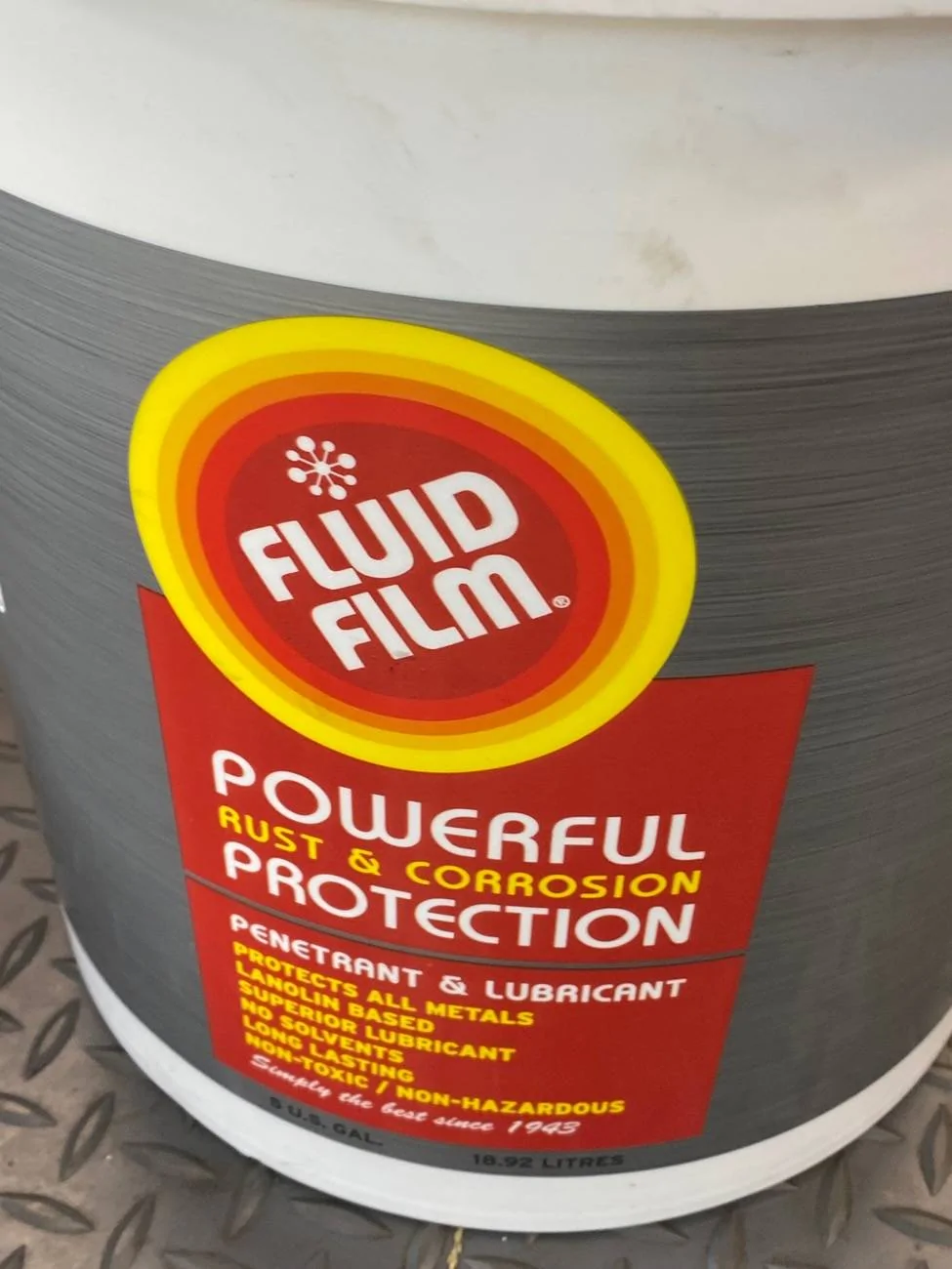

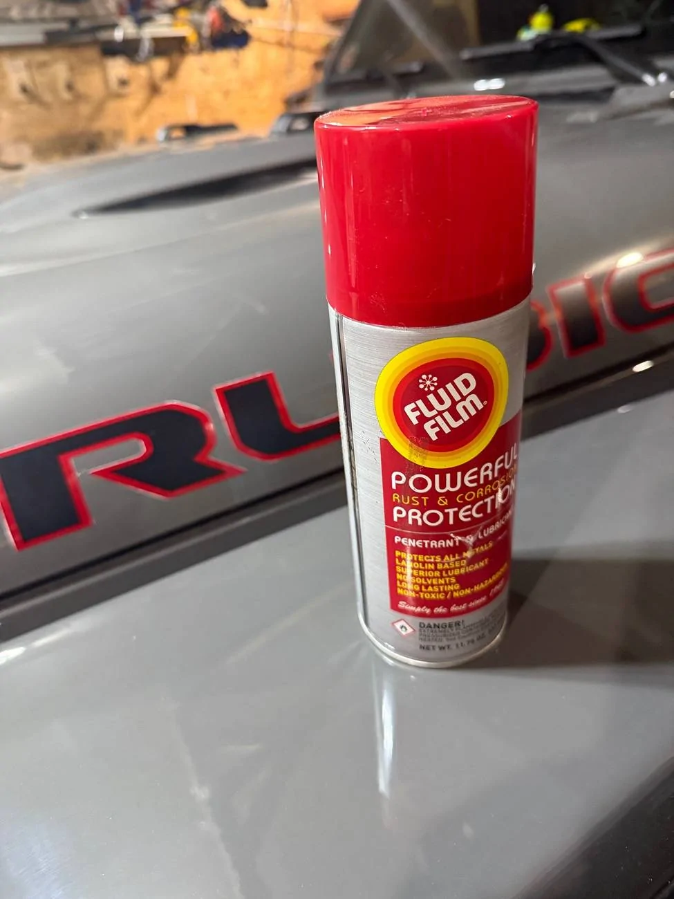

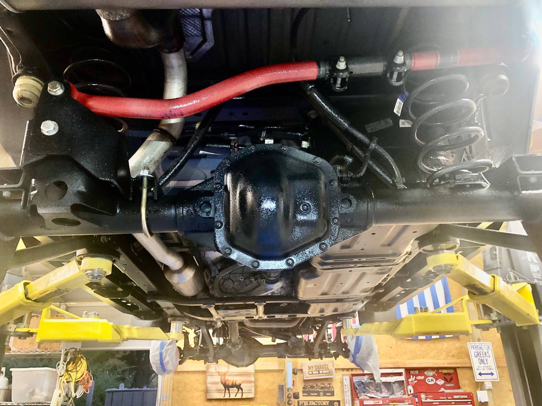

I discovered this four years ago when I bought my new jeep but didn’t want to have it professionally undercoated because years later when it starts to crack, salt will then get in those cracks and stay there, I spray it anywhere I don’t want rust to start, like inside of my aftermarket steel bumpers, the whole area underneath the jeep where salt can get thrown up and sit, guys it works and only takes about one and a half cans to cover it, this doesn’t stay on permanently but seems to last long enough to get through the winter!
Your County garage probably uses this on all their plow equipment.

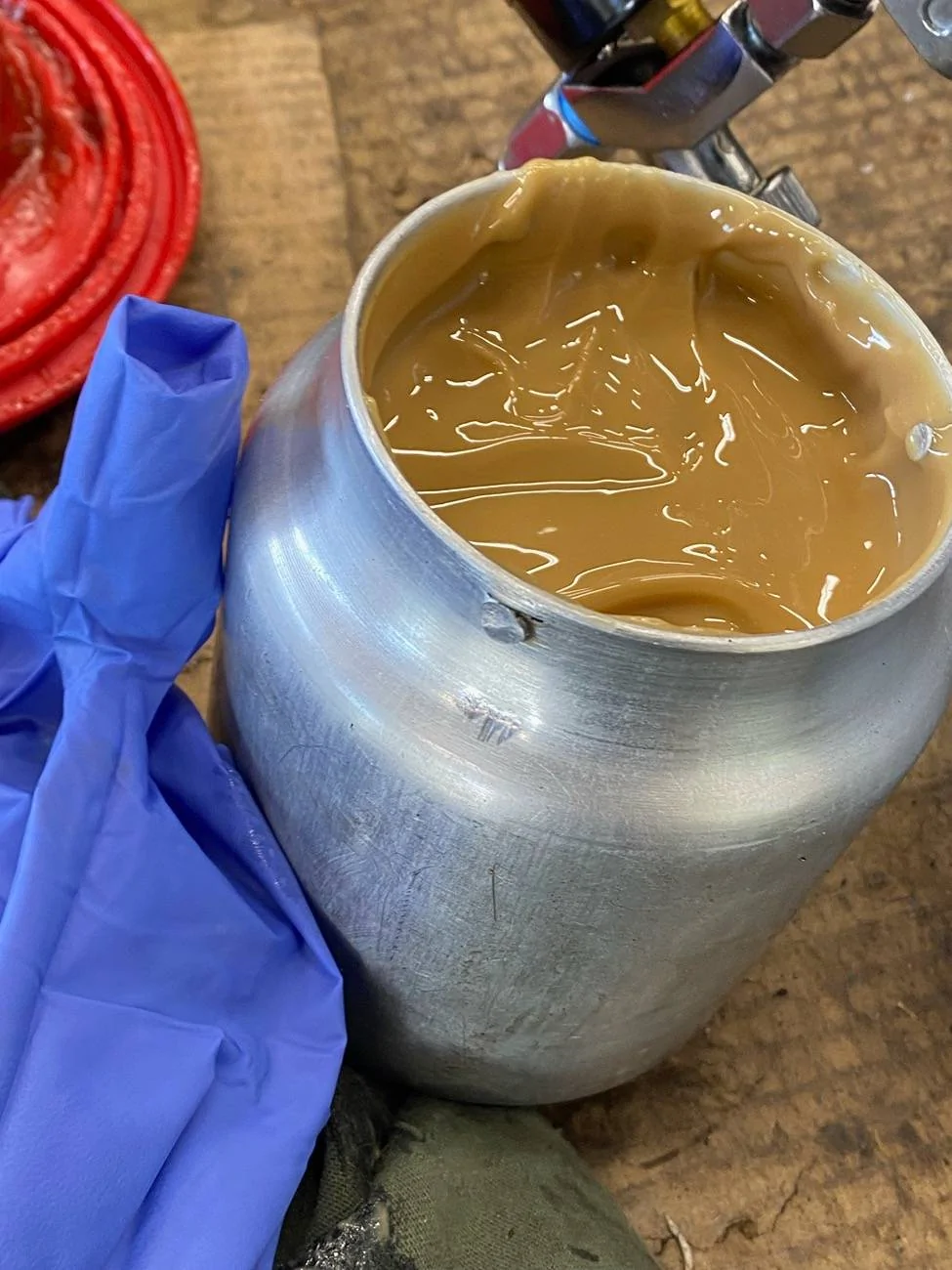

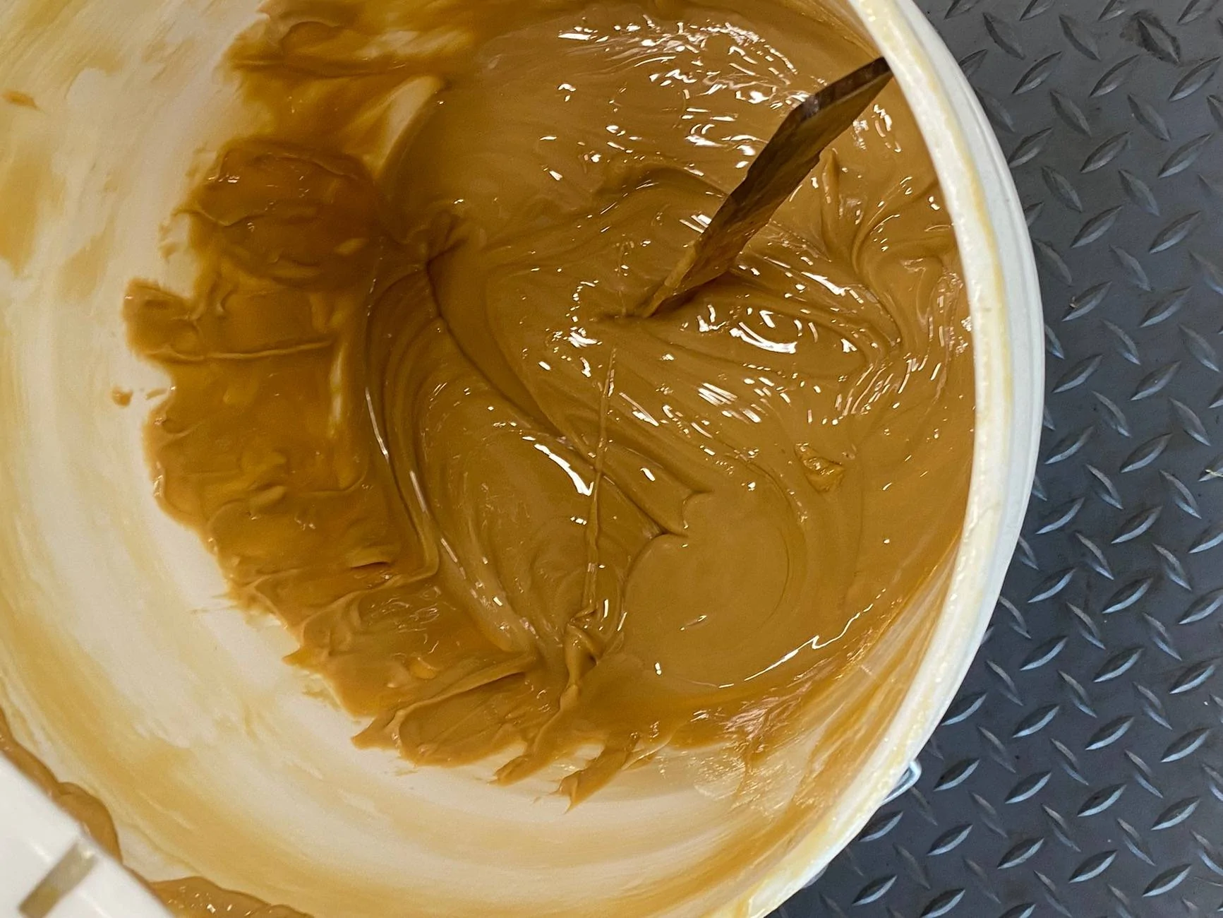

I did 2 coats of Amsoil HD Metal Protector when I got the Jeep.
This year I sprayed Fluid Film Black using an undercoating gun, easier than cans and cost 60$ for a gallon which will do 2-3 vehicles. Its a greasy mess underneath but I rather deal with that then rust
I bought a gallon can and an undercoating gun several years ago. I've done probably half a dozen applications between my truck and Jeeps, and still have, maybe, 1/4 gallon left.

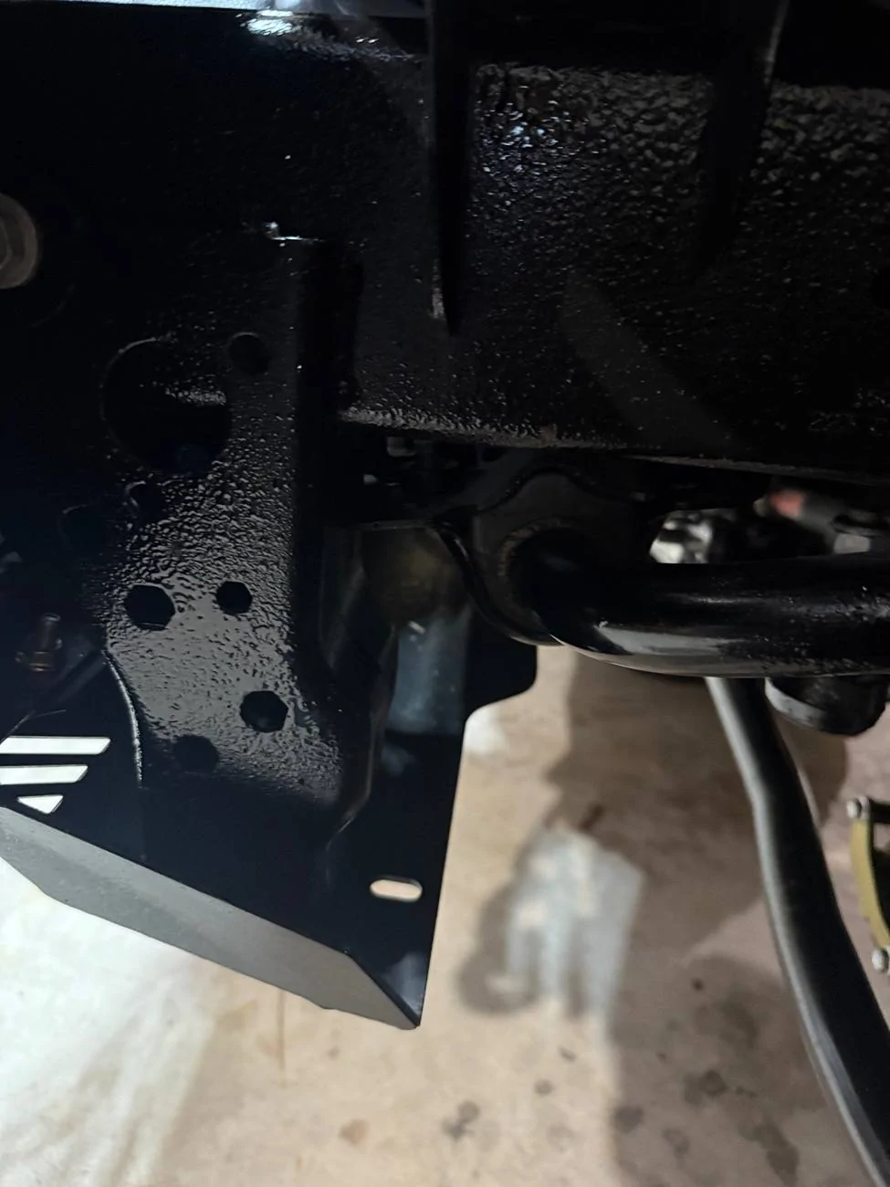

I don’t have any good ones except for these from last year. Bottomline, over the years the film has built up but doesn’t fully dry. Take a rag to it and wipe the build up off and your find shiny metal underneath.
