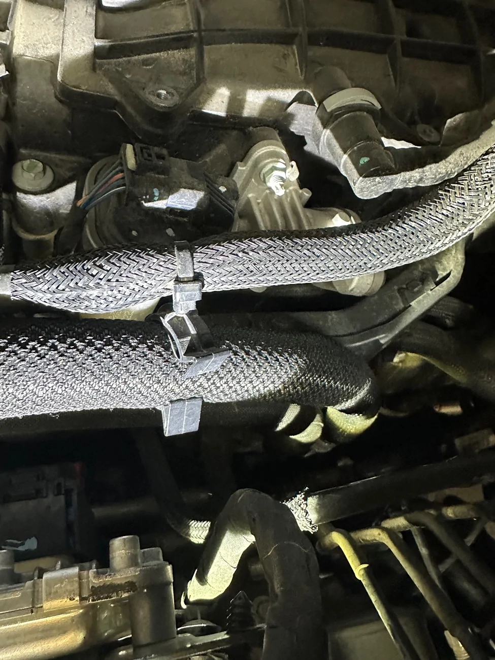

Jeep Wrangler JL Unattached clamp on drivers side engine bay IMG_0583

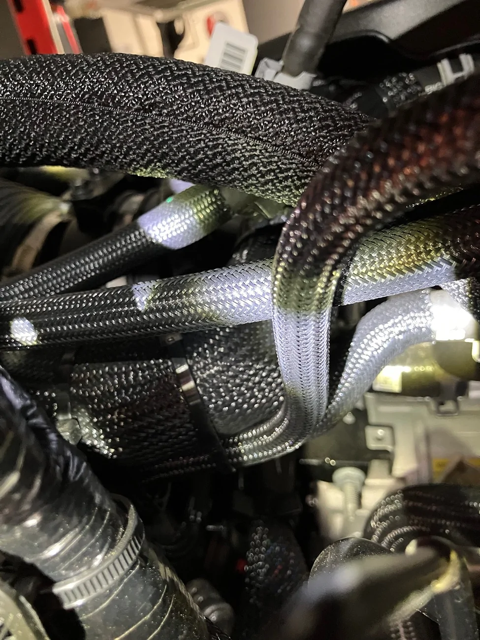

There is a round clamp that is not attached to anything. It is on the drivers side of the engine bay. Does anyone know what it connects so I can reconnect it. Thx

Just a wild ass guess since I don’t have your engine but I have several hoses or wiring bundles that connect together with two clamps and a stand off between them. The impression in this rubber sleeve makes me think there may have been the other half of that style clamp there at one point. Or I’m 100% wrong.

Thanks! Maybe someone with the same motor can post a picture.

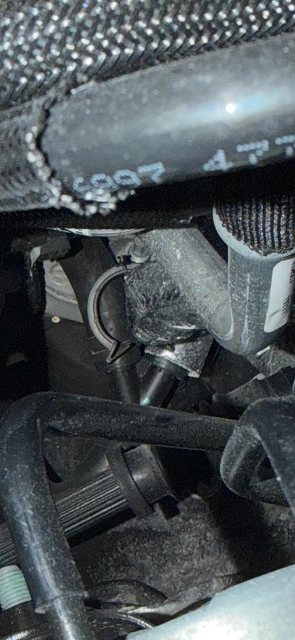

I checked mine it looks like it is attached up that hose a few inchs, the heat sheild covered hose. Looks like it is in there to keep the hose from touching cat converter. May be able to reach up from the bottom and reattach if you cant reach it from the top.

I checked mine it looks like it is attached up that hose a few inchs, the heat sheild covered hose. Looks like it is in there to keep the hose from touching cat converter. May be able to reach up from the bottom and reattach if you cant reach it from the top. I will try to take pic if you need it, its obscured by the hose that comes out of coolant tank and curves down by the cat and then to firewall.

Could you please send me a quick picture of yours. I can’t for the life of me figure out where this connects. Thanks!

i will stick my phone up in there and get a pic tommorow. on your first pic there is Y under clip its supposed to be on the bottom hose and would be obscured in that pic, up that bottom hose a few inches. thats where mine is anyway.

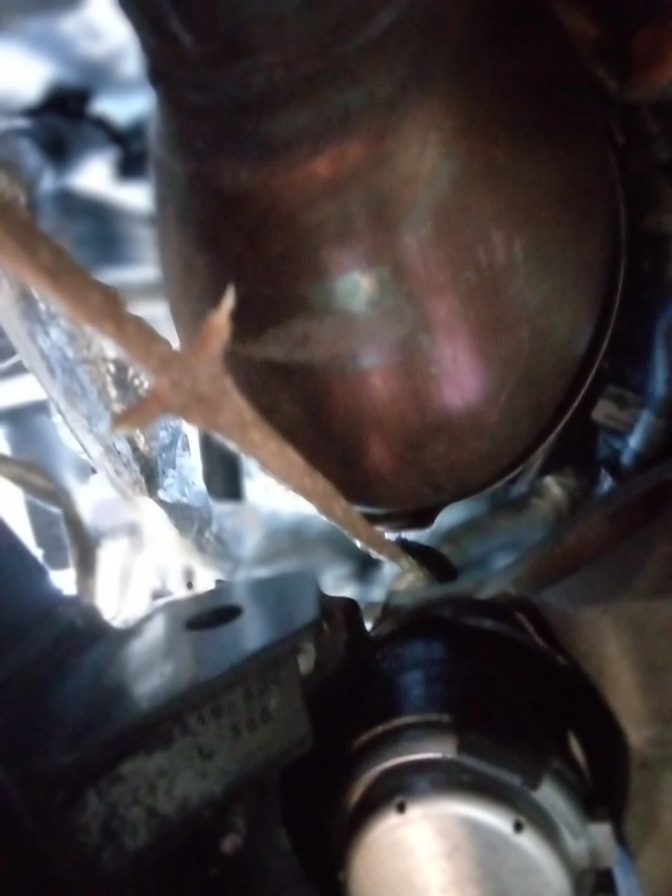

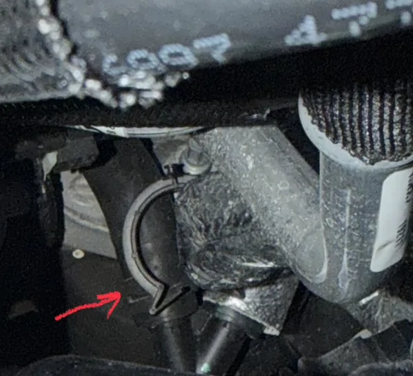

I took pic from the underside, its blurry so i tried to point with stick, hold a light, and take pic at the same time. I noticed from the top the hose has a metal holder with nut and bolt and this plastic clip is few inches up the hose from it, you can just see parts of it from the top. Hopefully it helps.

Thank you!!!!!!! This helps.
