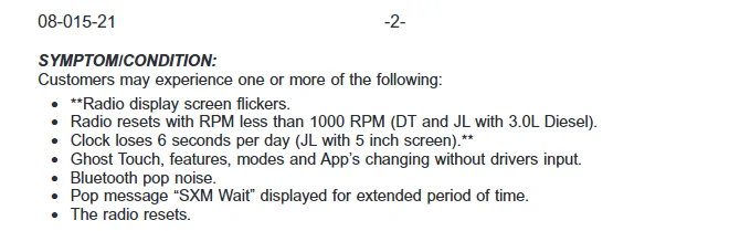

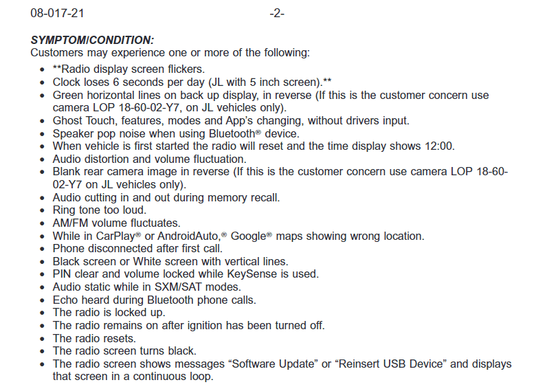

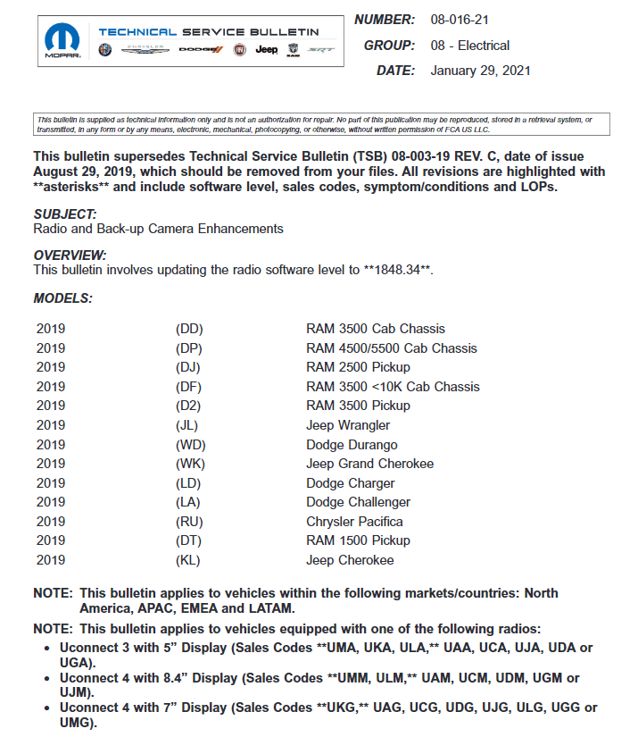

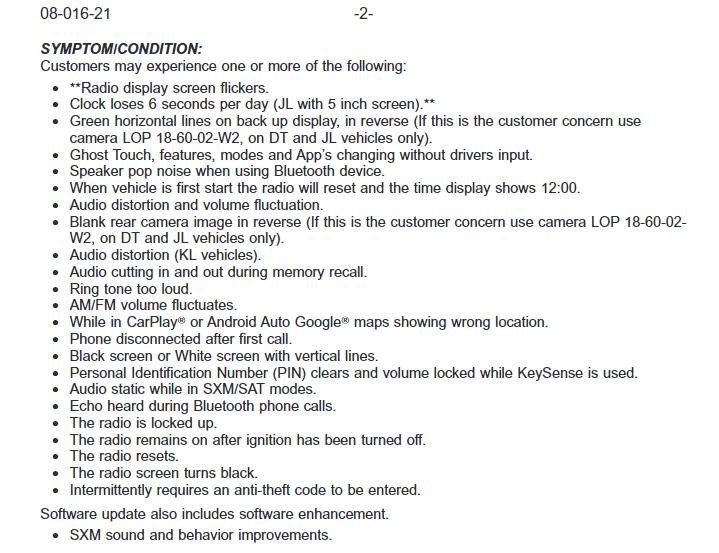

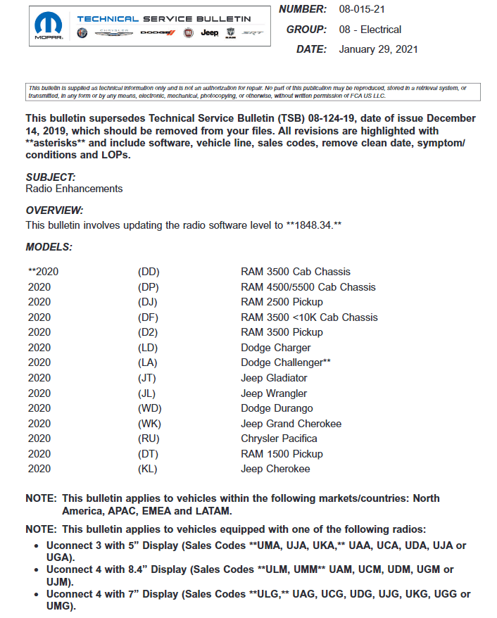

Hi everyone, Recently there were three Technical Service Bulletin (TSB) that appears to address concerns similar to the symptoms that you are having with your vehicle. To ensure these TSBs apply, we would like to get you back into the dealer to have a qualified technician review the details of the TSB and the specifics of your vehicle. Once reviewed, the technician can then perform the repair procedure that best matches the symptoms and diagnosis of your vehicle.
08-017-21 for the MY18
08-016-21 for the MY19
08-015-21 for the MY20
Please let me know if you have any questions!

Here are all of the TSBs. Please let us know if you need any assistance.
Thank you,
Lydia
Jeep Cares
08-017-21 for the MY18:
Jeep Wrangler JL Uconnect 7" screen flicker 1612888476891
Jeep Wrangler JL Uconnect 7" screen flicker 1612888493252
Jeep Wrangler JL Uconnect 7" screen flicker 1612888515918
Jeep Wrangler JL Uconnect 7" screen flicker 1612888532663
Jeep Wrangler JL Uconnect 7" screen flicker 1612888568914
Jeep Wrangler JL Uconnect 7" screen flicker 1612888582405
