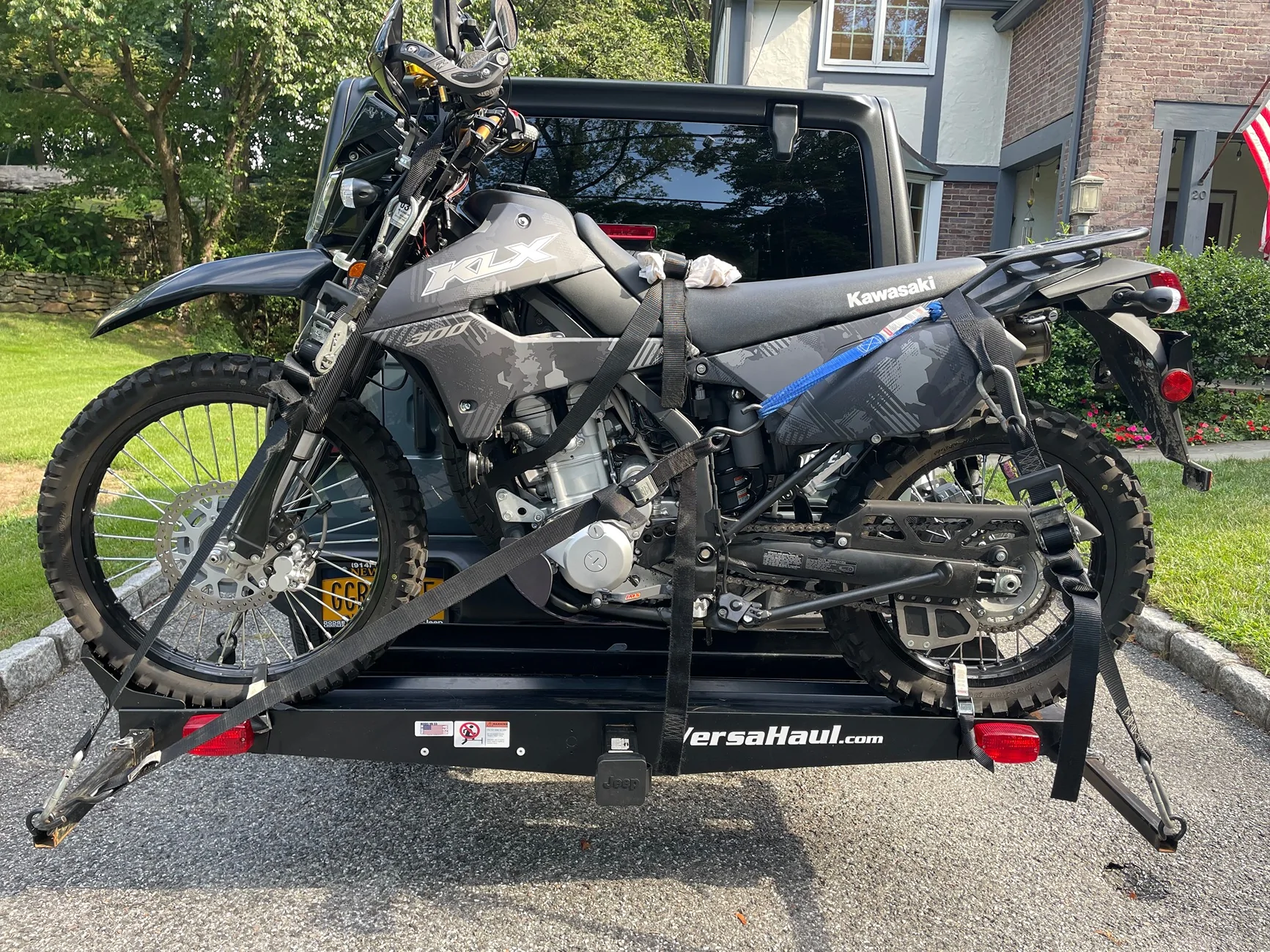

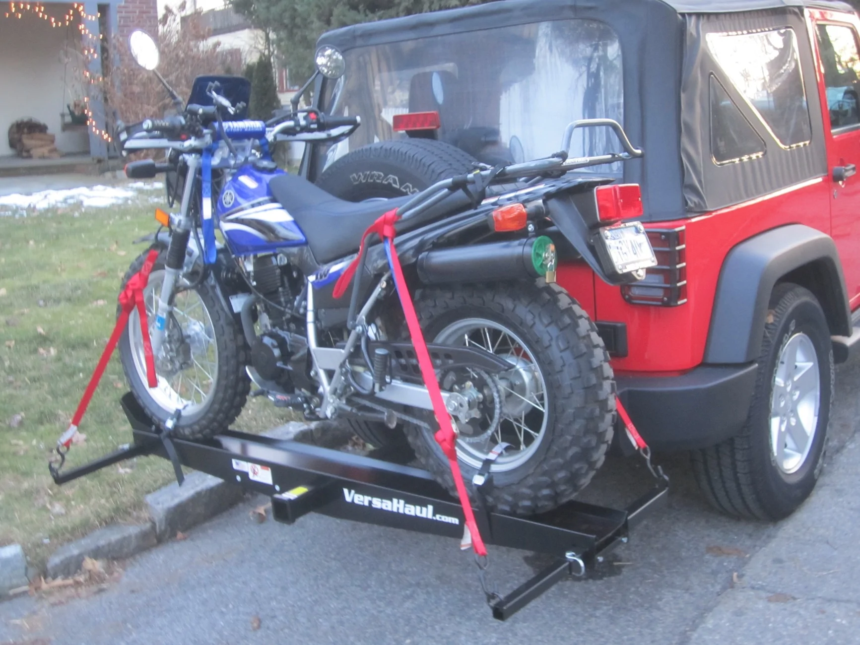

Almost the main reason that I do own a JL is off-road capability. Not the Jeep itself but to tow and/or bring my 2 and 3 wheelers to the woods. And sometimes when things go wrong... to retrieve them.
Let's start with the OP's question and specific to a TW200 which weighs approximately. 275ish lbs. Absolutely no problem at all. Previous to my current '25 JL and previous '19 JLU and when I was not towing a trailer (bringing a buddy-bike) I always used my MC carrier for my TW200 as well as a xr250L (260lbs). No real feel in any kind of handling at all. But using common sense that yes indeed, "something is back there".
Currently when solo riding I'm using my Versahaul (very heavy) carrier for a KLX300. And that bike is 300lbs. You need to add the weight of your bike and the carrier. My Jeep is stock so no need to worry about anything but if I was going any heavier of a 2-wheeler I'd upgrade the shocks.
But for a TW200, you are very well within the green-zone.
When owned a 2-door Wrangler (the picture with an actual TW on it) you'd definitely notice the headlights pointing upwards. Thus the JL, never a problem.
I prefer the carrier even though the time to tie it all down and make safe takes longer than the trailer. But here in NY where I live many of the "Parkways" as opposed to streets/roads and highways are prohibited to commercial traffic and any kind of trailer commercial or not. I guess it does make them a nicer drive but a PITA when I do sometimes take a chance with the MC Trailer (a Kendon) or a boat.
Jeep Wrangler JL TW200 & Motorcycle Hitch Carrier IMG_4743
Jeep Wrangler JL TW200 & Motorcycle Hitch Carrier IMG_2048

I should add that after pulling up the ramp under power and shutting off in gear it is nice that there is just a bit of space to lean the bike into the spare tire, thus freeing my hands to deal with the tie-downs and straps. I do straighten and adjust so it is NOT leaning on the tire when driving. But I do (you can see it in the KLX picture) throw a strap around the bike and thru the spare as an added safety for added stability. Probably overkill but most of the trails I ride and camp at are over 100+ miles away. After the first 20-30 miles I don't notice that I even have it back there at all.
