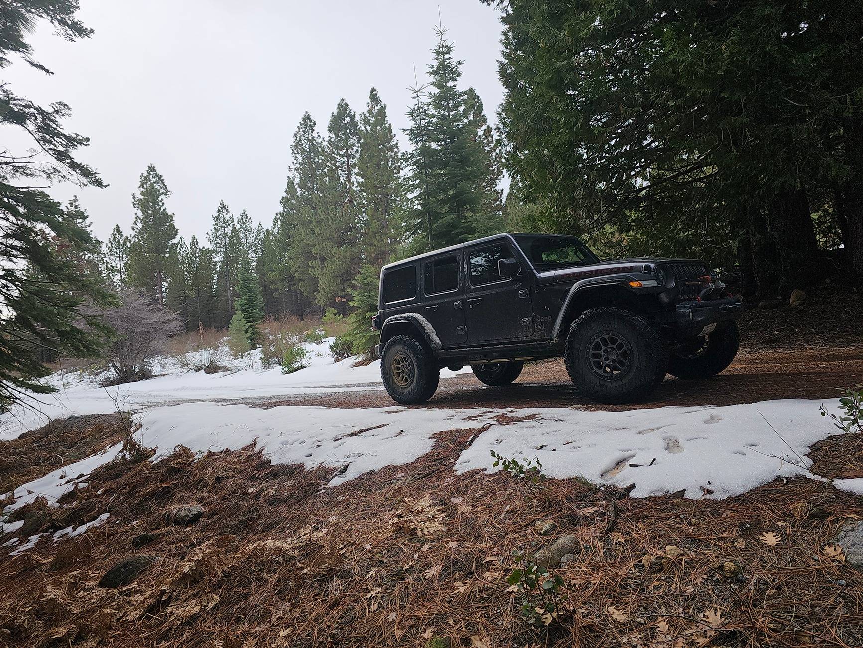

I think it's too individual based on actual tire diameter, wheel offset, and varied bump stop heights. We run 39s on the wife's JLUR with no trimming, but I added a 1" bump stop up front and 2" in the rear in addition to the XR packages already extended bumps. It very lightly rubs the stock plastic fender liners at full stuff but doesn't rub the pinch seem which is all most end up trimming. With some trimming and new liners I could gain an inch of uptravel, but it does great without it.
