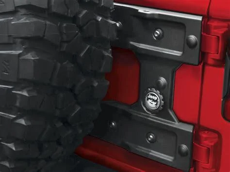

Drago is getting some mounts in soon, probably going to order one. I asked about install instructions and they said it's just a simple bolt on (so, no instructions). My Mopar reinforcement has caps over what I presume are the accessory holes; anybody know if they just pop out? Look like they are just plastic caps but I haven't tried to deal with them yet. I don't want to have to pull everything if I don't have to.
Oh, and thank you @John VonJeep as Chief Enabler and Spender of Other People's Money (in addition to his own).
The caps do pop out, but be a little careful because they like to break off with part of the body still in the hole.
Thanks, that was my guess, and for the advice. I managed to break several fender liner plastic push pins working on the skid plate install, d%#$! plastic everywhere...

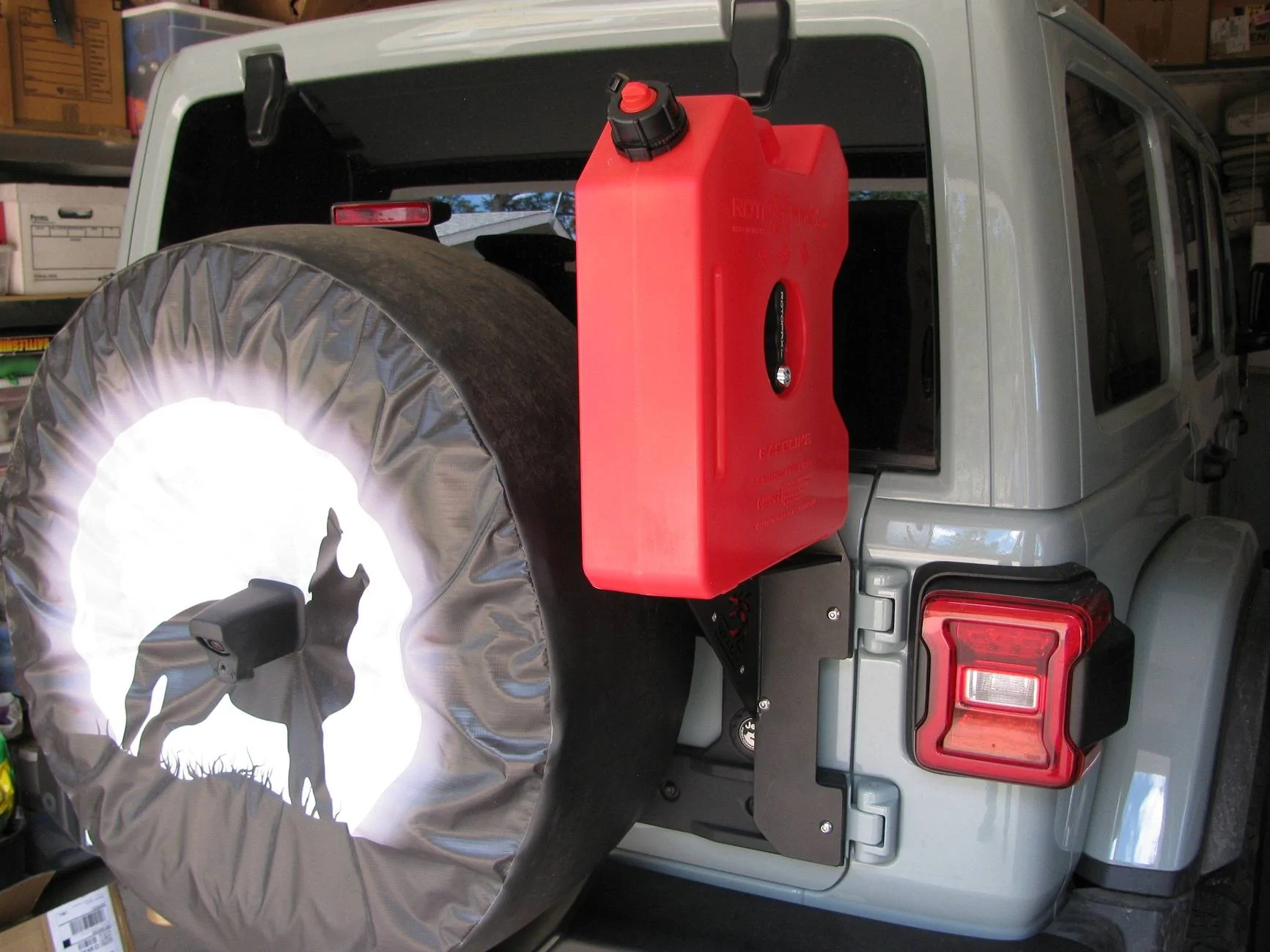

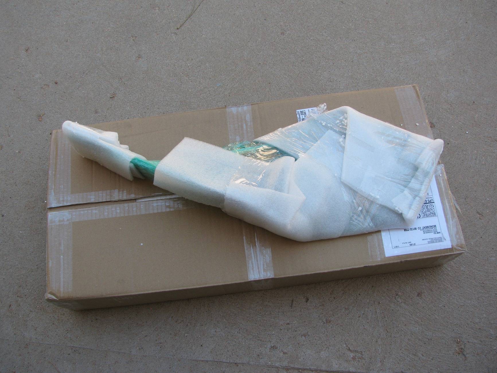

Got my mount today! It was incredibly well packaged, with styrofoam pieces inside the box, and the mount itself well-wrapped in soft foam and then plastic film. Started putting it on and noticed the directions (and pictures on the Drago website) do not mention nor show the handle mounting plate that comes with the Rotopax Lox Mount kit; you mount the handle directly to the Drago carrier. Not a biggie, but could have ordered just the handle and saved some bucks.
I got the first pushpin out of the tailgate with my little plastic pry bar set, then broke the heads off the next two. :( After some futzing, I discovered using needle nose pliers on the stub I was able to just spin them out like backing out a screw. Duh! I could have pried just enough to get a grip on the rim of the pushpin heads and simply "unscrewed" them. Would have been much faster.

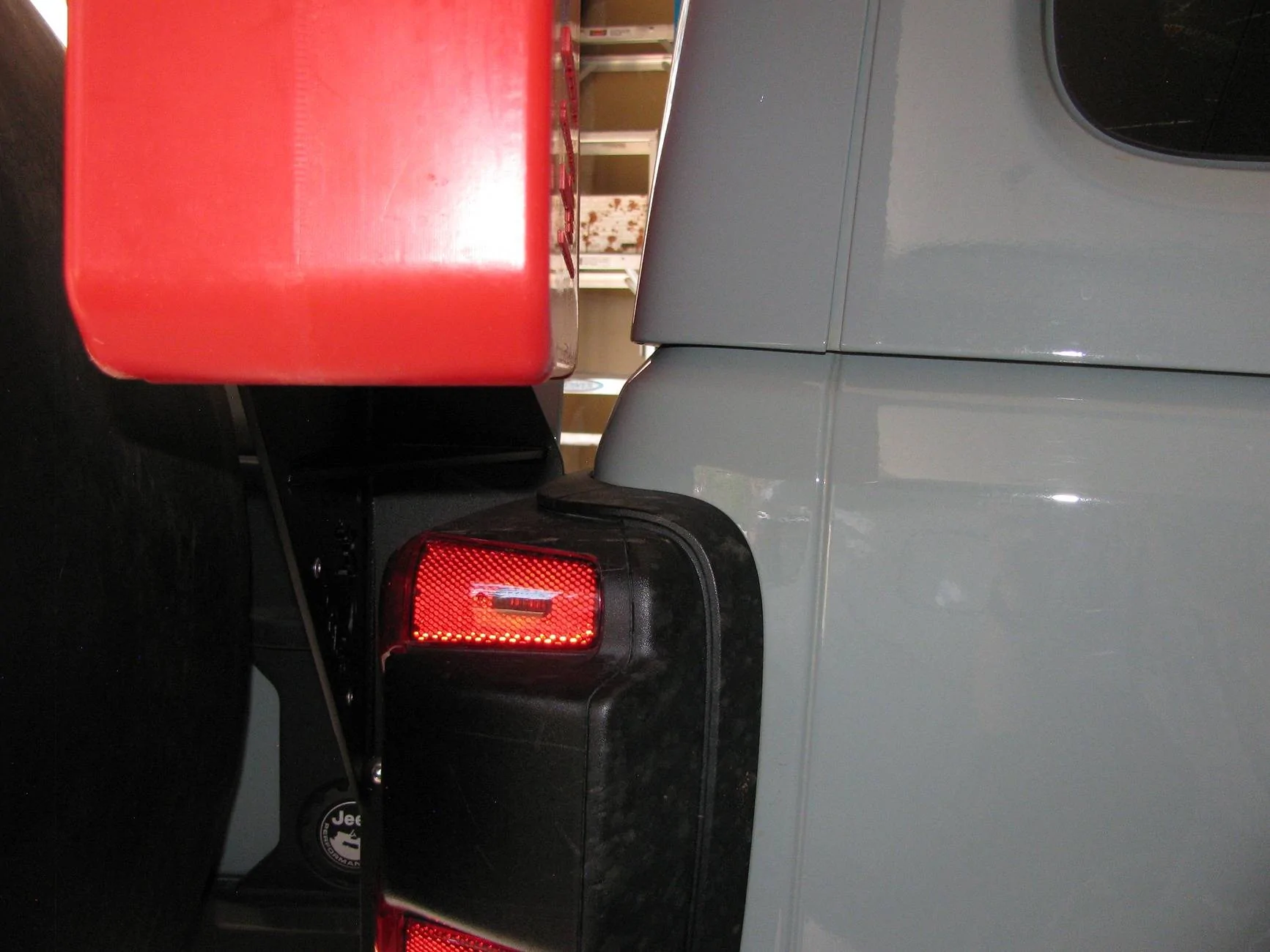

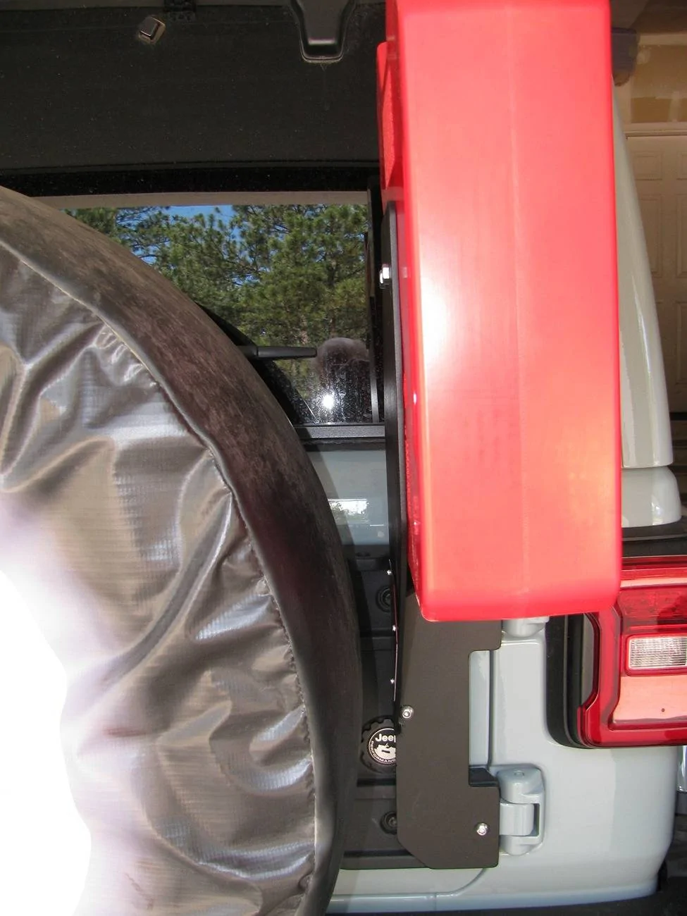

Install was easy after that. Drago had red Loctite on their mounting bolts, and I added blue Loctite to the Rotopax handle bolts (I have red but hate to use it unless I really need it). The mount clears the door and tail light on my 392 XR with an inch or two to spare when the tailgate is all the way open, and a 3 gallon Rotopax can clears as well. Only rattles are from the Rotopax lock; may see if a piece of friction tape will help, but they advise leaving it off except when needed so not a biggie.
Happy camper!
Took a bunch of pictures, pasted a few below for fun.
Well packaged!
Installed, ready for the gas can.
Showing clearance from mount to tail light with tailgate full open.
Clearance with the 3 gallon gas can mounted and tailgate wide open.
Jeep Wrangler JL TrailRax - Pak Rax IMG_7423
