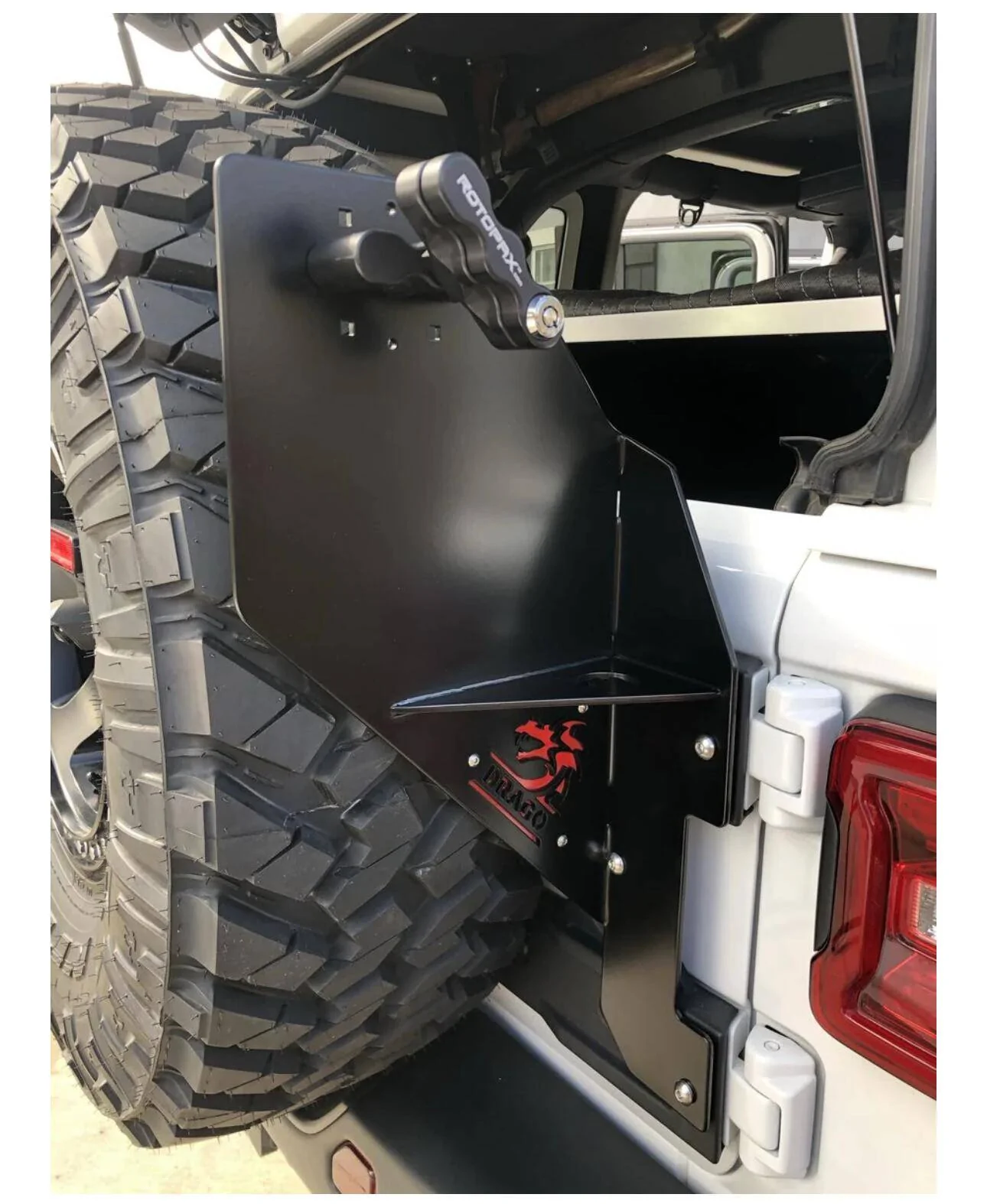

I really like my Drago mount. It’s well-fabbed and fits within the existing garage-footprint of the Jeep.
https://dragojeepproducts.com/products/rotopax-mount-holder-bracket-for-mopar-tire-carrier
That looks great! I know a couple of others I saw would not work with the Mopar reinforced tailgate mount, so this looks like a winner. If I have the mount with the accessory holes? Or is that a separate thing? I'll have to look at mine.
Edit: I have the holes, have caps on them (I think), so thinking I'll get one of these. Sent them a note; is it Al or steel? Didn't think to ask if they have a discount, though their site lists a 20% off Memorial Day sale (nothing off on this mount, however).
Is there anything between the bracket and mount to prevent rubbing/scraping/squeaking? I did not see instructions on their website, nor if it comes with mounting HW.

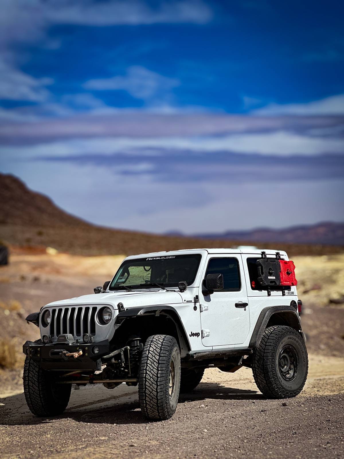

I have the setup on both Jeeps and never had an issue. I don't keep the Rotos on unless I am carrying gas and I installed PPF where they mount to the lips. The locks rattle like mad but I don't have them on either unless I am going to be away from the Jeep with the Rotos installed.
All in all, I don't really use them much and I just have 1 installed on the Driver's side of both Jeeps because I think they look cool.

Drago is getting some mounts in soon, probably going to order one. I asked about install instructions and they said it's just a simple bolt on (so, no instructions). My Mopar reinforcement has caps over what I presume are the accessory holes; anybody know if they just pop out? Look like they are just plastic caps but I haven't tried to deal with them yet. I don't want to have to pull everything if I don't have to.
