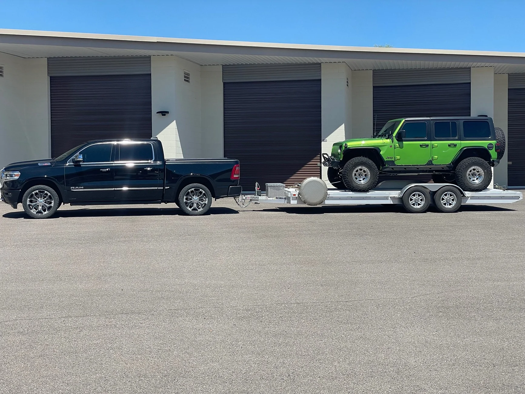

Looking for suggestions for trailering a Jeep behind a pickup camper.

I'm looking at tire straps right now and I think that may be the best tie down method. A search on etrailer.com shows 109 pages of them, but none are right. Most are for 30" tires, a few go up to 33" tires, and I found one that can be used on tires up to 37". I need them for 40" tires. Any brand names to help narrow it down?

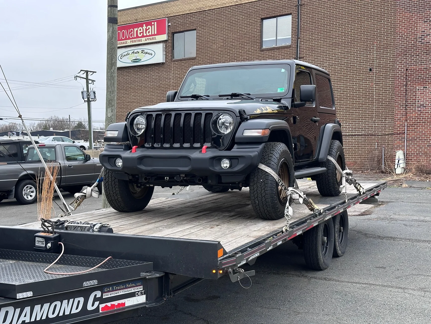

Get some axle straps, attach to the axle outside the shocks. Having 1 attachment point on the axles and one to the trailer is best.
Jeep Wrangler JL Trailering my Jeep.  Help me do this right. gOfJ2PIl
Straps front and rear to the axles is enough, though when hauling any distance I will use an over the tire strap to keep the tires tight to the trailer, no bouncing on rough roads. Your tires fit nicely between the fenders so this would be less of a need.
I just got back from a 1200 mile trip and my Jeep did not move even a little and many of my miles where on poor Michigan roads.
Jeep Wrangler JL Trailering my Jeep.  Help me do this right. LXP08BIl
  • Like

Your front is pretty suspect looking. Make sure that those straps aren't touching anything remotely sharp or square. Under tension, it doesn't take much to cut them.
Always hook below the suspension, unless absolutely necessary. Above the suspension will constantly yank on the straps and mounting points. That shock loading from the constant yanking will put more stress on everything.
I personally use axle straps from RhinoUsa around the axles. Let those take the abuse vs my straps. Plus they have an extra abrasion sleeve for more protection.
The tire straps are a good option. I'm seeing more and more long haul car haulers using them.

Thanks for the pictures. That is a nice clean setup. I bookmarked the Rhino axle straps and I think that is what I'll do. It will be hard to use tire straps with my trailer. The rear tires of the Jeep need to go between the fenders to position the Jeep, so I get the proper tongue weight, and there are no d-rings or side rail to hook the tire straps to in that area.

Get the axle straps, like you are thinking. In the front, go through the outer C’s with the axle straps. In the rear, you should be able to go around the tubes and under anything connected to the tubes. I’ve got the RK long arms, so don’t remember exactly what a stock rear axle looks like with brake line routing/etc.
Never cross straps unless you absolutely have to. If one strap breaks or comes loose, the other strap under tension will try and shift the vehicle over, then you’ll have 2 loose straps, and likely the remaining 2 will get loose at that point.
Also, never strap from the frame or body. You want the suspension of the vehicle on the trailer to be able to move. If you strap down on the frame, hit a big bump or dip, the suspension will compress and snap back against the straps. This is how straps break, shock load.
This pic is with my old truck and not the greatest, but you can see straps are low and at the ends of the trailer. Makes for a very secure load.
