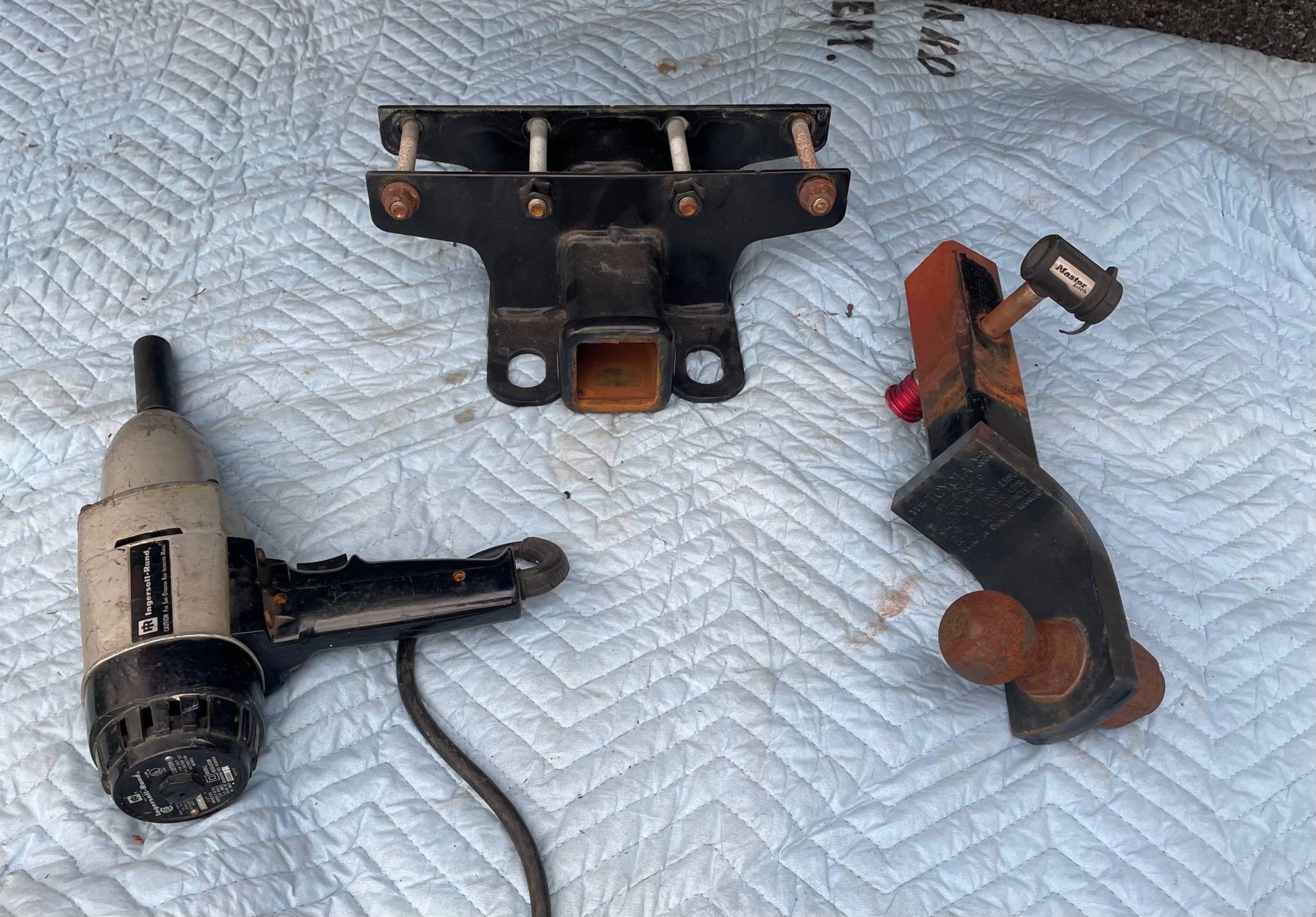

In a couple days I'll be trading in my 2019 JLU for a 2015. Besides all the aftermarket accessories that I have added over the years which I've take off, the Jeep Mopar trailer hitch tow package remains. That was added at the dealership when the 2019 was new. I pull a small Kendon motorcycle trailer on occasion and also use a solo motorcycle carries for my dual-sport/dirt bikes from time-to-time. But I want to take it off and put it on the new '25. With the exception of some pretty tough bolts to lose-up (rust and such) taking the four (4) bolts that hold the hitch on was pretty simple.
But I am unsure if the harness is just part of the Jeep and the dealers install the adapter at the hitch end or I should remove everything? Anyone install or de-install one of these factory trailer light harness's.
It is NOT aftermarket like Quadratec or other aftermarket vendor. It is Jeep/Mopar.
This (below) was easy enough to do:

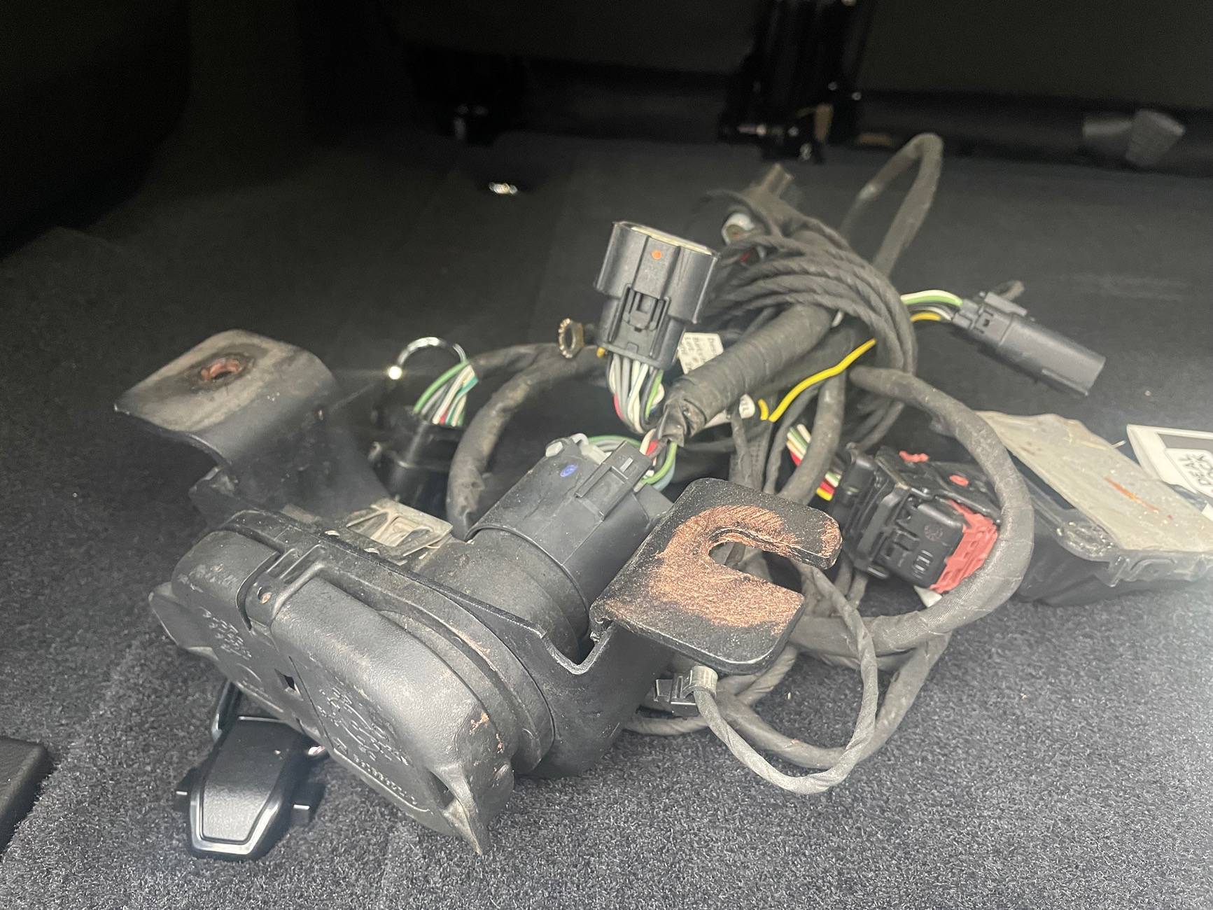

But there is no way I can thread this trailer hitch wiring adapter thru the underside of the Wrangler. There is a connector on the back but have not figured out how to detach it, yet?

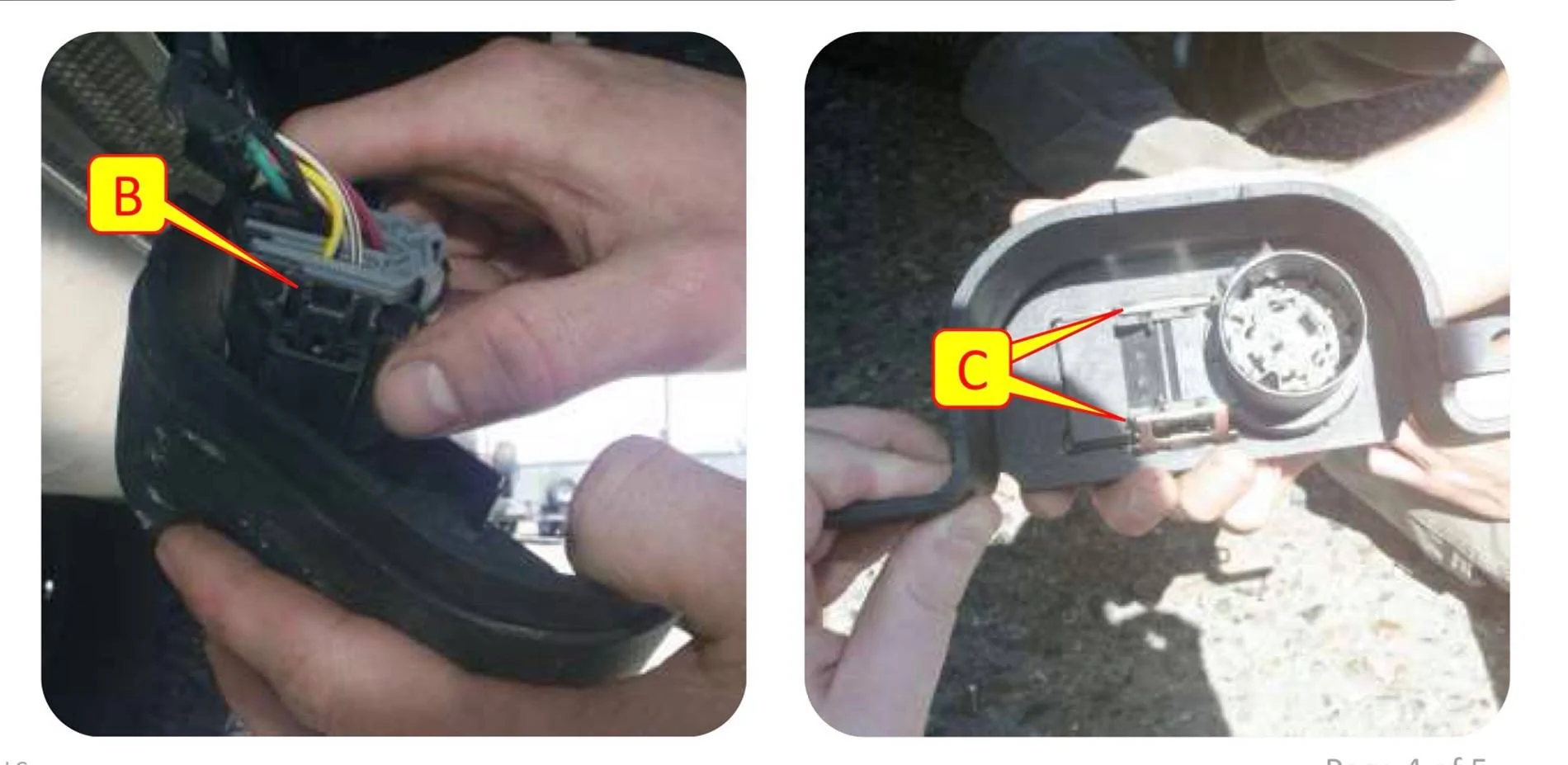

Are you asking how to remove the harness as in item B or the clips as in item C?
If B here’s an answer from @Rhinebeck01 in post#4
https://www.jlwranglerforums.com/fo...e-plug-on-a-7-pin-hitch-from-the-back.115874/

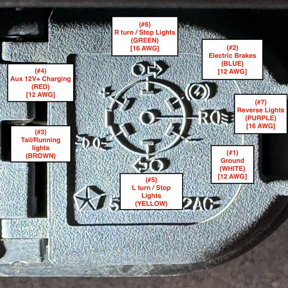

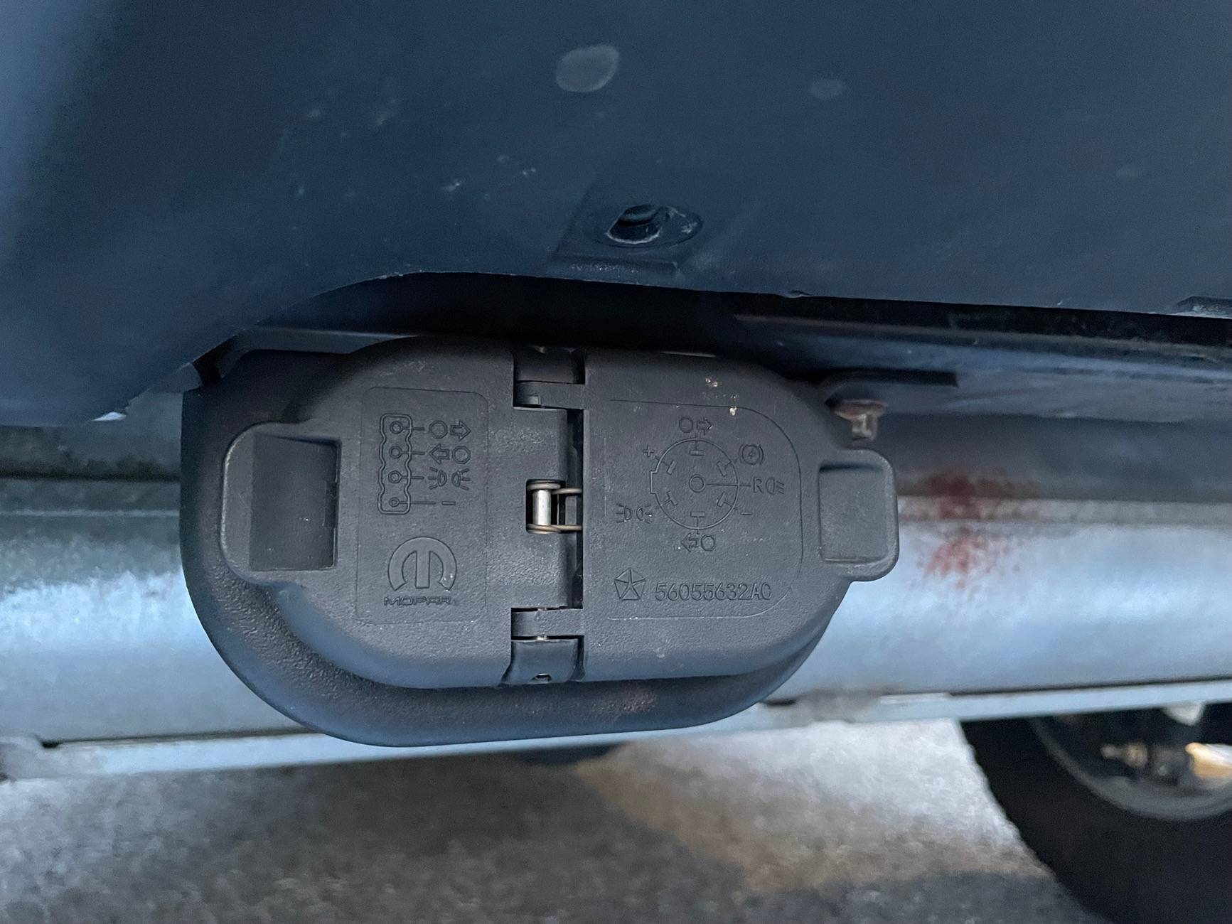

Just gonna leave this here...figure it might be helpful.
Was looking for something related, this is the Mopar 56055632AC on a 2021 JLUR.

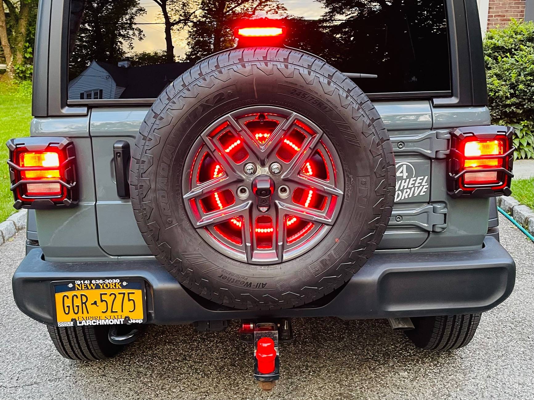

I did find out that the MOPAR harness is NOT part of the JL's. It was added by the dealer in 2019. It's a short harness to the inside hump on the passenger-side rear. The aftermarket harness's you see on Quadratec run from the rear all the way to the battery. So I'd suggest anyone installing... just buy the factory version and it plugs in nicely to the the factory harness.
It was difficult to take out because its original installation was done so well. But it also showed me how to re-install from the '19 to the '25. Took about an hour+. The factory hitch itself took about 20 minutes.
For those that don't mind spending a short time under their Jeep on their back, the Dealer wanted $700.00 just to move the harness only from the '19 to the "25. So ridiculous.
Jeep Wrangler JL Towing Wiring Harness IMG_0281
You can see the factory adapter connectors on this very short harness. Just a matter of weaving it a bit into the underside rear of the JL. No different than the way it was run on my '19 JL.
Jeep Wrangler JL Towing Wiring Harness IMG_0699
You can see it just to the left of the now swapped and installed hitch as well.
Good to go!
