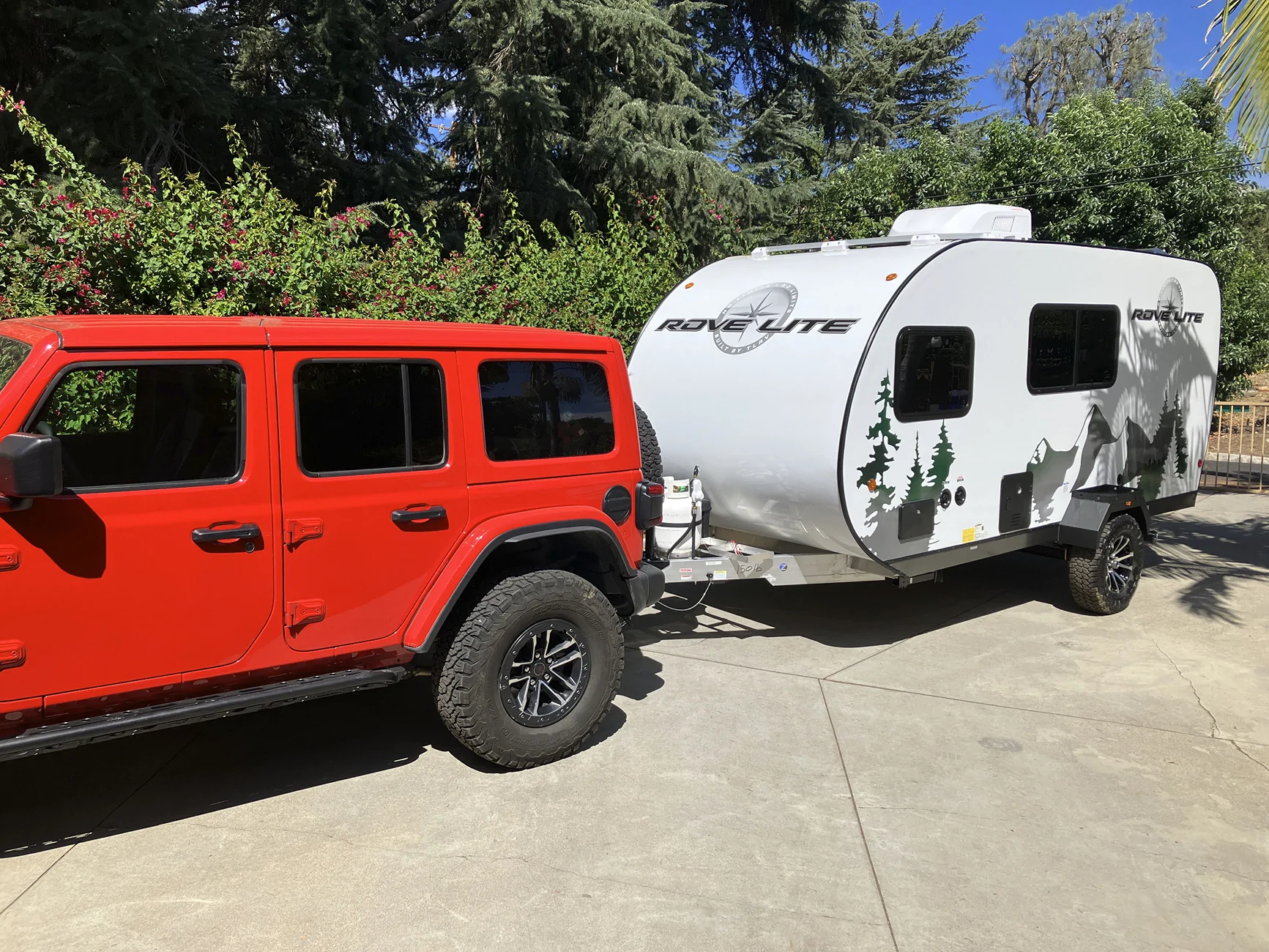

2.0T AT, 4.56 gears, 315 tires.
Trailer is 2491 lbs fully loaded with gear and water. Manufacturer claim UVW is 2020 lbs and trailer sticker dry weight is 2275 lbs so it is important not to base your weights from the listed figures, but from what the scales say.
No weight distribution hitch. No sway hitch (but trailer has Tucson sway control). Using mopar brake controller.
Tows very well. No sway even in strong side winds. Plenty of acceleration - 45 mpg to 85 mpg is pretty rapid for overtaking. Uses 8th gear 95% of the time. Main effect I feel is aero drag and I limit the speed to 60-65 mph. Fuel economy is 13 - 14 mpg, but then it is only 16.5 mpg without a trailer (but at higher speeds).
What I would change is getting the 2.5' longer trailer which has a north south bed (but is 600 lbs heavier). My conclusion is the weight is not as much of a factor as the aero drag. I do consider the rear final and what temps it must run on longer trips, so try to keep speeds down to keep the temps down.
I have a wireless backup camera but found it more of a pain that it was worth, so use the 'goal' approach. Get out and look.

Very nice setup. I was trying to determine if I’d need a WDH. I’ve read other posts where some swear by it. Hitch weight on the one I
am looking at is 230lbs.

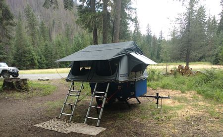

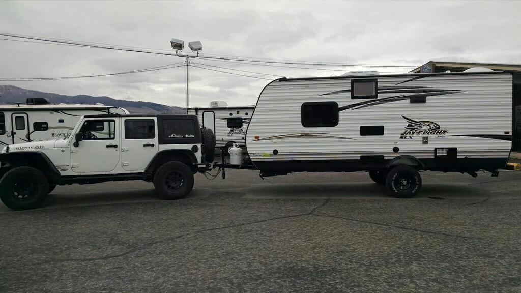

i have towed plenty with my previous JK's all with 3.6 and autos and 4.10 gears.....towed two different trailers from Montana to Moab and Colorado one being a small 1600 lbs RTT trailer and also a Aliner that was probably close to 3000lbs loaded....the smaller one never had trailer brakes and never had an issue with it...took that one to Colorado and to the Washington coast. The Aliner I took to Moab and all over Montana, idaho washington etc....that I had trailer brakes...I also towed a Jayco 195 baja RB with no issues but it was on the edge of being too big.....i would have no problem towing it with my JLUR tho....that all said I hate towing....I suck at backing up lol...and I started working on a farm when I was 12 and still suck at it.

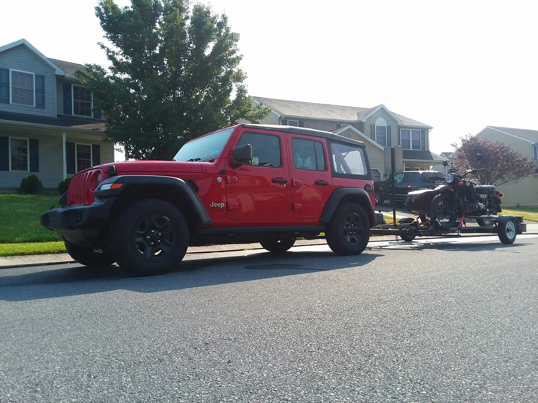

- Engine/transmission combo 2.0T/850RE
- Hitch used Curt 13392
- Brake controller N/A
- Remote or wired camera systems N/A
- Weight of your trailer ~600 lbs. unloaded; 1,400 lbs. loaded as pictured
- How well it tows said trailer Swimmingly
- How far you have gone All the way there and back
- Issues or things you would have done differently For my predetermined use case? Nothing really comes to mind. Everything works.

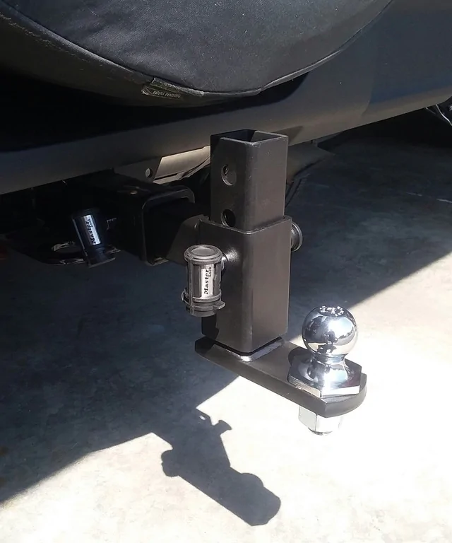

- Anything else you want to add. I do use an adjustable ball hitch so that the trailer is towed in a level config. I see too many rubes that are towing dangerously tilted trailers. Don't be like them.

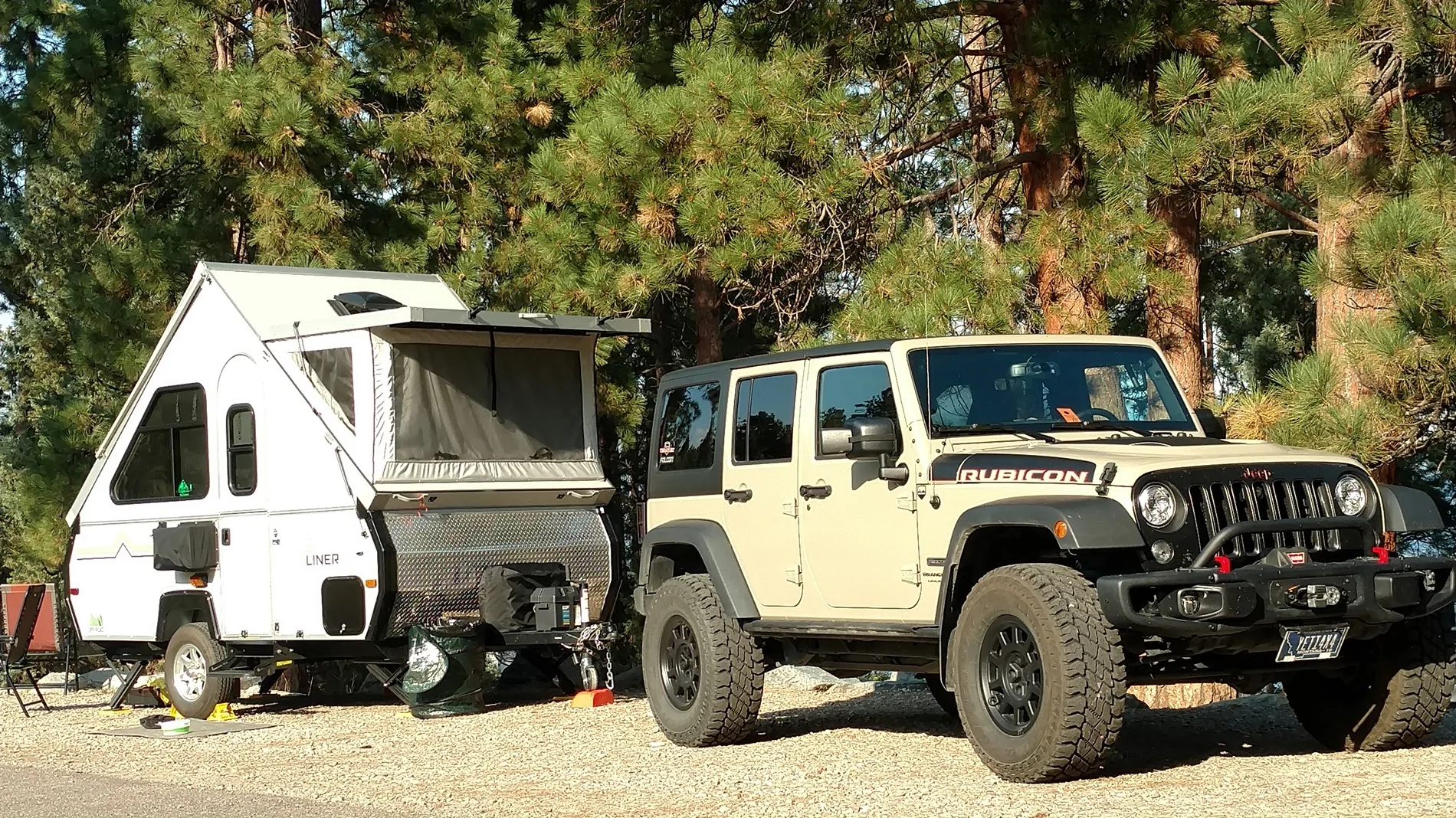

I have a JLUR with the 3.6 motor. I run 37 inch tires and the the Jeep has 5.13 gears. I have towed this E-Pro RK camper approx 54,000 miles.
Jeep Wrangler JL Tow Me About It (The Towing Thread) 1759083581207-yd
Jeep Wrangler JL Tow Me About It (The Towing Thread) 1759083720541-9
Jeep Wrangler JL Tow Me About It (The Towing Thread) 1759083900558-al
The Jeep pulled it well. It weighted about 2200 pounds. But the back of the Jeep was also stuffed full of gear.
That ^ camper does not have a bathroom or a shower. We did many long trips with the Jeep and camper with some of the trips being may multi-month trips.

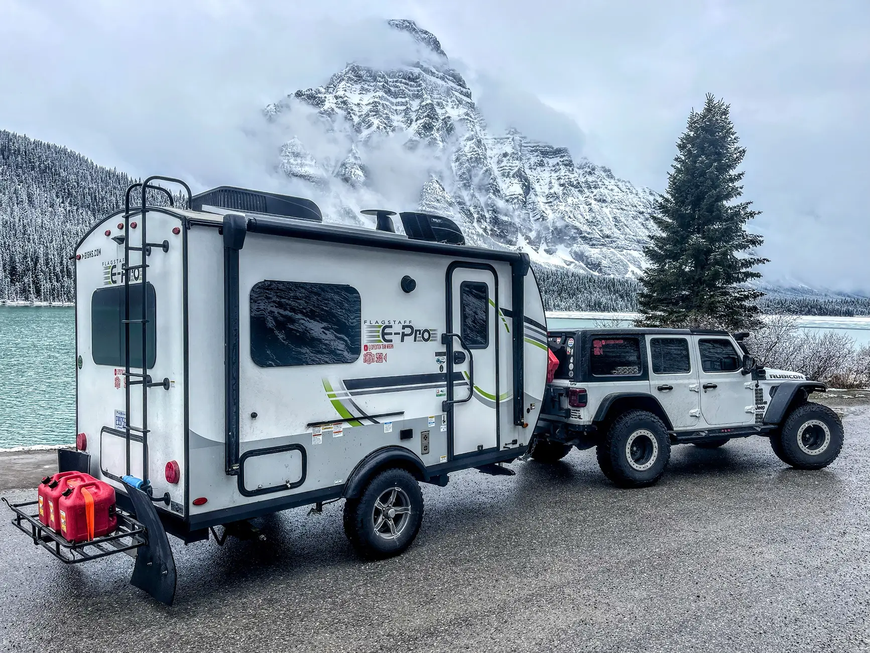

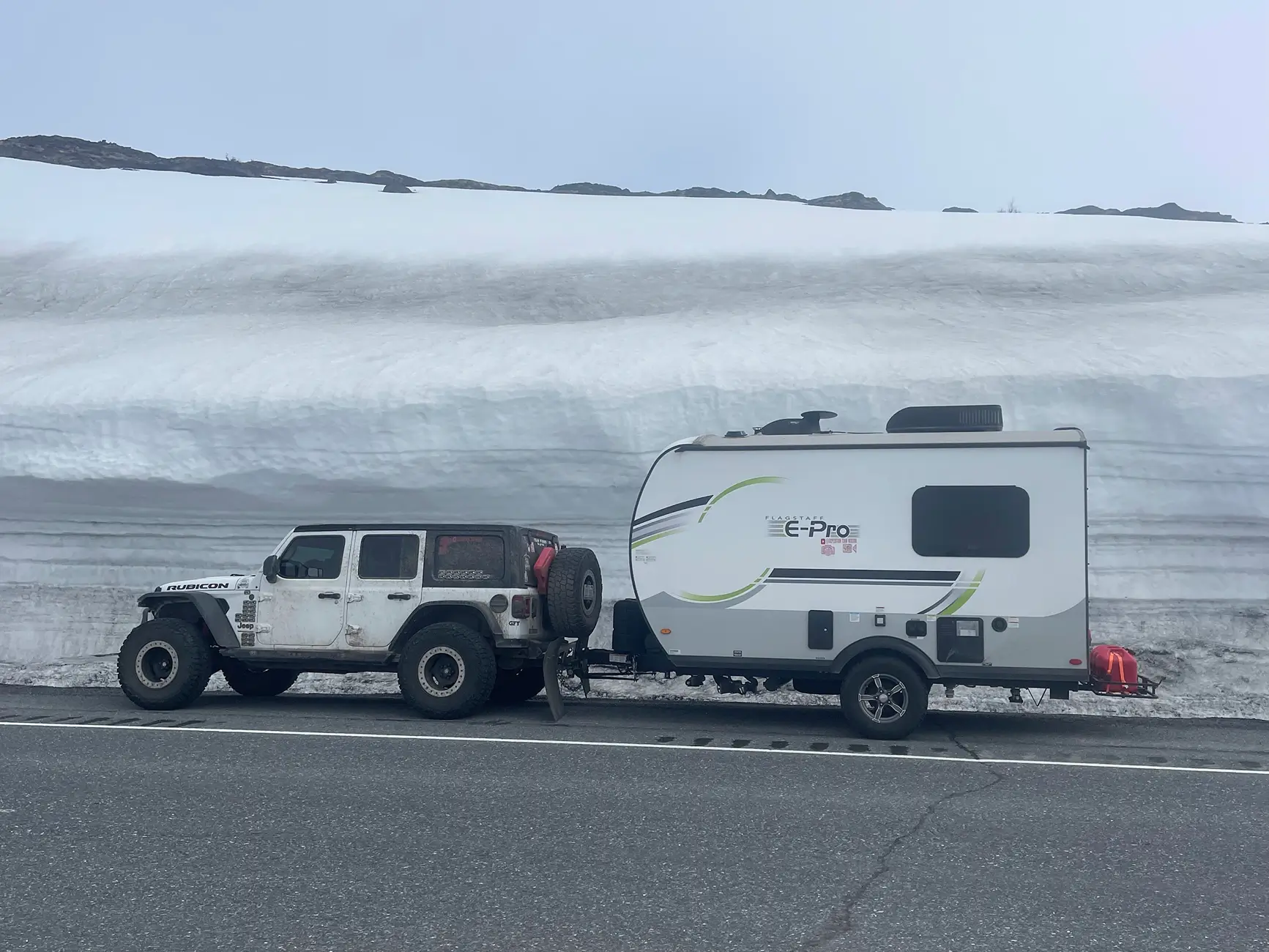

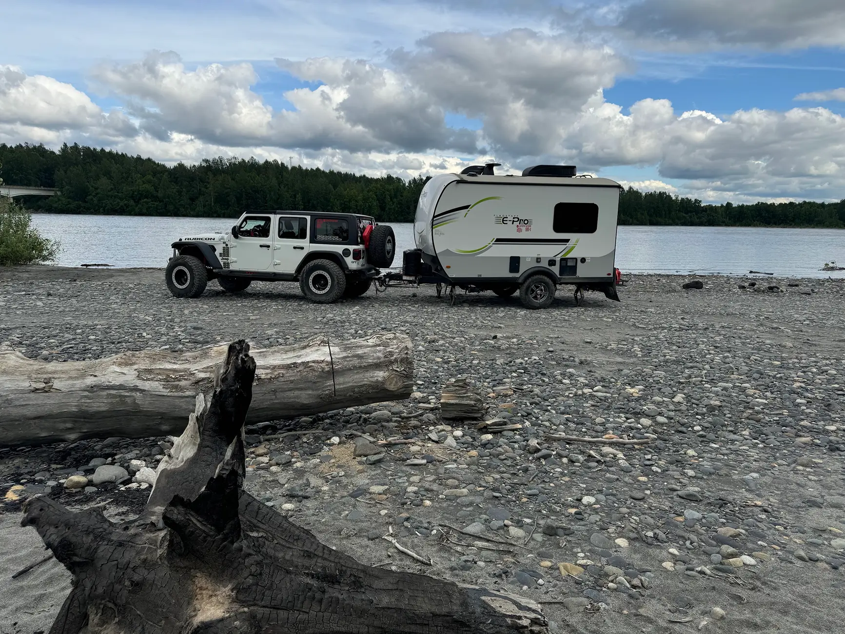

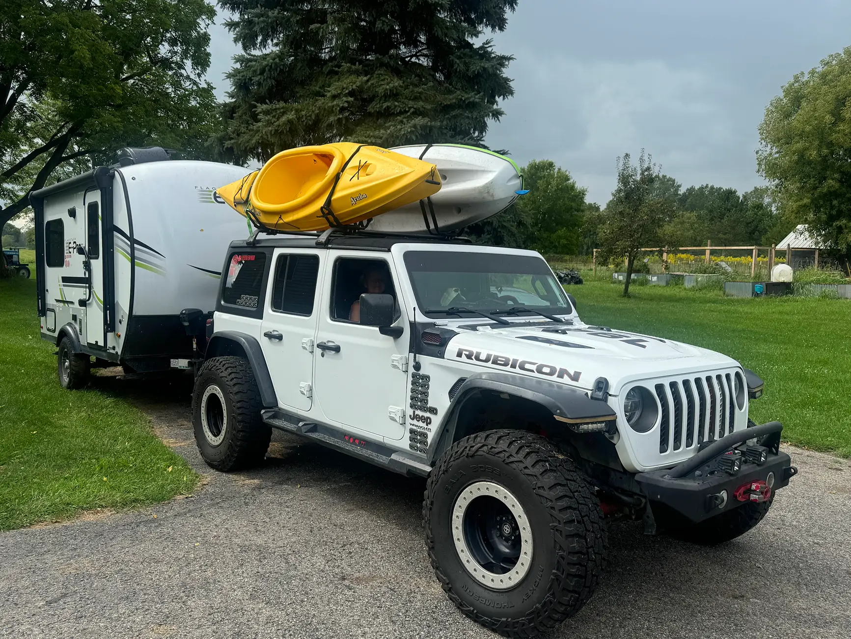

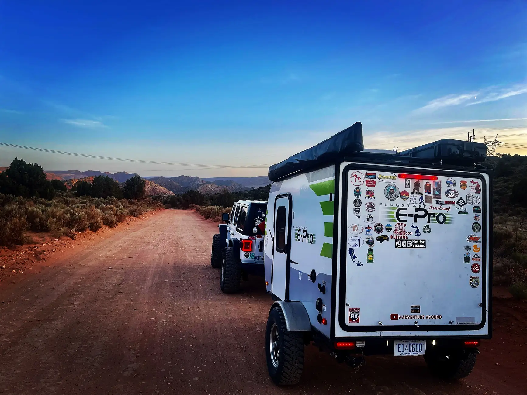

My wife really wanted a bigger camper. So we sold the 12RK and bought a E-PRO 15TB. The 15TB has a King size bed, kitchen and a bathroom/shower. We have towed this camper approximately 30,000 miles. The Jeep is set up the same, and tows it easily on everything, but long mountain passes. The passes are not really a big deal. I am usually able to hold 45 to 50 mph up most passes so it is only slowed down for a few minutes usually. Some of the really long passes like Monarch Pass in Colorado took about 15 minutes. Really not a big deal. I pull the 15TB between 65 and 70 mph normally. We have towed the camper from Michigan to Texas, Michigan to Alaska, and Michigan to Colorado and back to Michigan of course. Plus many many trip in and around Michigan.
The 15TB has an empty weight of 2700 pounds and the way I have it set up and loaded it runs usually between 3200 to 3300 pounds. I do use a weight distribution hitch. I have approximately 145,000 miles on the JLUR.
Jeep Wrangler JL Tow Me About It (The Towing Thread) 1759084779158-im
Jeep Wrangler JL Tow Me About It (The Towing Thread) 1759084819977-6x
Jeep Wrangler JL Tow Me About It (The Towing Thread) 1759084852279-70
Jeep Wrangler JL Tow Me About It (The Towing Thread) 1759084923797-ud

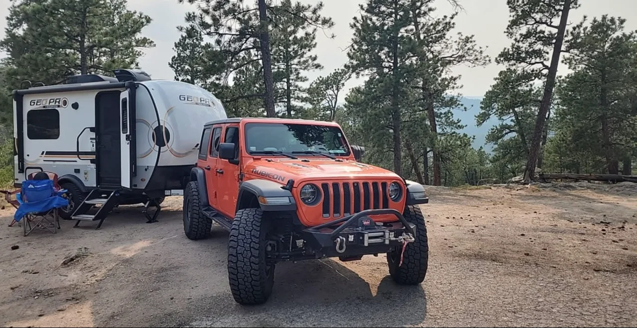

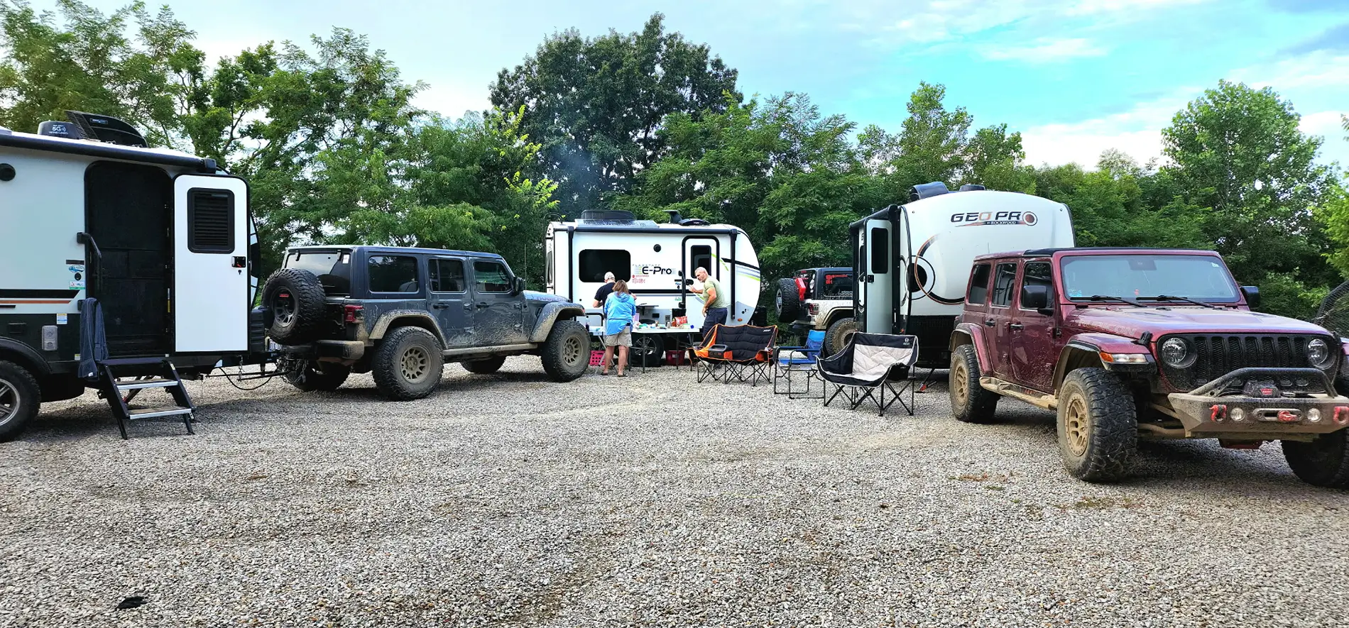

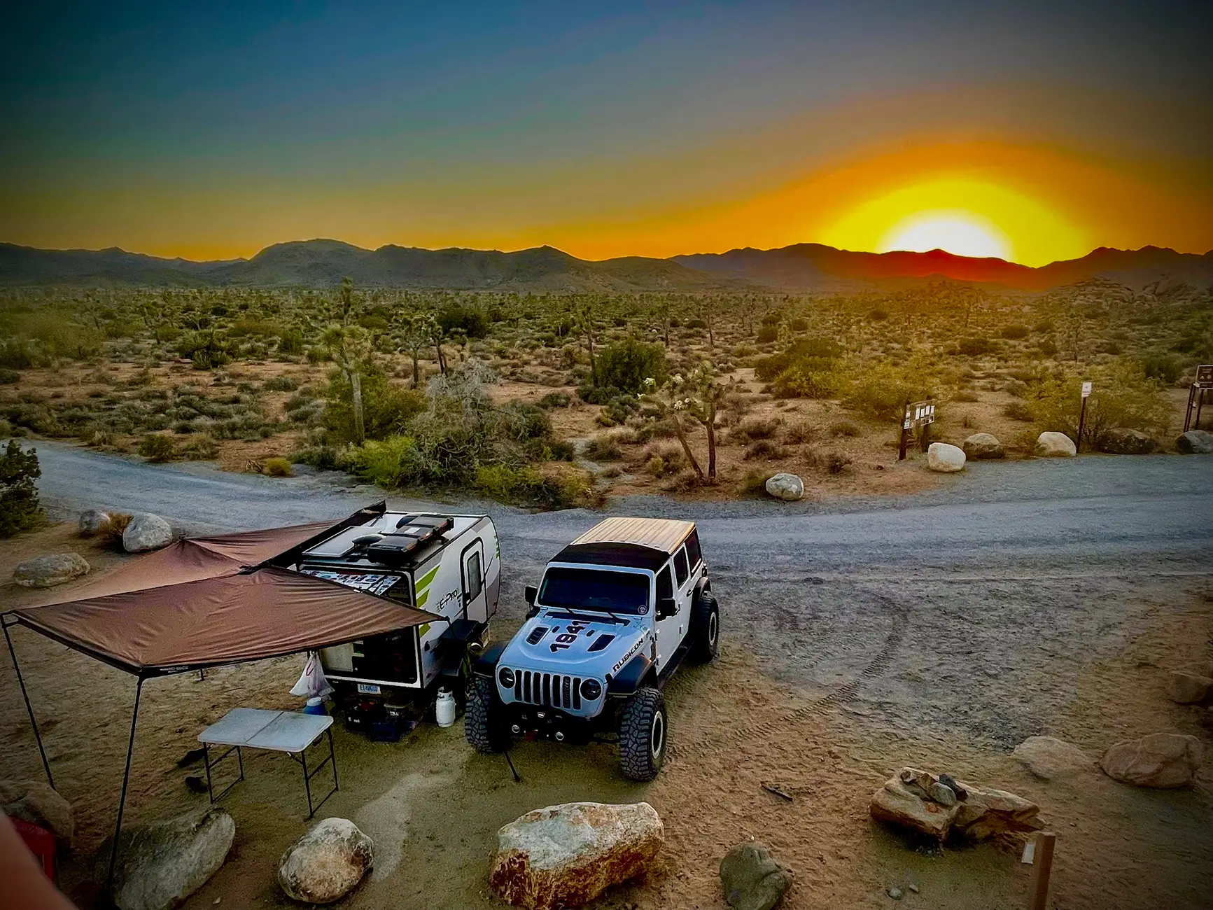

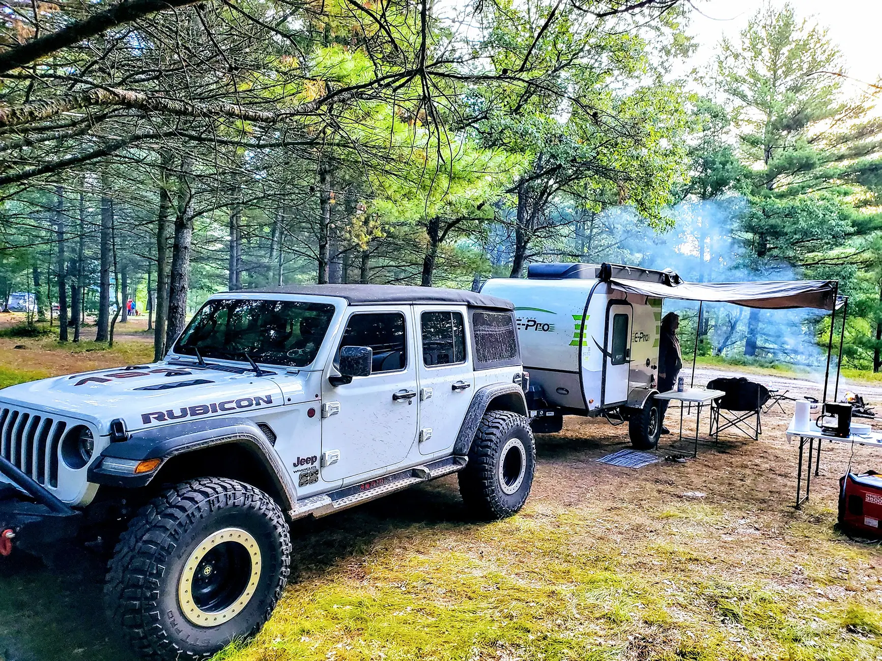

We pull the camper all over and set it up as a base camp and wheel and hike from the base camp. We might stay in an actual campground a couple nights a year. For instance when we went to Alaska for the summer of 24, we spent three separate nights in a campground. One for WIFI, one time to do laundry, and one just because.
There are four of us that haul the 15TB campers all over the country together at time. All of the JLURs are geared at 5.13 except the JLUR XR has 4.56 gears and 35 inch tires.
Jeep Wrangler JL Tow Me About It (The Towing Thread) 1759084738088-qq
Jeep Wrangler JL Tow Me About It (The Towing Thread) 1759085065815-kd
Flagstaff manufactures the the 15TB camper under the name of E-Pro. Geo Pro and Rockwood. Three of us have put in compost toilets and the campers are all set up for off grid camping. Solar power and we have added Lithium batteries and DC to DC chargers so we can charge the camper battery at 30 amps while driving with we need to. We hardly ever use the DC to DC chargers as the solar can easily keep up with our power demands. We have each modded the campers to our needs. I converted the King size bed to a queen and added a swing out table so we did not need to set up and take down the table each day. I also added an additional 2000 watt inverter so I can power the microwave off the batter. Between the 4 of us, I would guess that we have towed the 15TB campers over 65,000 combined miles with zero issues.

A lot of excellent information. This is exactly what I was looking for in trying to come up with a plan for what my family and I are looking to do!
