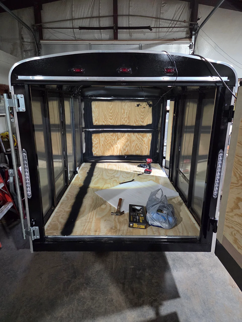

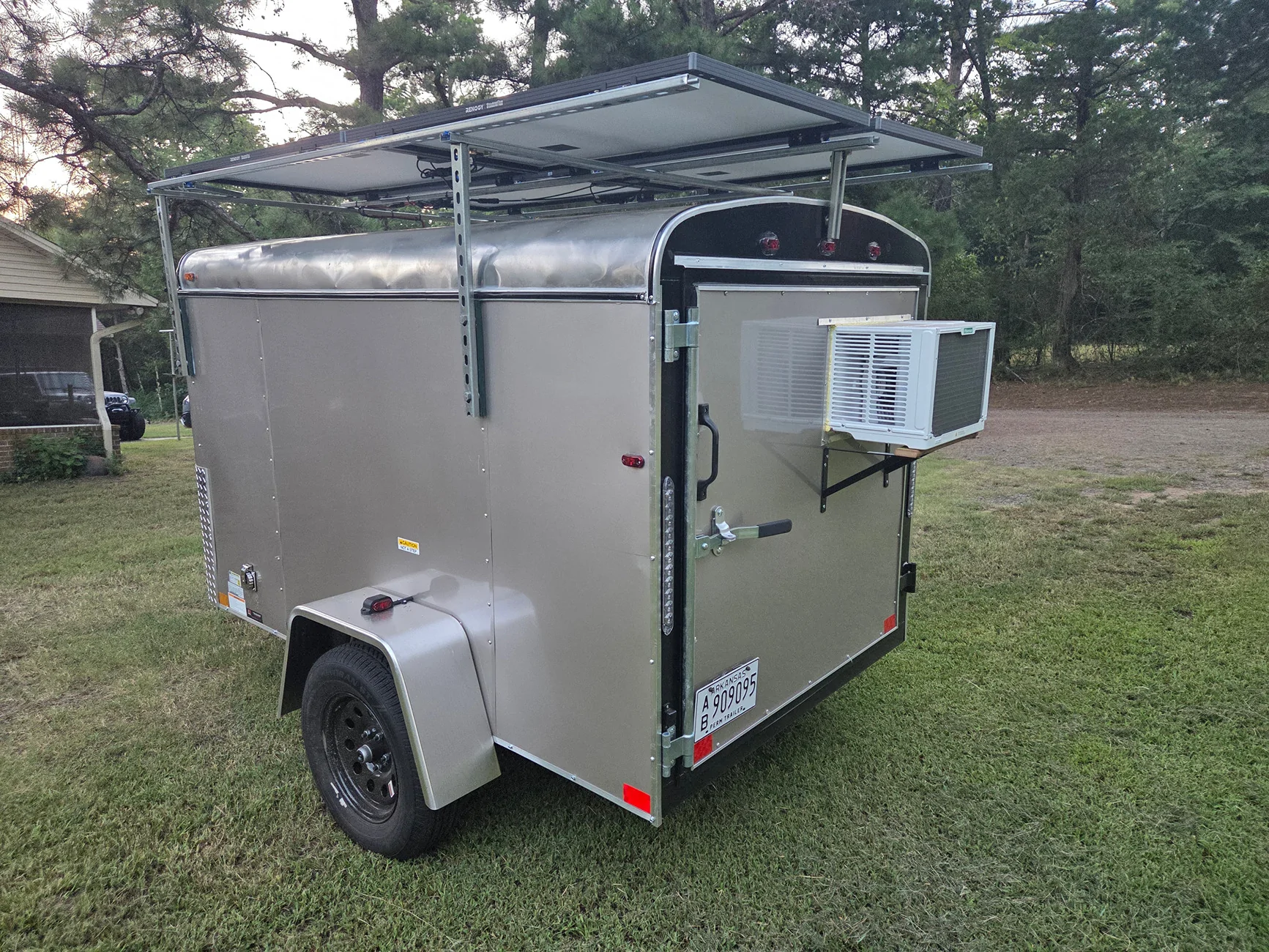

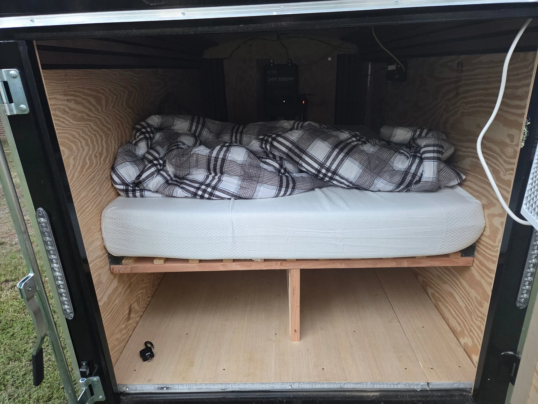

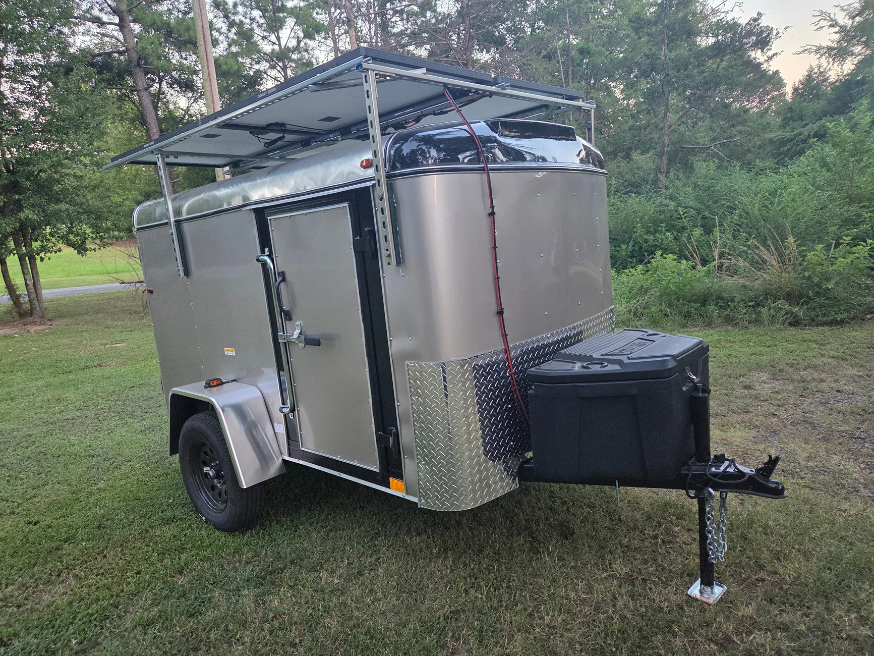

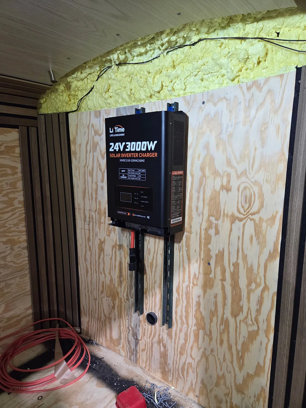

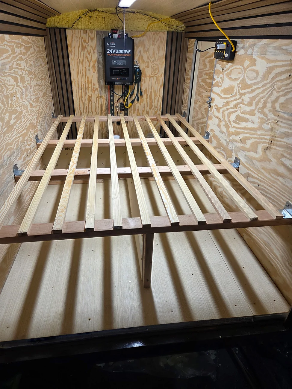

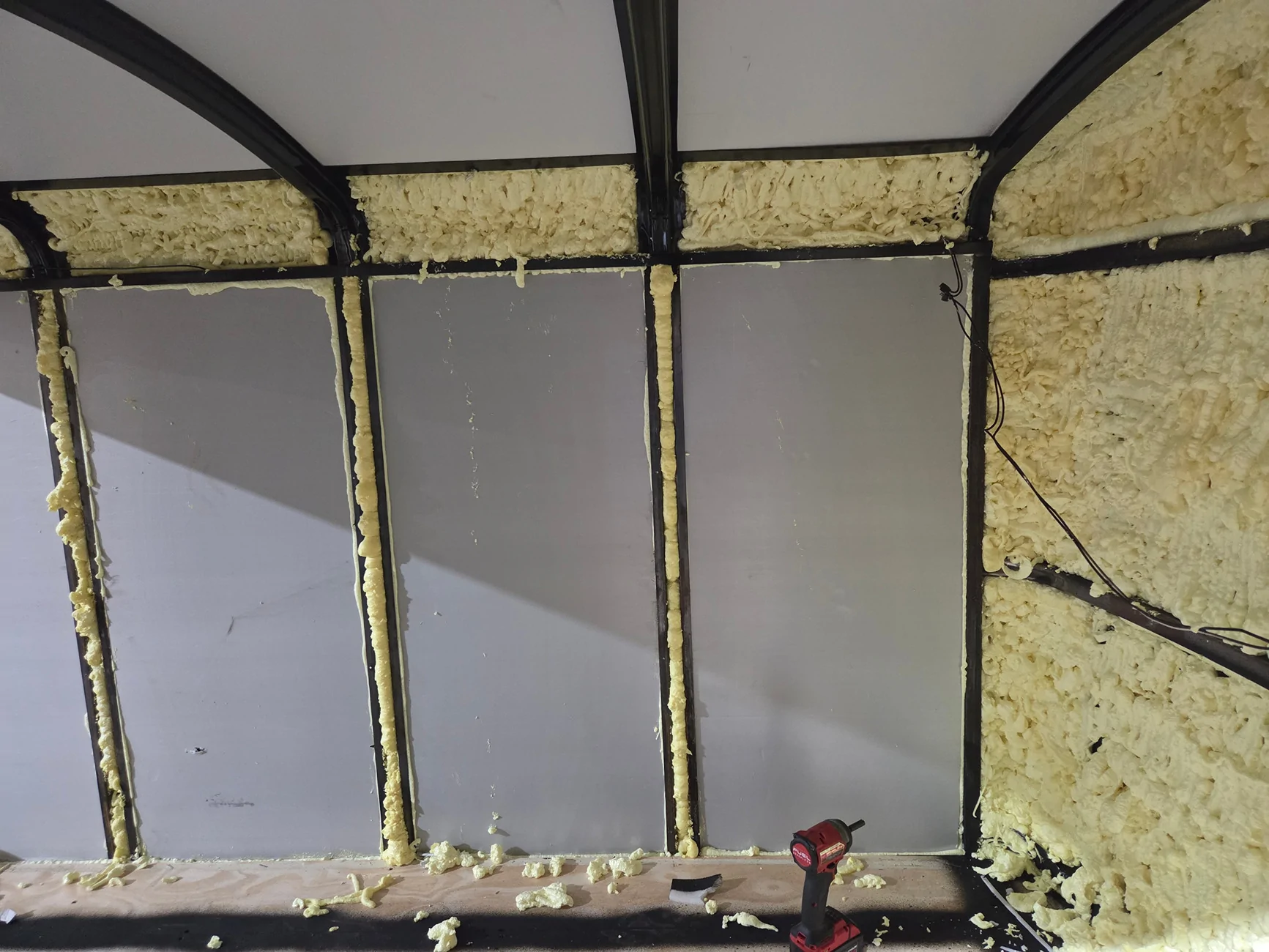

I'm using 4 200W Renogy panels feeding a Litime inverter/charger with 2 12V 300Ah Eco-Worthy batteries wired in series. I also have 4 100W folding panels from Harbor Freight that I can deploy if needed.
I can run the AC indefinitely at 78 degrees without plugging in to shore power. Or indefinitely at 68 degrees with the additional panels deployed.
Here's a few pics from the build.
Very nice setup! If the deal I’m looking at goes sideways tomorrow I may attempt something similar.
