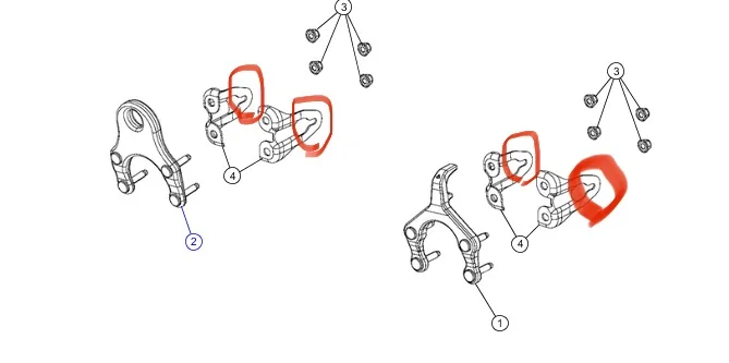

Does anyone know what bolt/nut go through the TOP of the tow hook reinforcement into the chassis as circled on the below pic?
I know the tow hook goes through the bottom but the top I believe goes into the chassis to provide lateral stability for the tow hook. Which bolt/nut fastens it there?
thanks

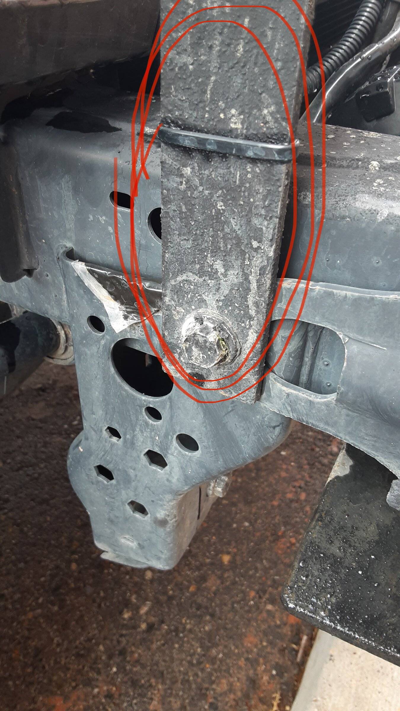

The reinforcement looks sandwiched by this part circled. Is that a standard part or aftermarket that goes OVER the reinforcement.
Sorry for the questions. UK owner here changing a bumper.
thanks for your help.
So that bottom bolt that you can see the head of in the red circle? It goes thru that reinforcement. The tow hook is to the right of the picture. That rectangular vertical part with the zip tie around it was added to mount fog lights. It's not stock.

1.25 inches long,
That one is a 10x150mm.

Last question I promise. I may be being stupid, but the pic shown doesn’t look 150mm in length (15cm / 5.9 inches).
is the pic of the same bolt?
many thanks
Sorry about that. I was thinking that seemed long this morning. I took my bolt out and gave it to a guy at a parts store to match-up. They didn't have a do it yourself thread gauge and I didn't process what he told me into inches. It's 1.25" long or about 30 to 35mm. I'd say a standard 30 would work since the factory ones have a lead-in section that's not threaded. A little longer shouldn't be a problem. There's room in there for more bolt.
