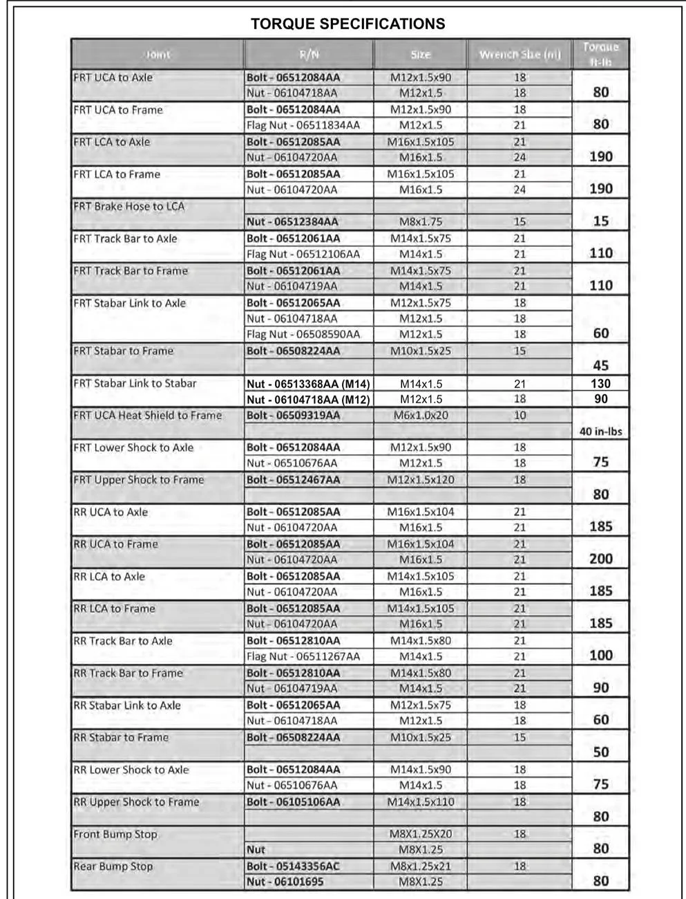

Has any seen a chart like this for the 2024 Jeep JLU Rubicon?

The ichart within the link to the instructions I posted shows different bolt sizes and torque specs for rear UCA to axle and frame. Assuming it’s accurate
if I ever get mine back I will pull a bolt and see.

200 ft/lbs seems crazy but never know.
That bolt is an M16-sized bolt, which is .6299", just slightly over 5/8ths. 200 ft-lbs is totally reasonable. If you aren't a gym rat and eat too many tacos, you might need a bigger torque wrench or a cheater bar, but it's reasonable.

I contacted AEV thru their portal and this is their response. I did ask why they don't update their instruction sheet and no response.
Case Subject: torq specs on 2024 JL's
Update Date: 10/24/2024 12:02:33 PM EST
Comments from AEV Tech Support:
Hello Jeff,
You should use the MOPAR torque specs when reassembling the rear control arms. 2018-2022 use a different torque rating than the 2023+ vehicles.

so are you sure about the size of the bolts. my front lowers are in fact 16mm but my rear control arm bolts are not 16mm they are 14mm. I just went to re-torq them to the higher spec but they did not look nearly as beefy as the fronts so I measured them and they are not 16mm but in fact only 14mm. I wonder when the change was made? mine is a jan of 24 build

so are you sure about the size of the bolts. my front lowers are in fact 16mm but my rear control arm bolts are not 16mm they are 14mm. I just went to re-torq them to the higher spec but they did not look nearly as beefy as the fronts so I measured them and they are not 16mm but in fact only 14mm. I wonder when the change was made? mine is a jan of 23 build 2024.
I just went off the torque sheet you posted. A 200 ft-lbs is reasonable for that size of a bolt. I have a 2022 so your bolt size may be different, or the sheet may be wrong.

My 2024 has 14mm not 16mm on rear control arms

I wouldn't go torquing the M14 bolts for the rear control arms to 185ft lbs. You'll be buying new bolts

I agree..I wonder why some 24's have 14mm (mine) and others 16mm at the rear?
