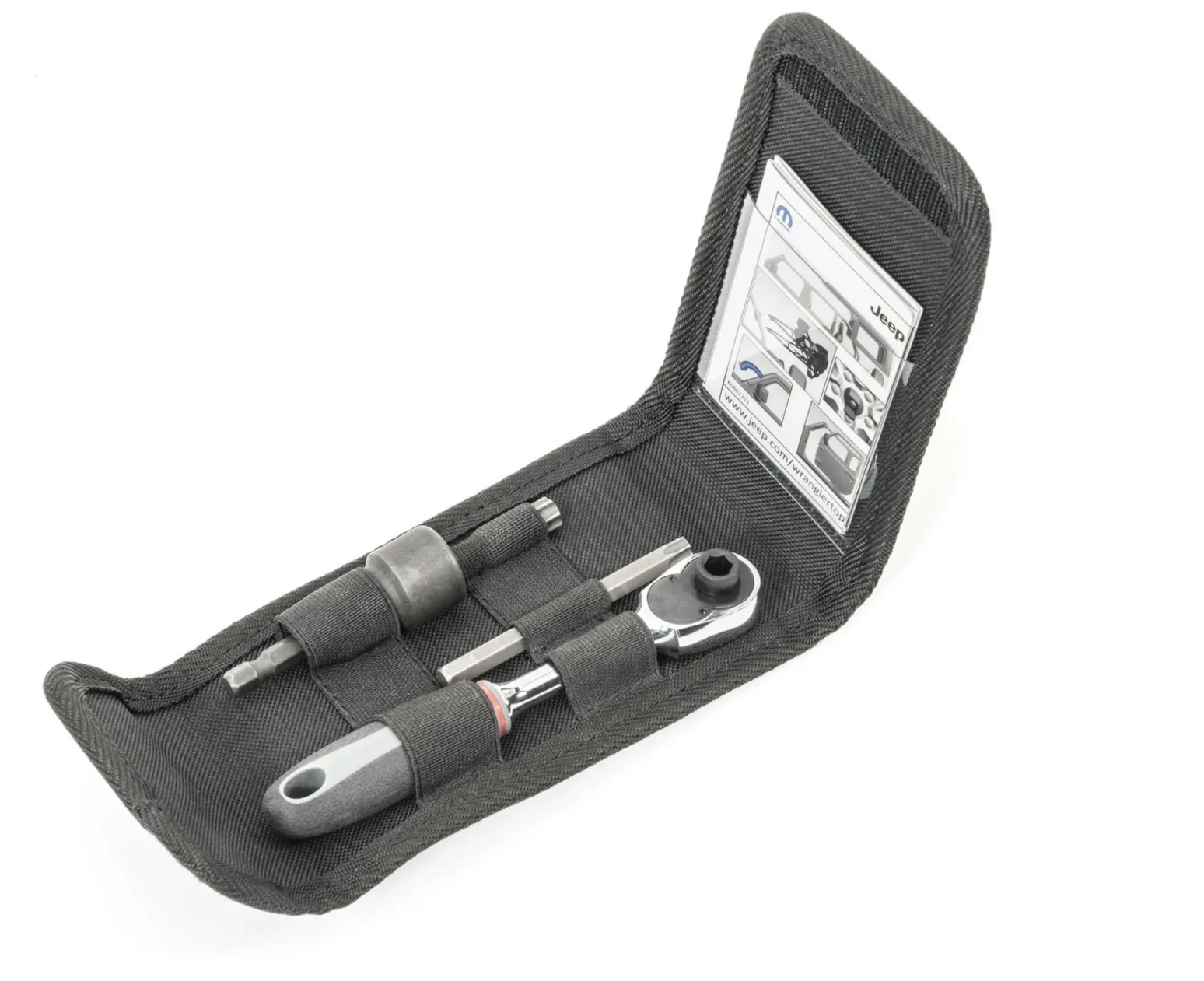

Does the tool kit that comes with the jeep able to remove the spare tire or is it just for the doors and hard top?

I suggest getting a 1/2" drive long ratchet or breaker bar and a six (not 12) point 22mm deep socket. The factory supplied lug wrench is crap.

Those are good too. Essentially a breaker bar.
To add to the topic. Make sure to avoid 12 point sockets as they are far more likely to round the edges of the stainless steel cover on the outside of the lug nut. Once it’s rounded off, you’ll have a hell of a time removing the lug nut.
And don’t get any of those crappy 4 way wrenches either. The wrench/socket end is no better than the factory lug wrench. And you can’t multiply leverage on one by stepping on it.

I’ve had to use my factory lug wrench twice and have had zero issues. It fits snug and removes the lugs, haven’t needed to stand on it or get extended leverage.
What issues have y’all encountered with the factory equipment?
