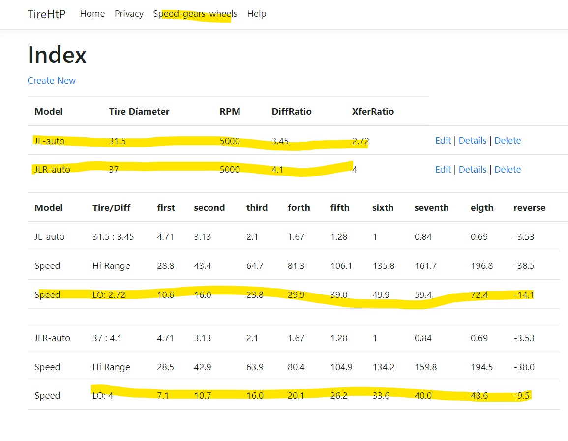

Just because you believe in the much cited myth you must regear like most doesn't make it true. My transmission temperate never gets hot. I posted a couple other folks with this combo. The 2.0 T does work better than the 3.6, I'll agree with that.
4.10s are only barely adequate for 35s.
Why don't you take a look at my bt39.com/GearWheelSpeed for factual comparisons. According to you, a non-Rubicon shouldn't even work with factory gears and tires.

It is simple math, done on my bt39.com/GearWheelSpeed?
A JLR with stock gears and 37's is geared almost identical to a JLS with 31.5" tires in high range. I don't care about hi range, my JLR is a dedicated crawler. But in low range a JLR on 37's is geared lower than the JLS.
All you're proving is that a JLR with stock gears on 37s is just as under geared as a JLS is on stock tires. So putting 37s on a Rubicon without regearing nullifies all of the gearing advantages that a Rubicon comes with from the factory.
You may be able to make that work on the trails you run but you're still under geared. You are just too obtuse to see it. Sorry.

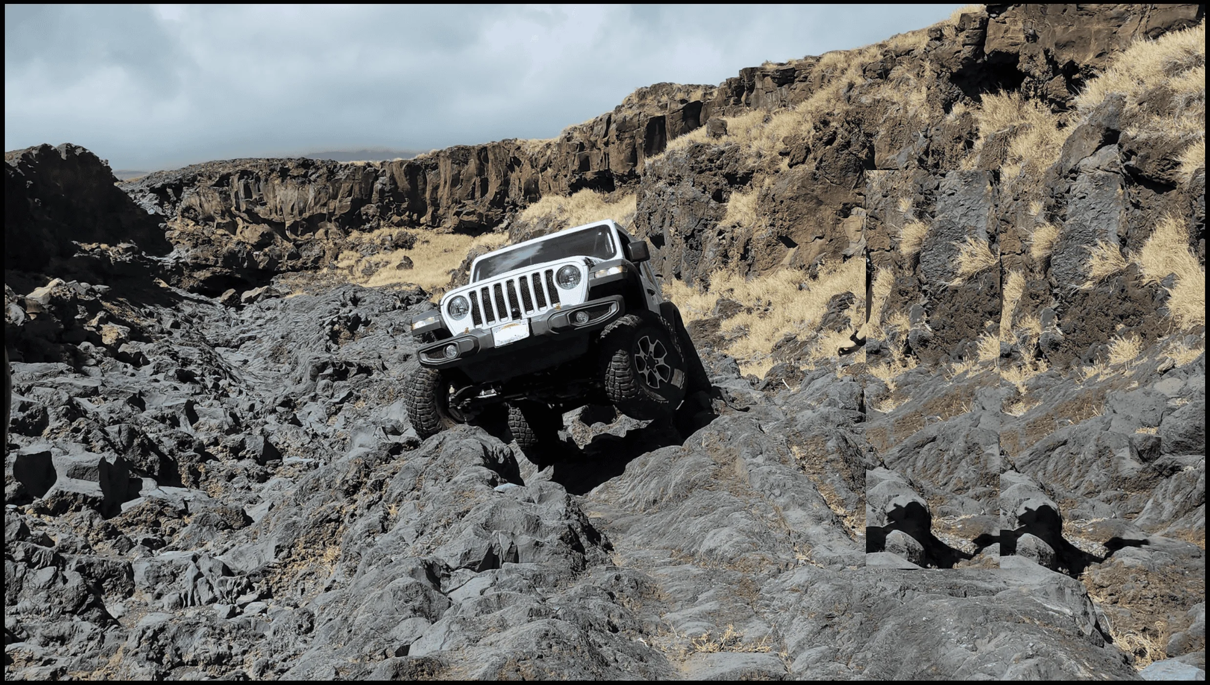

So going vertical isn't good enough for you? How about 36 degrees pitch?
LOL, climbs vertical in M2, AT never gets hot (I do M1). I'm not going to try to convince you as several of us know what works are aren't driven by interstate optimization driving.
Come follow me sometime and you can see for yourself.
