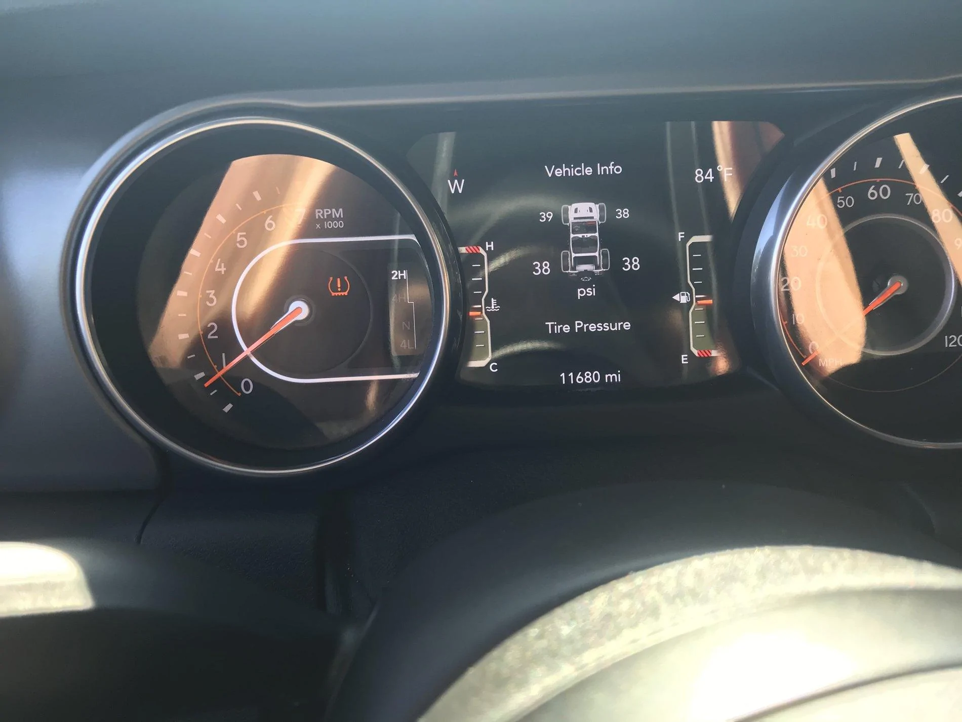

I’m running 36# with aftermarket sensors on 315/70R17’s and all pressures are reading but idiot light is on, local shop scanned all the sensors and they are reading but idiot light is like the demon in the closet and won’t go out, they advised the sensors may not be playing nice with whatever they send the signal to, Taser is in the mail and when it comes in my thought is to turn it off and then back on and see if it resets and will also lower the alarm limits down

Just an update in case someone else had the same situation as me (TPMS working but idiot is on). My issue was determined to be caused by the fact that I’m not running a spare tire with my aftermarket wheel/tire setup. When you program the aftermarket ones, after scanning all 4, it asks to scan the spare. Being that the JL has a self learn system, when it doesn’t see the spare it throws on the idiot light. Dealership said there is no way to change the configuration to only look for the 4 tires, thus I either leave the system on and deal with the light or just use my Tazer and shut if off. Hope this helps others with the same issue.

This is absolutely false info and sad it came from a dealer. The spare has nothing to do with it. The spare does have a TPMS that is asleep as it is not spinning. Until it gets put in the rotation then the TPMS will pick it up. When you move the and are trying to reset your TPMS it is a good idea to leave the spare off, go drive around and get the sensors all oriented and reading. Then you can go put the spare back on. If you drive around without a spare it makes ZERO difference as the system doesn’t even recognize the spare as it is not rotating. The TPMS machine has an option when you are scanning TPMS for four or five but that is to just check them and has nothing to do with the light etc.

So what do you suggest I do to correct the issue? All of the sensors still read just fine, I just can’t get that damn light to go off.

Well here is your situation and I have the same. The TPMS is not strong enough of a signal to turn the light off but it is capturing 'occasionally" the PSI. That is why the PSI is accurate but the system thinks your TPMS is bad because it isn't getting the signal on every tire rotation.
The only solution to this so far and it is hit or miss. The OEM TPMS sensors Schrader 20398 or (if you have a 2020 with Fill Alert then 29117) are your best bet. Any other brand is hit or miss. The problem is with Jeep and its receiver being too weak when you lift or put thicker ply tires on your Jeep. Obviously they won't fix the issue when you go away from stock so I am not hopeful it will even get resolved but it does seem they know there is an issue because we are not seeing the same problems with the 20 JL's only the 18 and 19's.
Of course also a programmer to turn it off will work as well.
