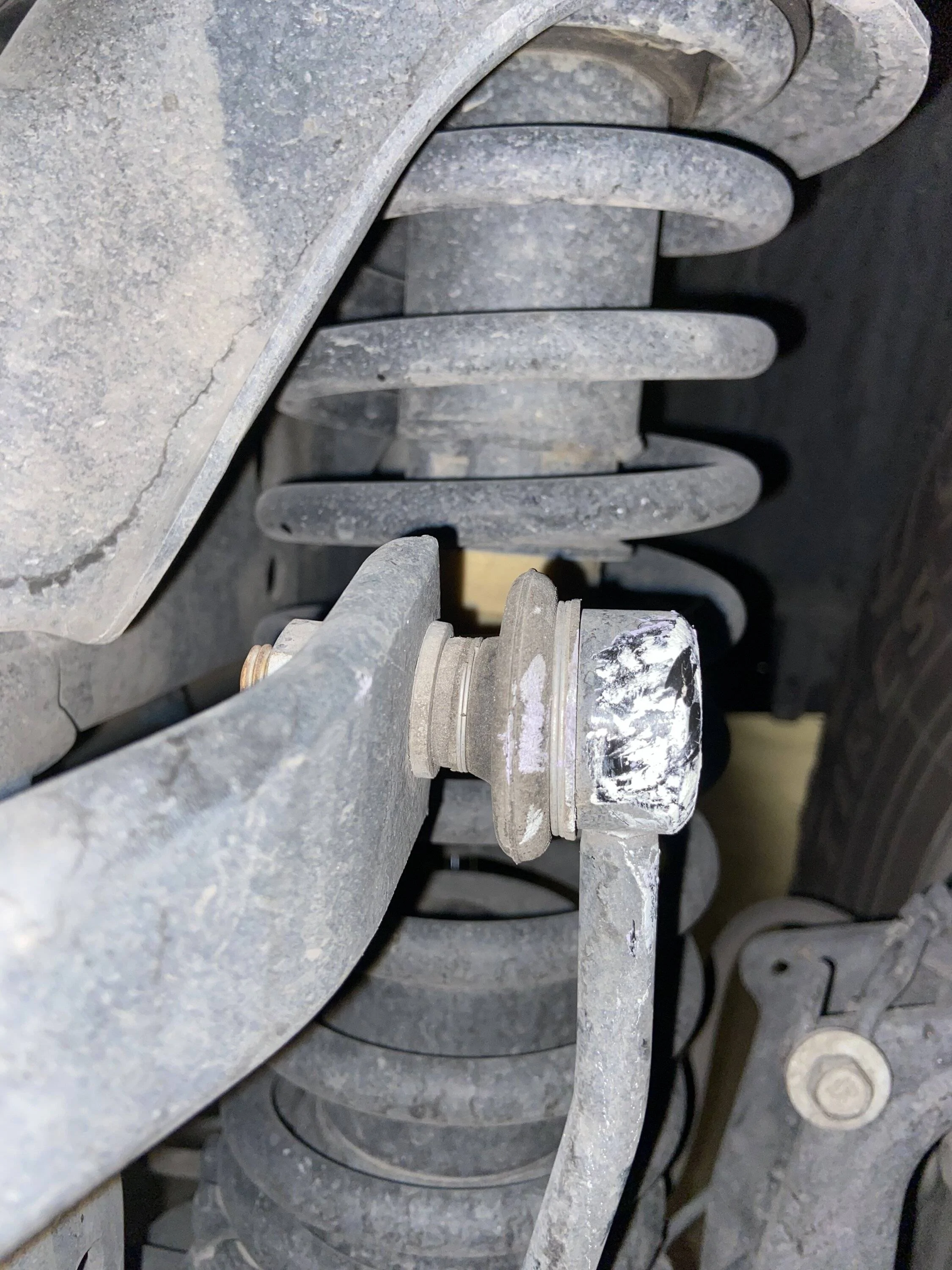

Random question. Are there any Swaybar links that are thinner that the OEM links? With my Dynatrac 2” lift it moved the rear links up front. I get a small amount or rubbing at full turn and I’ve already put 3 washers on the steering stops. I know I should get new rims but thought Swaybar links would be cheaper.

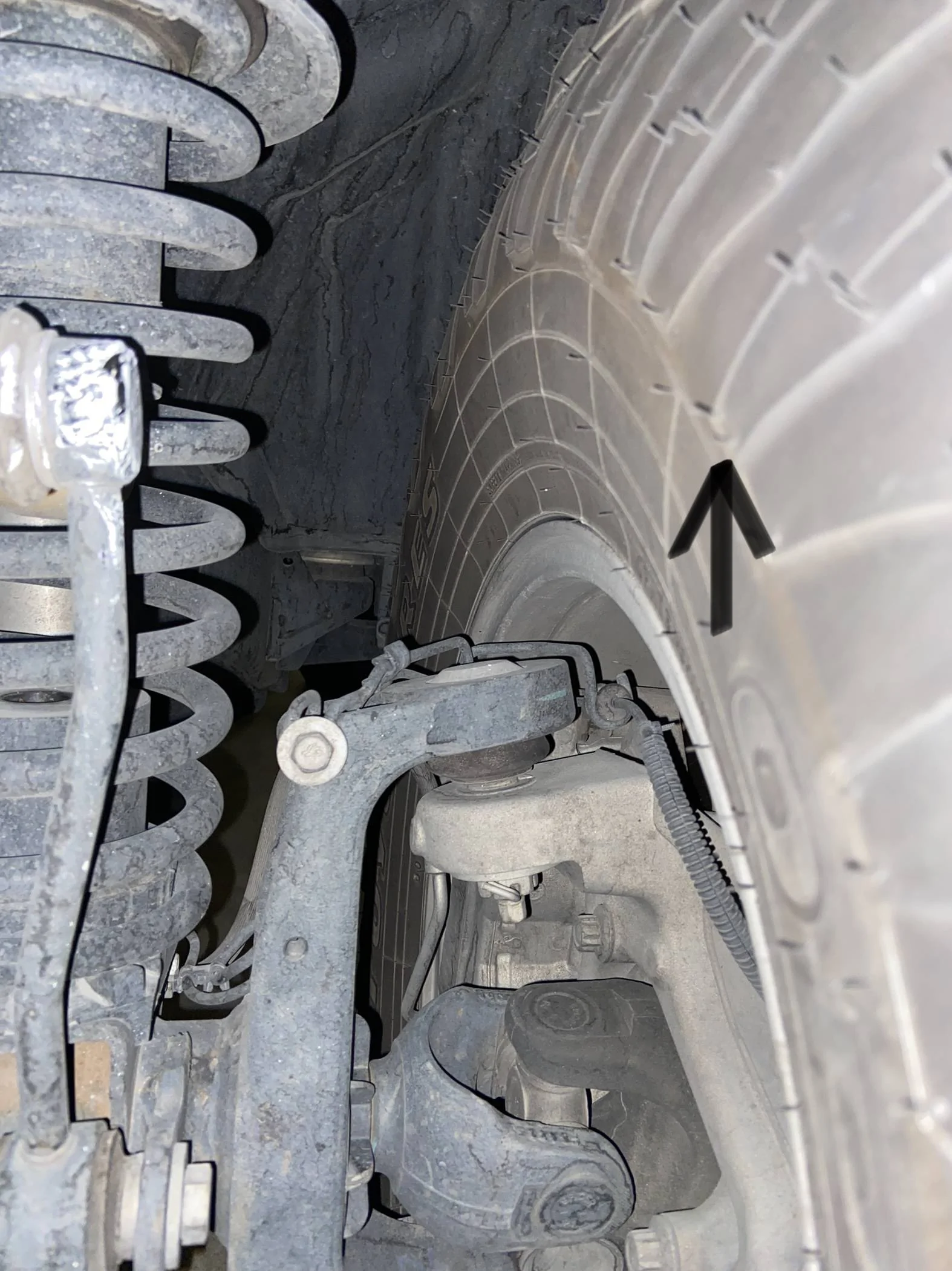

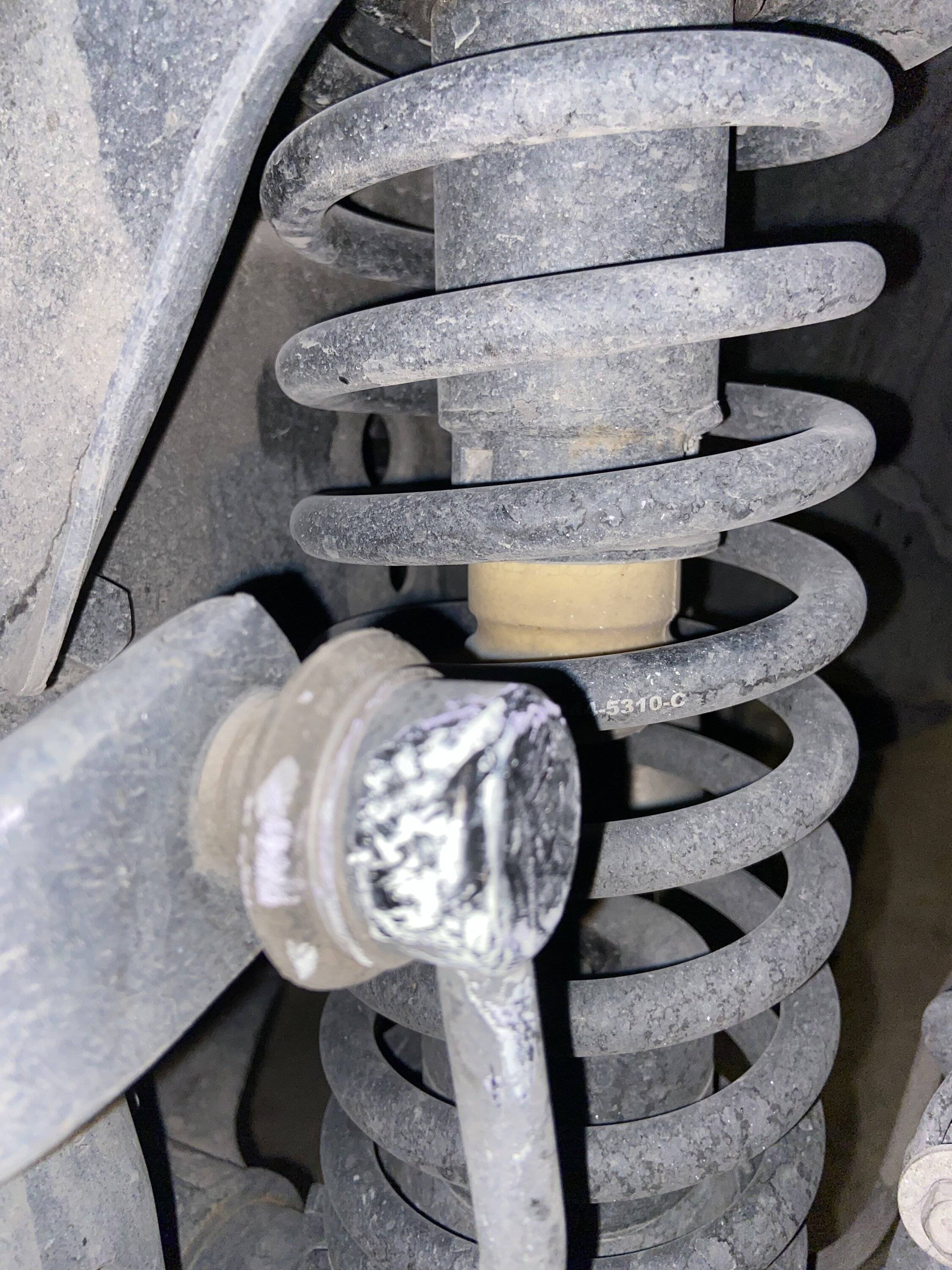

Sorry for the bad quality trying to do Jeep things and get ready for work to pay for Jeep things.
i put chalk of the end link so I could see where it rubbed and on the tire it’s approximately where the arrow is pointing.

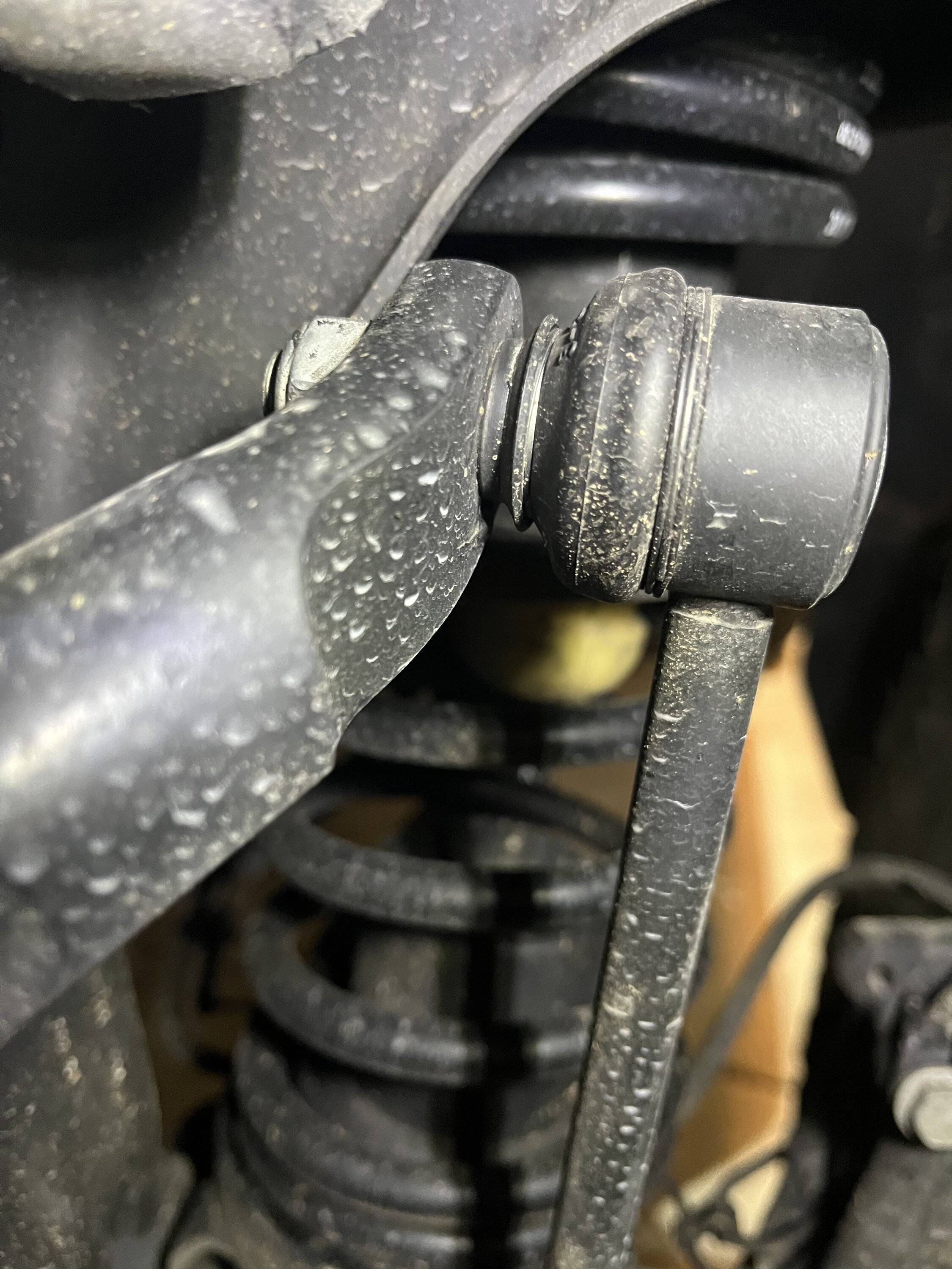

Is there an extra washer between the link and sway bar? The second pic is looks like it is sticking out quite a bit. Maybe it’s correct, just appears to be pushed out a bit. Here is mine from my TeraFlex lift:
I’ll check that. It does seem like there is tons of space in my second pic. Those TeraFlex looks like they are 1/4” to 1/2” closer in that area.
Maybe that’s the problem of moving the rear links to the front in a lift kit and I need links designed for the front.
What size tires? Factory rims?

I am running 35x11.5x17 Toyo AT3’s on stock rims and have zero rubbing issues on 2.5” TeraFlex base lift.
This makes me think I should get some new end links. It looks like that lift comes with new links for the front and the rear.

Yeah if you can get some new endlinks that would solve the problem and is cost effective.
