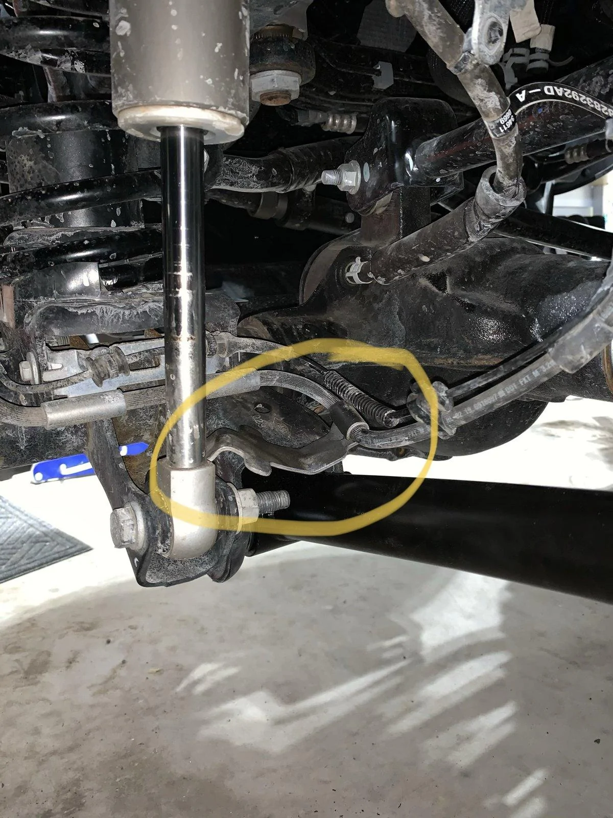

I just installed Teraflex lower fixed length control arms on my 2019 Sahara JLU. The new control arms do not have a bolt to mount the bracket that attaches to the brake lines. Any ideas on what to do with the bracket that is attached to the brake line still?

+1 to carefully pry it open without damaging/pinching the brake line.
Try getting two sets of vice grips. One on the big plate to hold it steady, and the other strategically placed so it "un-rolls" the existing section that curves around the line.

That’s a great idea. Thank you!

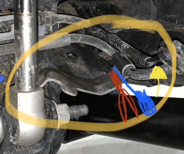

Horrible markups on this picture, but hears what worked for me. Use vice grips to hold the bracket, and placed close enough to the ‘rolled edge’ to allow a flat head to slide in between it and the roll, but also wedge it under/against the roll. I can then stick the screw driver in as far as I can, use the point of the screw driver as the fulcrum point, and lift up on the handle, the shaft of the screw driver will force the rolled edge open as I lift the handle up.
Took a while to figure out side one. Side two took 30 seconds.

Horrible? It’s a work of art! I totally get it, will try today, thank you!
