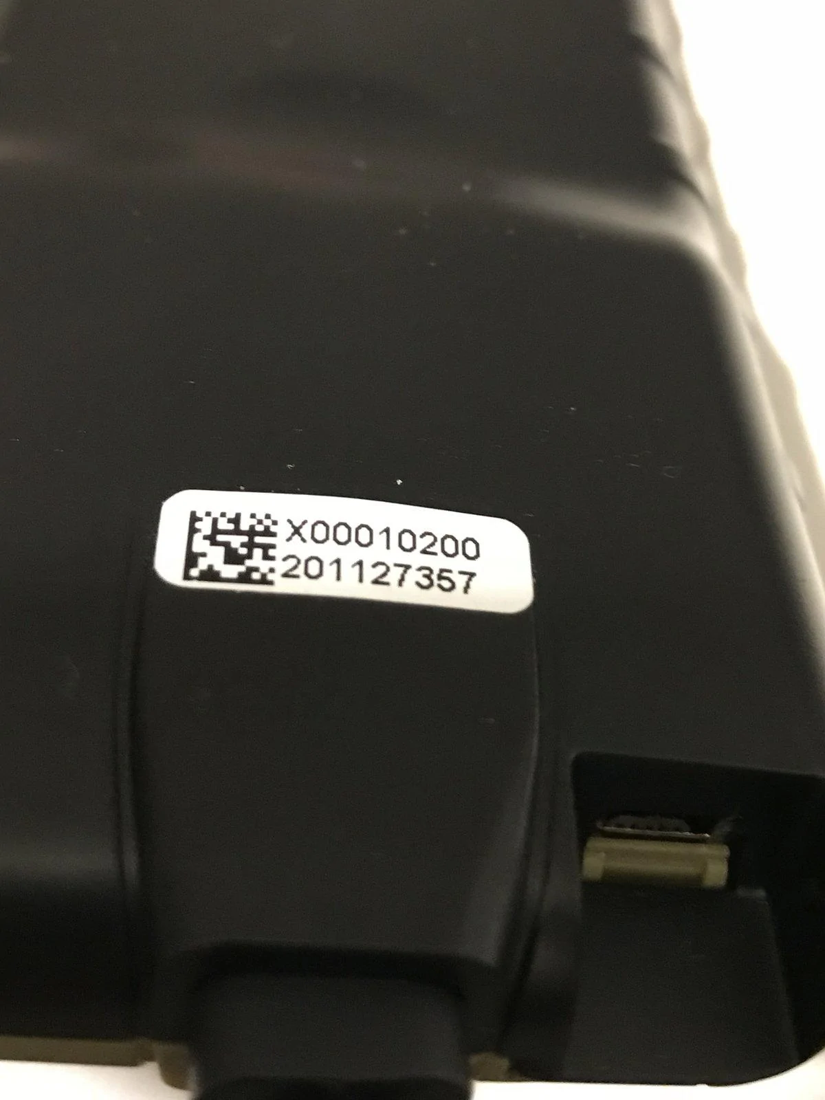

Here's the serial off mine. It's already been updated once via a targeted update sent to my Ignition software.
Yes, my JL is a Sport Unlimited S package with the 7" UConnect system.
Jeep Wrangler JL Tazer vs Flashcal vs other JL programmers FlashCalSerial
OK, we have targeted your device for a new update that will change the auto park disable to a one time use feature.
You can disable it and it will be gone for that run/key cycle.
Next time you shut the vehicle off it will reenabel itself, but should allow you to do what you need with the door open.
You'll also find quite a few new options and functions that have been added :)
Let me know if you have any feedback!
